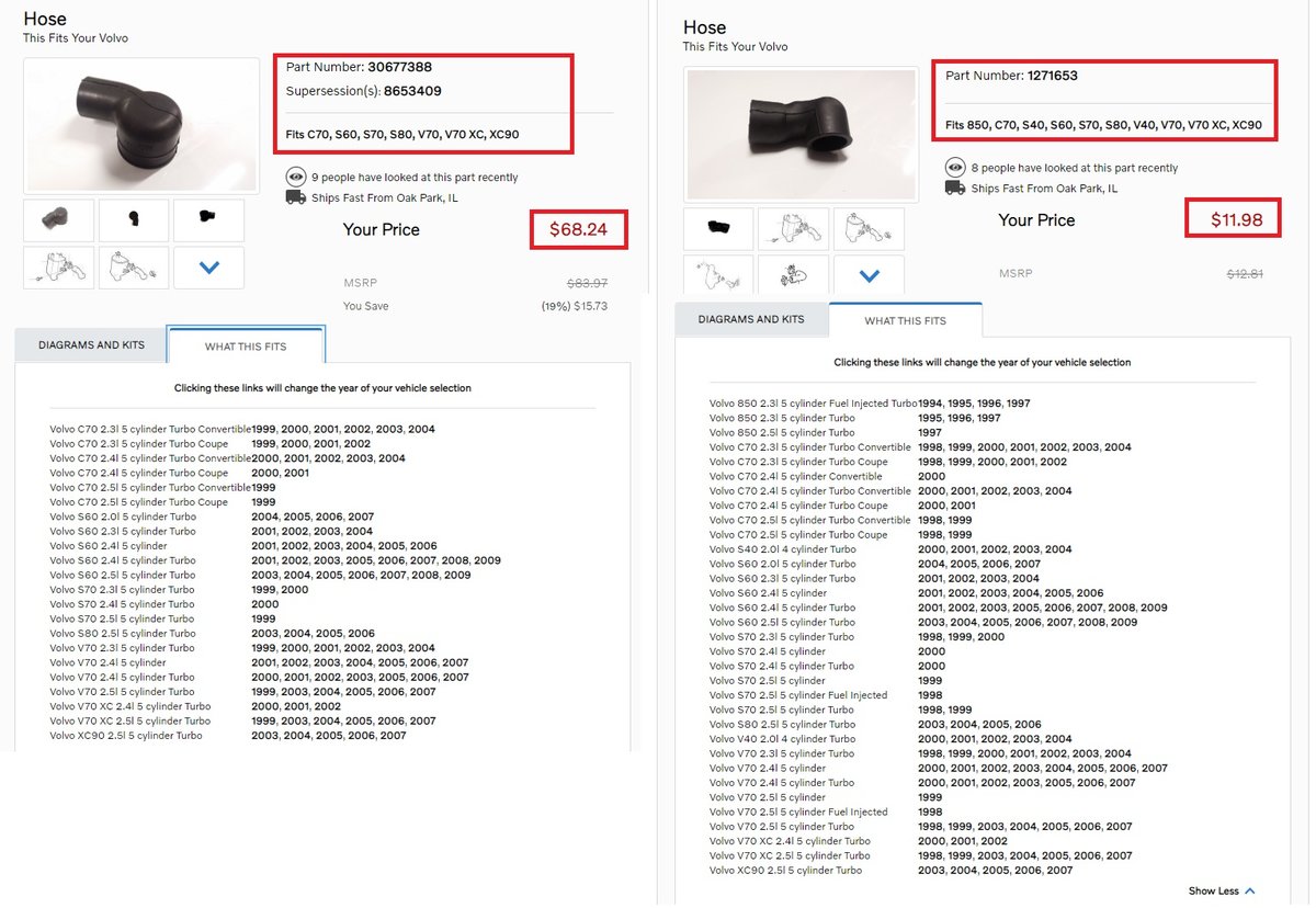

PCV Elbow (at Oil Trap) is the issue:
- According to different websites, for engine # up to 3138170, use the inexpensive 1271653 ($12).
- For engine # from 3138171, use the expensive 30677388 ($68).
I cannot believe this little elbow is $68!!!
Browsing some dealer websites, both PNs are listed as interchangeable for most 2.5T engines.
It looks like I can use the inexpensive 1271653 ($12) for my 2004 V70.
Anyone who has gone through this before, please advise!

From reading randomly, it seems that the difference in these 2 elbows is in the diameters on the engine block side of the elbow, which is about 2-3mm. I am guessing one can use the "cheap" $12 and push it in.

The diameter difference is much larger than that. You can't possibly use the wrong one. The small one fits with a sizeable margin inside the large one.
My -04 made in April of 03 used the small one.

Mystery solved, I went to local dealer and physically look at both elbows.
My advice is that...get a flashlight and look down the tight space between manifold crevice to figure out what you have before ordering.
Anyway, here are the dimensions at oil trap and at engine block, I measured these myself using a caliper...
- The Volvo 850, 1998 S70 $12 elbow: 25 mm and 25 mm.
- The later version 30677388, based on split of engine number mentioned above: 25 mm and 40 mm.
You can see the difference is about 15 mm on the engine side.
