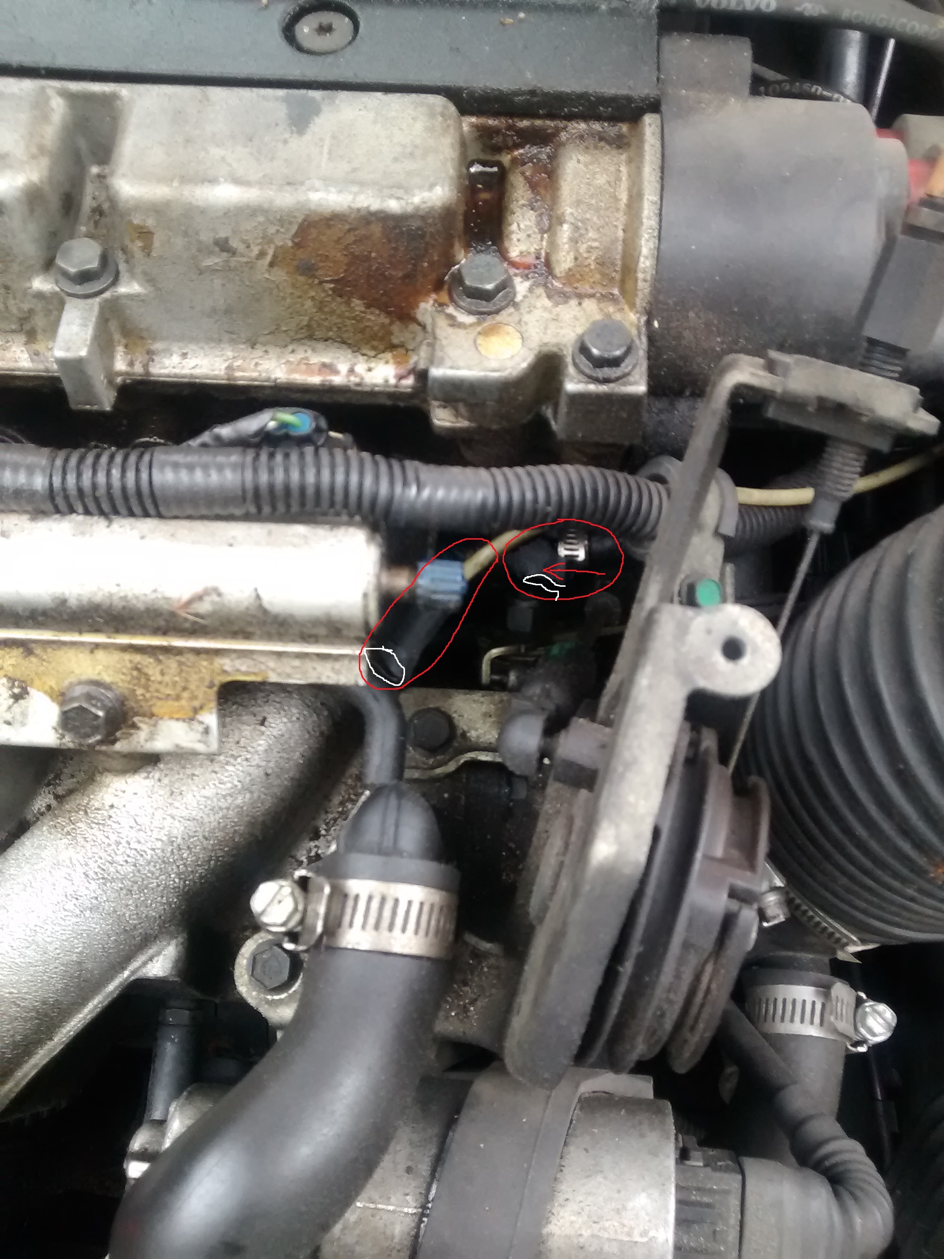

Hey can anyone tell me what hoses these are?

Car is leaking oil real bad. I think its one of these hoses. The one with the clamp?
Also what is the white line I circled?
Thanks to anyone who can help me or tries :)

The white lines drawn on I drew to show where the hose is cracked (the oil one with the clamp)
and the other where its not connected to anything

Looks like you car is non-turbo, look this over carefully: viewtopic.php?t=65002
White line is probably for the airbox.
I think the one with the clamp is PCV hose, may be dripping oil spooge. Is the CEL on?
Check your rear cam seal inside the distributor cap for oil leak - does the car stumble at all?
