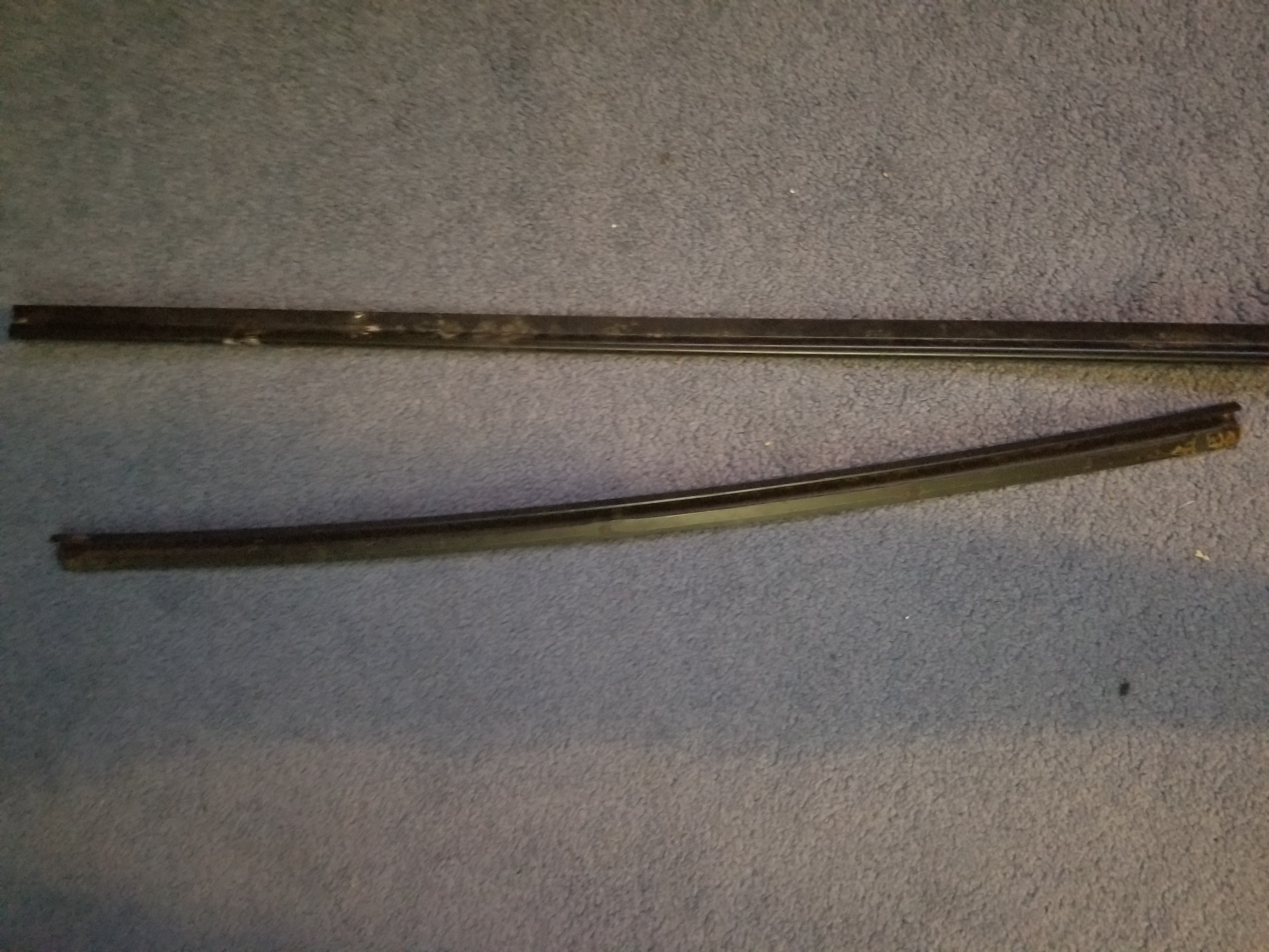

Also the previous own gave me a metal bar saying it fell out from sunroof. I also found one that was abit longer but similar under the rear seats when i changed the shocks. For the life of me I cant figure out where they go. The sunroof itself seems flimsy so I suspect some type of support bars. I attached a pic of them.
sunroof and alarm siren
