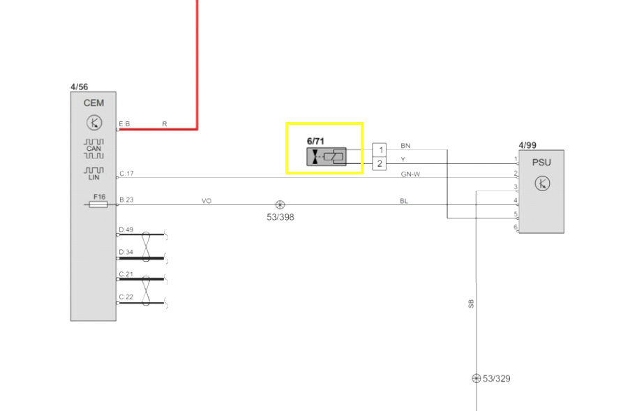

Looks like it's driven by the Power Steering Unit...

Actually, after looking at the diagram, i think it can be done (not that it is relevant anymore). Component 6/71 is a valve (also depicted by the symbol; an electronically operated valve). It does not contain a sensor, nor is there any other sensor (or electronics) on the powersteering unit, pump, lines, hoses or reservoir itself. The valve directs high-pressure fluid in low speed situations to the rack, and diverts the high pressure fluid internally in the rack back to the reservoir. I'd therefore say that indeed a speed sensitive power steering rack can be replaced by a non-speed sensitive rack, maybe even without connecting the valve (although that may cause a DTC to pop up due to infinite resistance over the two terminals normally connected to the valve).
