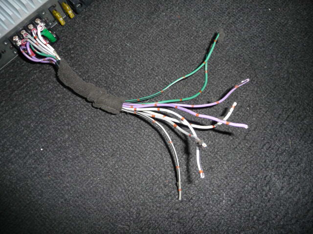

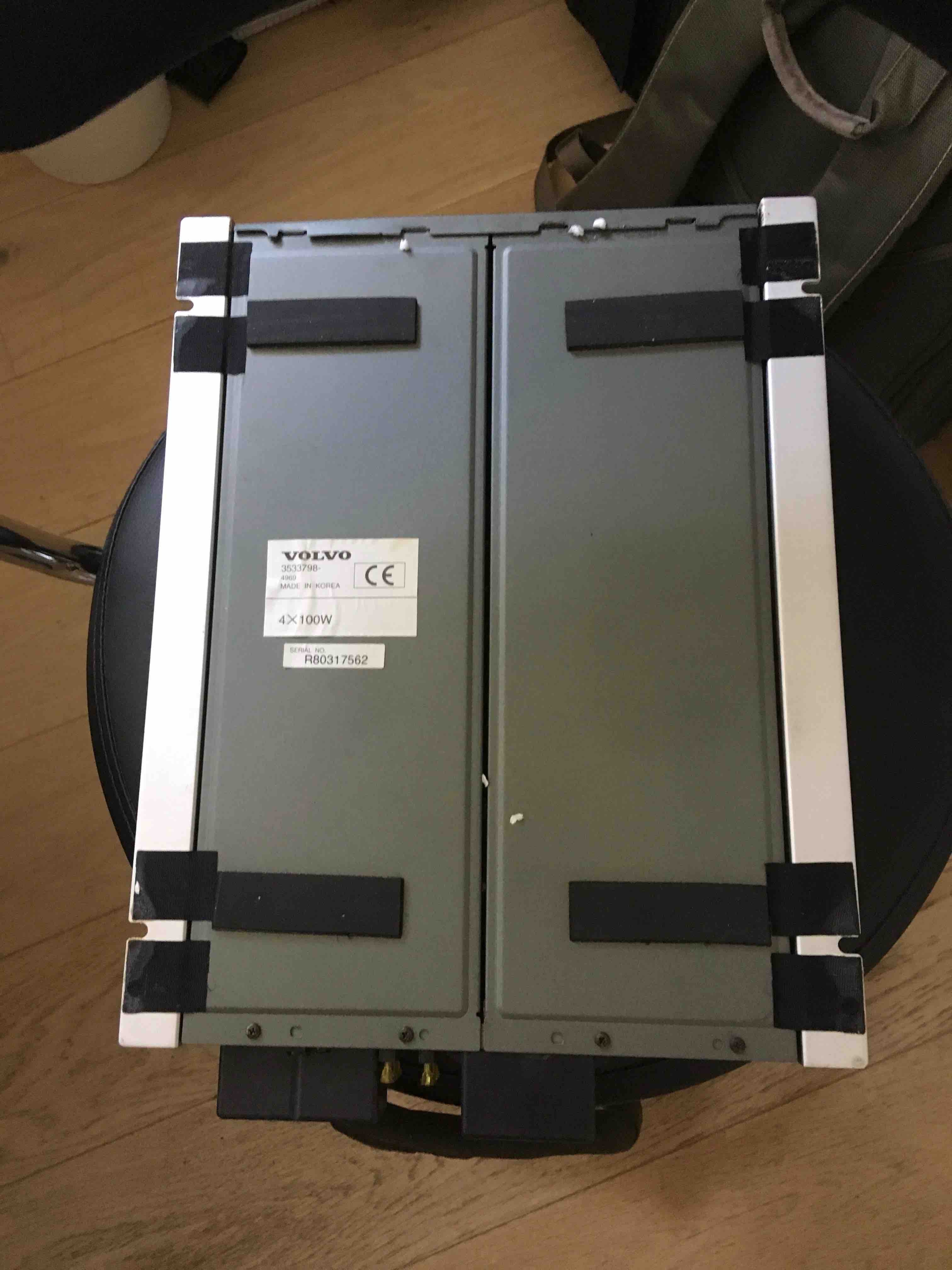

Hy Buddies,
I'm looking for the harness. Is there someone that may have it already removed ? (amplifier Volvo 4 X 100 W)

Where do you want to install it?
The original location in the C's is way in back.
Some have put it under the passenger seat,
but the OEM cable would be really long for that.
It's really just an Alpine V12 amp with a 6 pin DIN
for the input and remote turn on instead of RCA's
and a blue wire. All you really need is the right DIN
to RCA adapter.
Power, ground and speakers are all screw terminal.
Speakers as shown should be:
White - FL
Gray - FR
Green - RL
Violet RR
