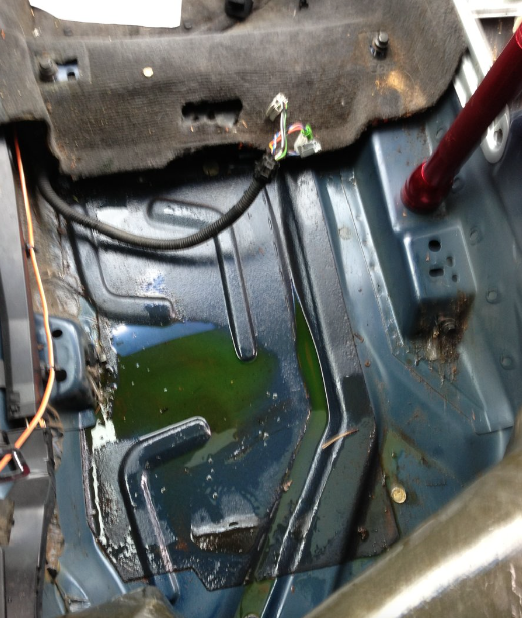

If you decide to remove the seats, as I did, make sure you disconnect the battery, so that you don't get an SRS code from the sets being out.
I had to remove to get all the coolant out of my 1999 - 6 years ago!!
