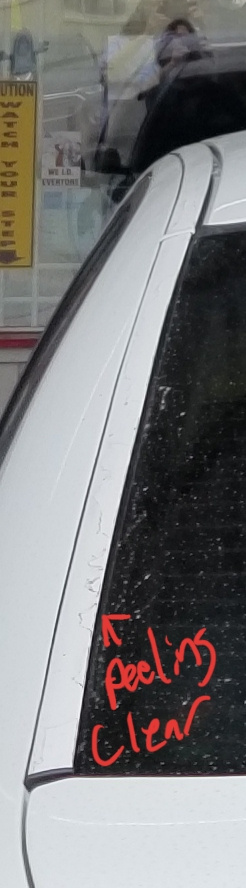

Does anyone know how to remove the clear tape on the roof trim. Peeling really bad and looks really bad. I have some color match paint I'd like to just paint them but I need to remove the clear tape first.
There must be a body shop secret to get that stuff off.
I've tried mild heat, steam, WD-40 nothing is working on the sections not peeling.
Thanks
John

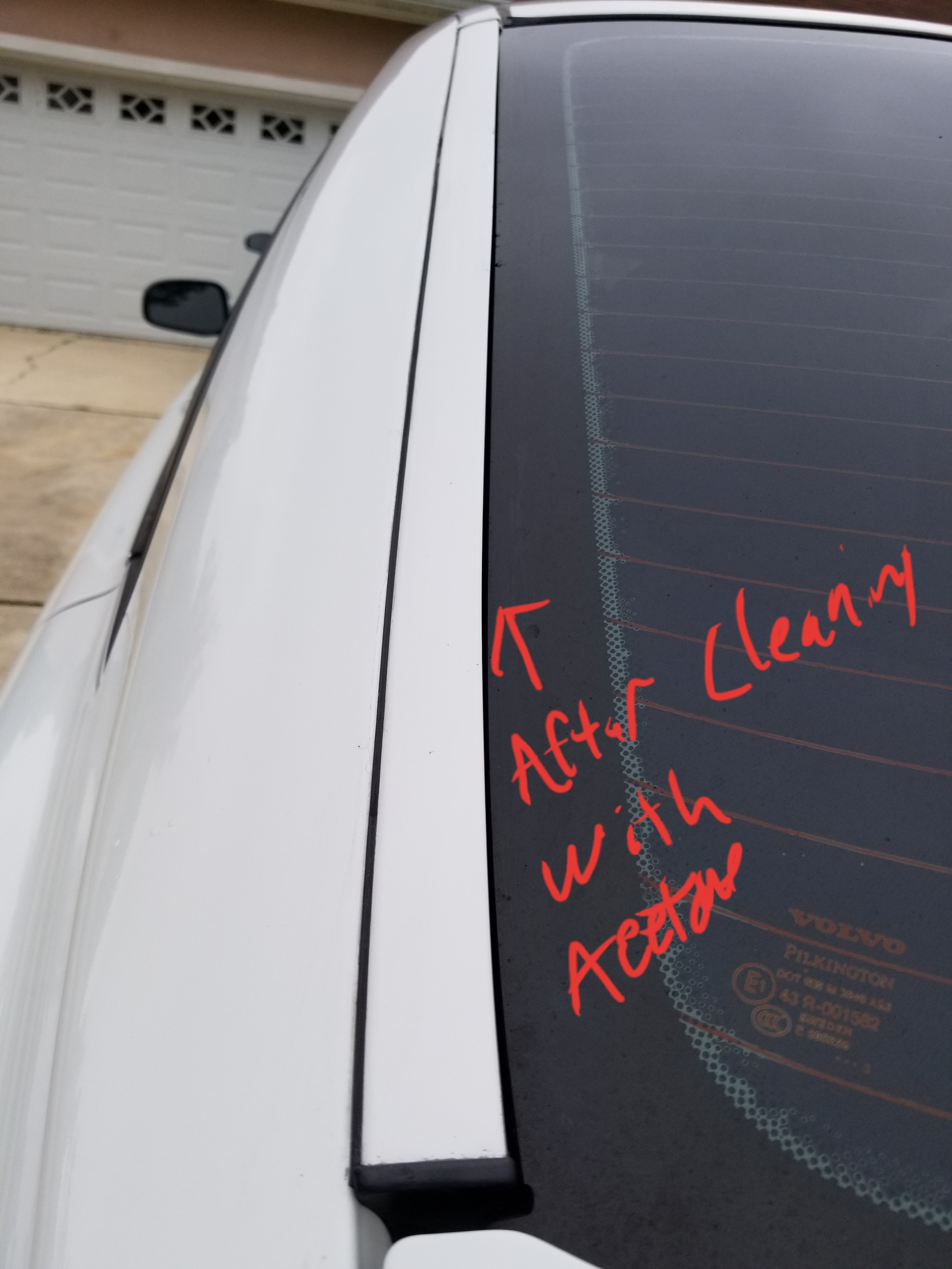

I used acetone on paper towels many times over a six month period and now they look fine. My car is Ice White and the white under the peeling clear on the rails didn't rub off. I was careful about hitting the car's body paint, but where I did it didn't hurt the factory paint. The sticky residue tends to smear so use lots of paper towels. Definitely test areas of the car's paint first. My car definitely has its factory paint. A repaint may not fare so well. Also now that the rails are stripped I am toying wit the idea with vinyl wrapping them. June

Both. The acetone caused the rest of the clear tape to wrinkle and come loose. Most of the tape was intact when I started. It took several cleanings before it was all gone. I didn't spend much time each time. Had I worked at it could have been done in a day. I'll add photos of what it looks like now in the morning. June

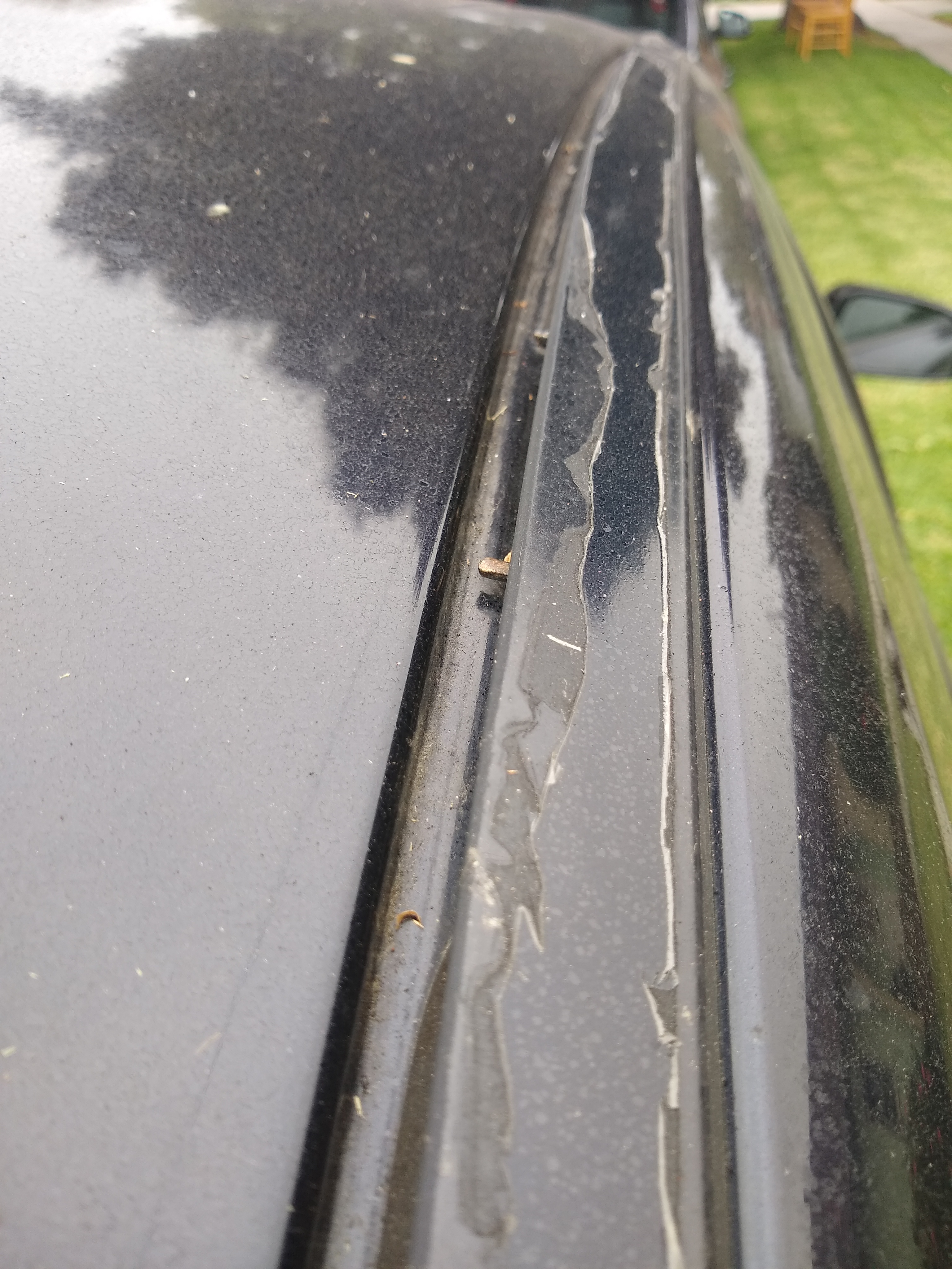

Here is a zoom in of a peeling rail before acetone cleaning, and the same rail after acetone cleaning taken today. June

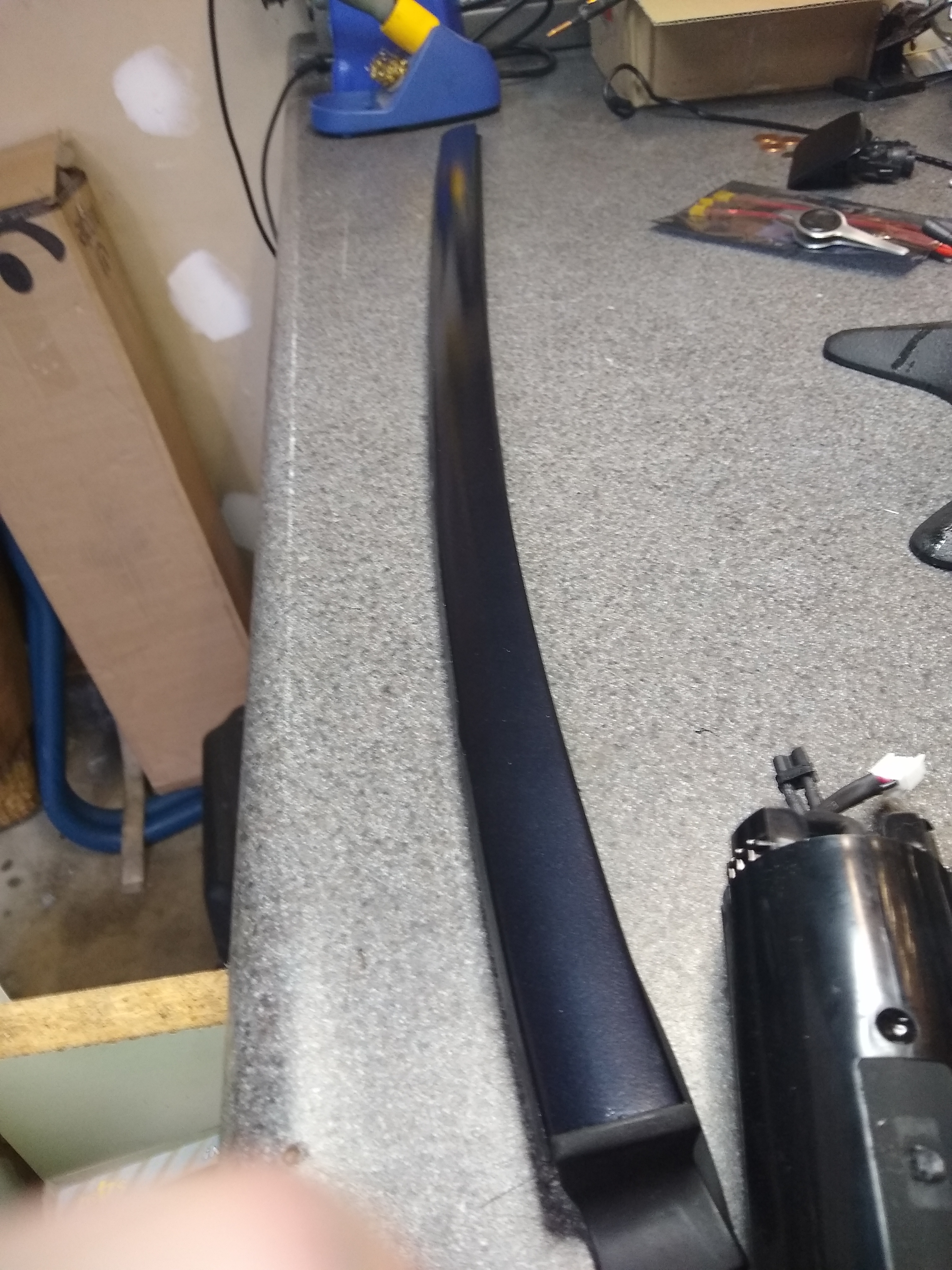

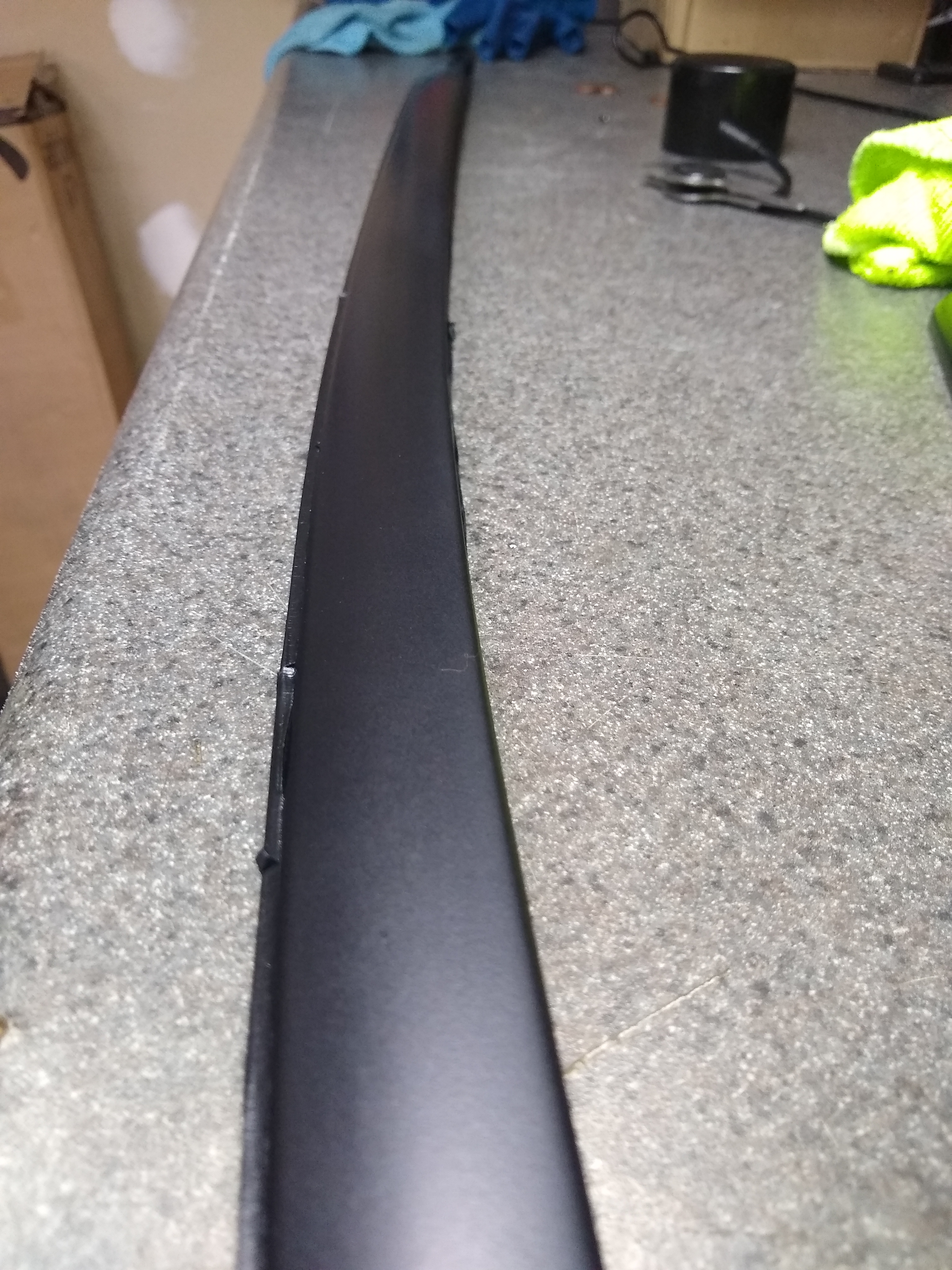

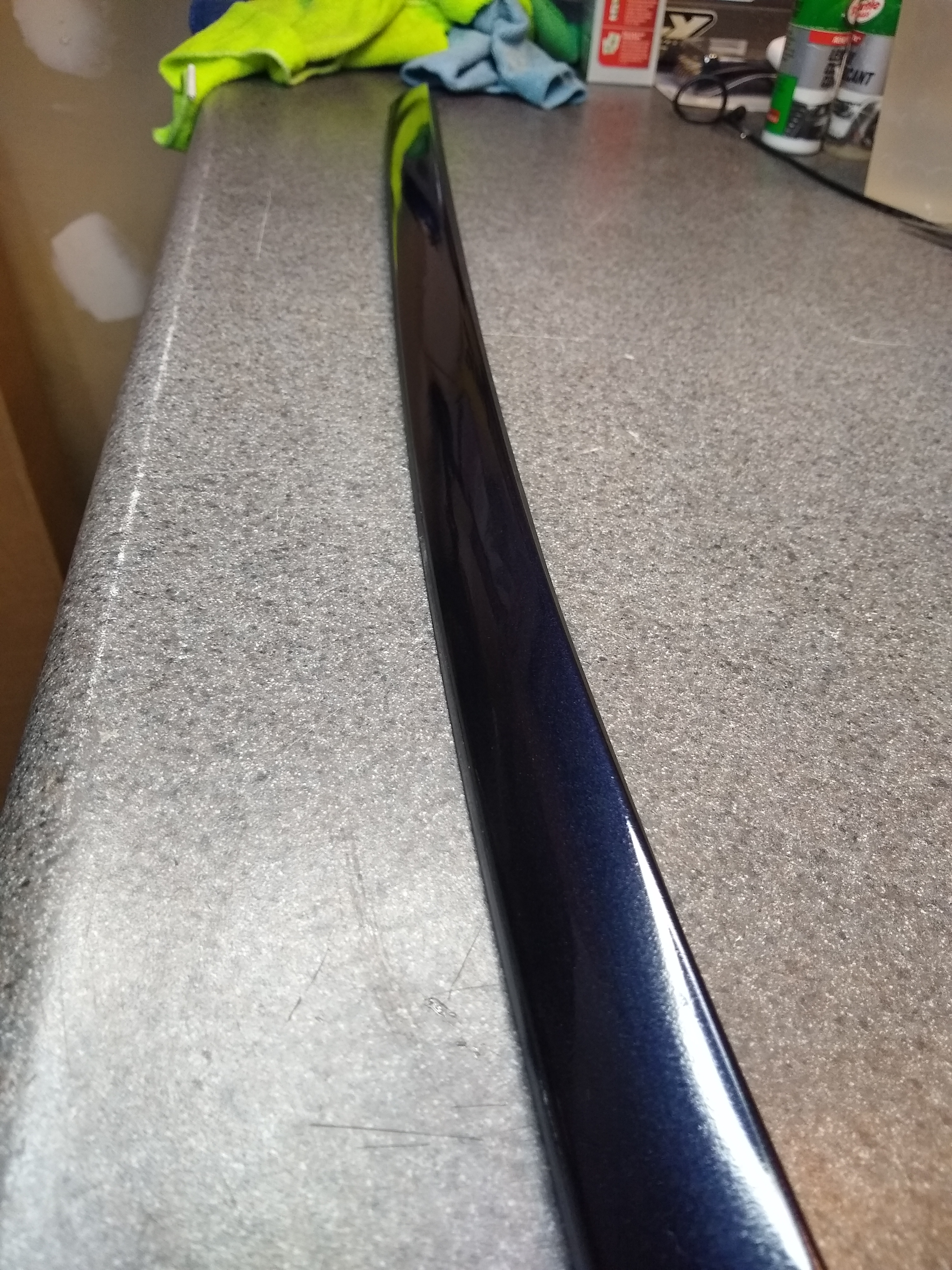

Finished the rear driver side, look so much better. Thanks June for the acetone advice!!!!! Here are some progress photos:
Example of existing condition, please ignore the dirt :)
Base coat
Clear coat
Wet sanded and polished
I have zero experience doing automotive paint, closest experience was painting a few bikes as a kids :) I was able to purchase color coded Volvo paint on ebay in a spray can and figured I couldn't make it any worse. It actually looks really good. The paint is Magic Blue #467 which has a metallic sparkle so I was really worried about the finish, but after wet sanding the clear and polishing it sparkled!

No sanding the base coat, just the clear.
1. 2-3 coats of base about 15 minutes apart. Each coat was a decent amount of paint using fast passes over the piece I'm painting.
2. 3-4 Coats of clear, same technic.
3. 48 hours later, sanded 1000 -> 1500 -> 2000 -> 2500 -> Meguiars/Mothers swirl removal -> Meguiars/Mothers polish -> Meguiars/Mothers wax
The first time I sanded too much and had to reapply the base coat. I was trying to get a dull even finish but with my painting skills that's not possible. If after the swirl removal you have unevenness you can sand a little more, you won't get the shine until you polish.
