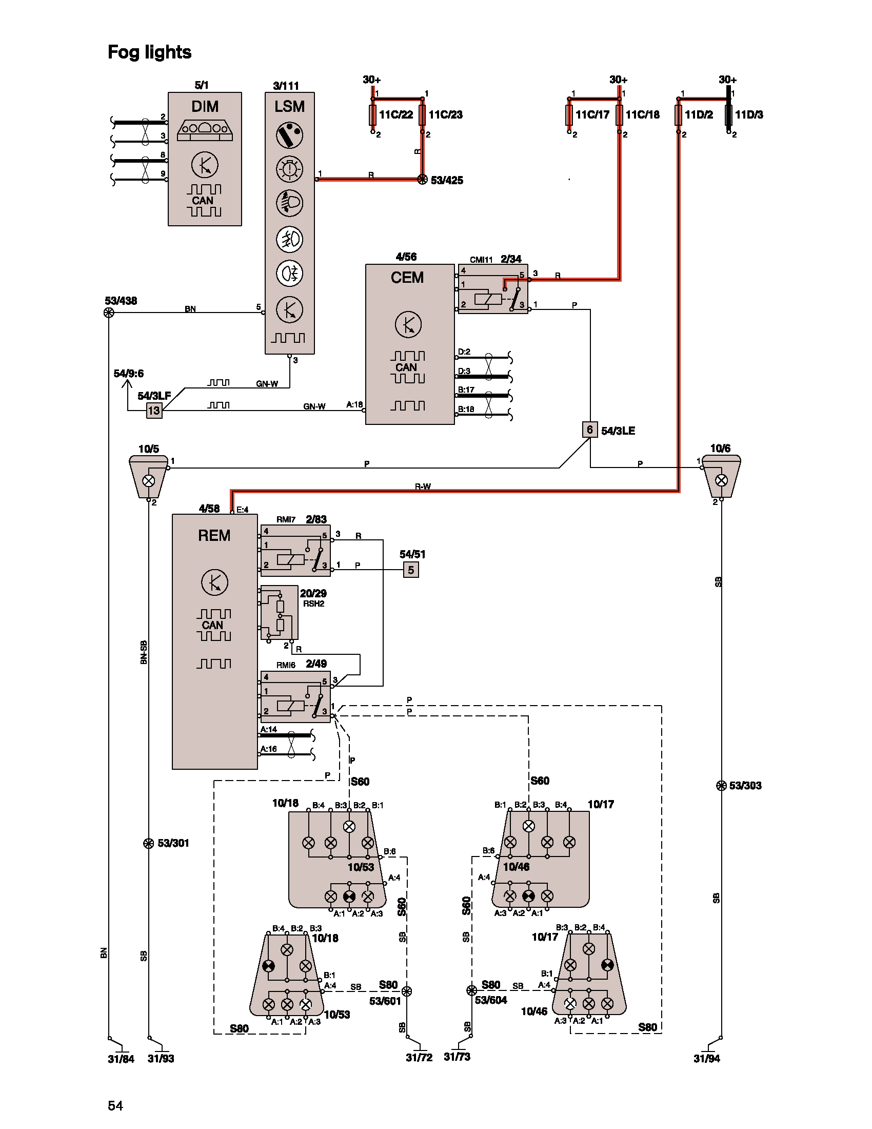

Is your Driver Information and Accessories all working?
10/53 (LHD) and 10/46 (RHD) are the rear Fog lights.

RickHaleParker wrote: 07 Oct 2019, 19:21 Is your Driver Information and Accessories all working?
Everything is working. I just found out that rear fog lamp has relay in the back next tu fuses. But i cannot find list on the internet and cannot identify by myself. Maybe someone can help? As indicated previously it is year 2003 volvo s80.
