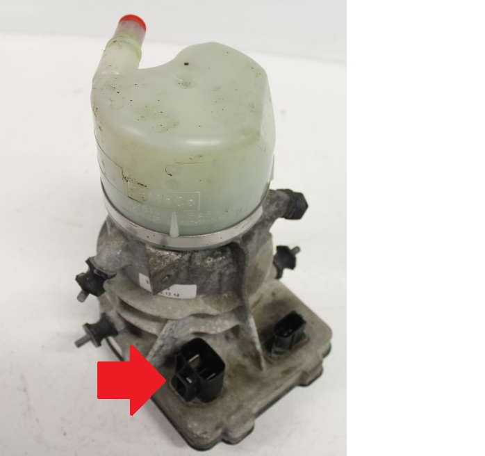

No problem.
My 2010 S80 has a traditional mechanical power steering pump.
The connection that you are looking for is marked with the red arrow\
Power Steering Pump - Volvo (36011310)
I do think that a failed electric motor could cause Voltage dip problems that would propagate thru the vehicle
Good Luck
Paul

I have to say, I was super skeptical of this idea. But hey, everything that made sense to me so far didn't fix my problem, so I did what you said and BOOM you were right all the bizzar codes went away right after unplugging the power steering pump.
Note: the 100 amp fuse was not enough the plug had to be removed (this is for people in the future)
Note: I am still scanning a P0700 transmission code, but it was pending, will update when I change pump.
Thank you Paul, I am still blown away.
