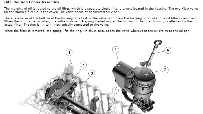

I wanted to share what I know about the anti drain valve that is under the oil filter
Description of the anti drain valve

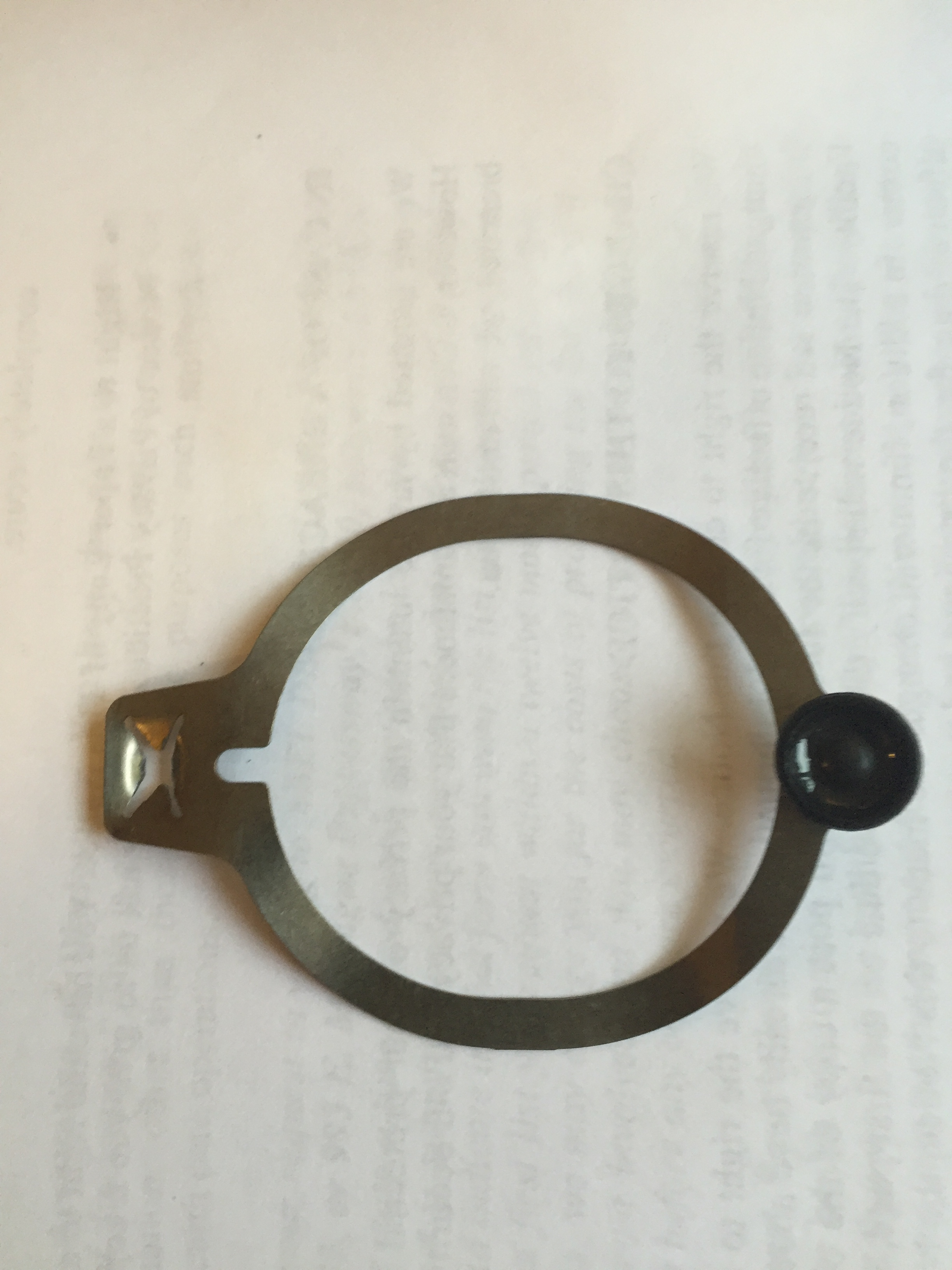

Anti Drain valve removed from the housing

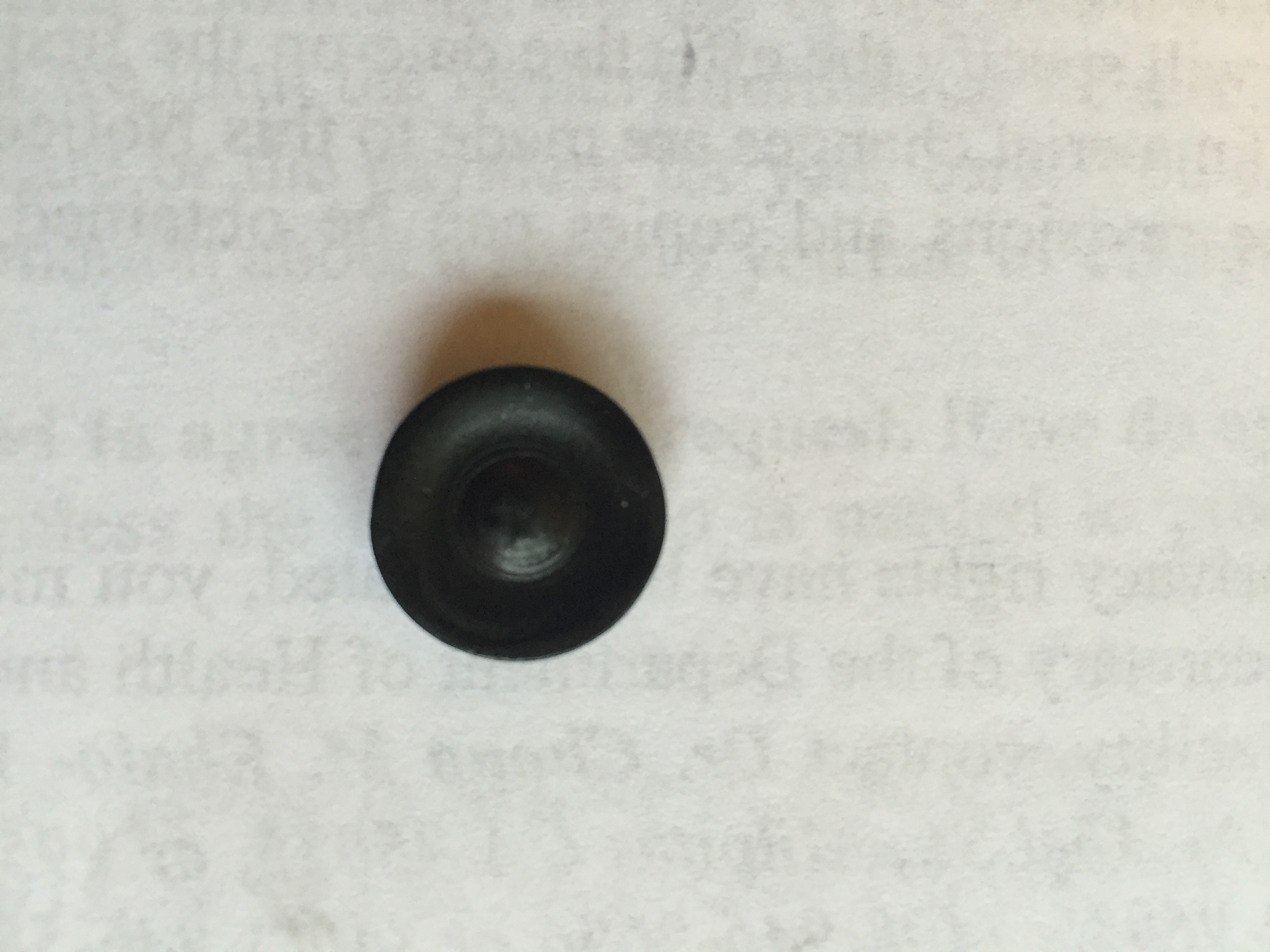

the black rubber disc is what hold the oil in the housing when the engine is turned off.
If your black rubber disc is missing or damaged then it is time to fix it.

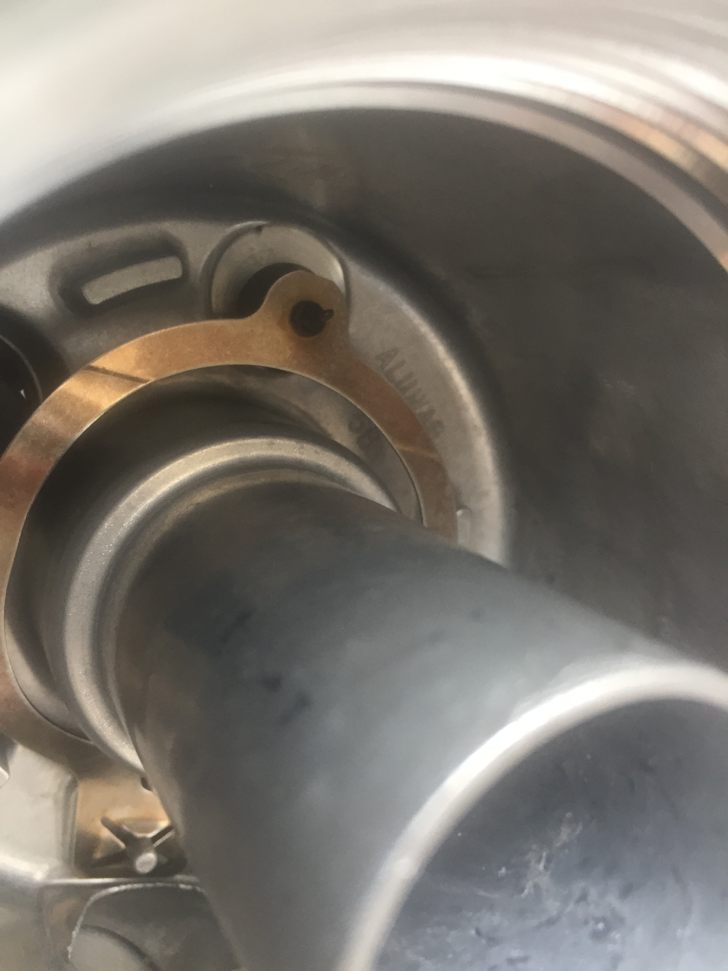

View from above with the oil filter removed
Note: this is what you see when you remove the oil filter during an oil change

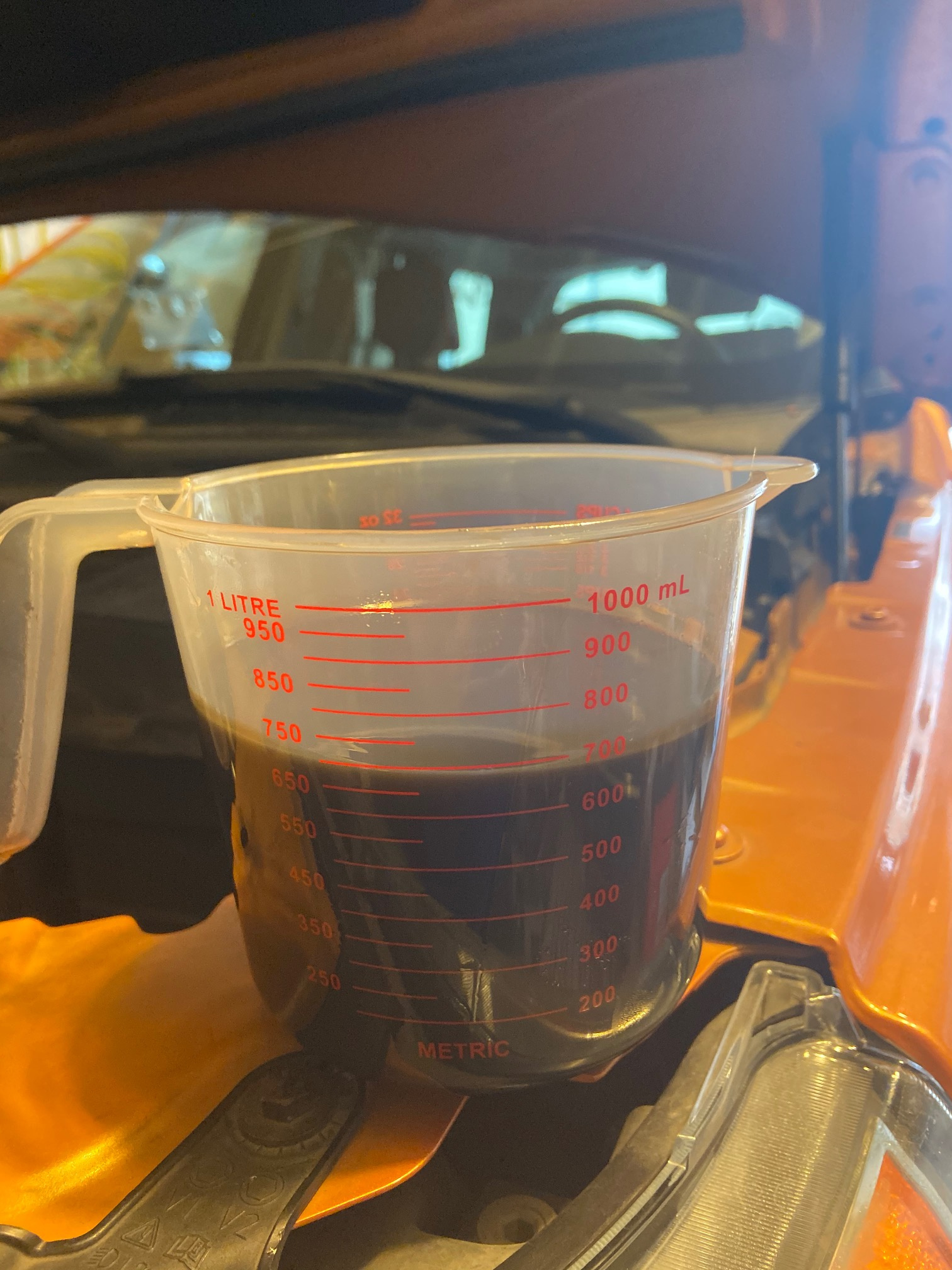

For this picture I did the following
1. I drained the engine oil without removing the cap for the oil filter (waited 20 minutes for the oil to stop dripping)
2. I placed the measuring cup under the oil drain hole
3. I opened up the oil filter housing
4. I measured how much oil is held up by the anti drain valve (look at the picture)
700 CC is a lot of fluid
If your anti drain valve is broken (it was broken on both of my 3.2's) then the reading on the dipstick isn't correct
