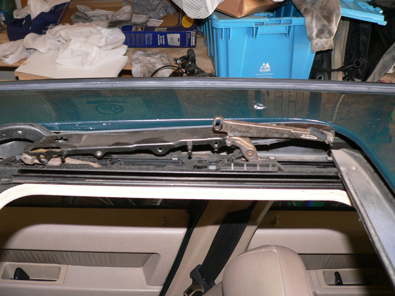

Right before finals and my son's S70 sunroof got stuck in the vent position. We found that the plastic piece on the rail had broken off. Once we removed the broken piece we could get it to close almost all the way, but not completely. With weather this time of year we need to fix it, but I'm not sure what the part is called or if we need to replace the whole assembly on that side. (There's a V70 in a local junk yard that we can go pull from.)
What is the process to get to it? When we removed the glass, we could get a better view, but couldn't get to the bolts under the rail that holds the glass. If you look at Wheelsup picture in this post, download/file.php?id=4591, the black plastic piece that broke is roughly above the seatbelt and connects to the gold piece and bottom rail.
He does almost all of his own work on the car, but the sunroof is something we haven't had to deal with yet. Thanks!

After doing even more searching, I found this post, viewtopic.php?t=30828, which is the same issue but the broken piece in this photo appears to be the one towards the front of the car and ours is towards the rear. Anyone have any idea how to move the remaining broken piece around to get the sunroof to close? Right now there's about a 1/4 inch tilt on it, so it's not a tight seal. That would buy us time to figure out the fix.
That leads me to my second question. Is the part that's needed the rail, or is there a specific part number for the plastic piece? I've looked at diagrams, and the rail (9159880) doesn't seem to include the part that's an issue. Unless the diagram is simplified. Ideally we will be able to go pull from a junkyard, which would answer my questions, but the yards nearby don't have the sunroof, which means it will either be a day trip somewhere or ordering a replacement part, which takes time.

Thank you for your response! We bought the S70 new, and the headliner/interior is still in fantastic shape. Is it worth pulling and potentially messing it up? Complicated isn't really an issue if we have an idea what we are doing, though our experience is primarily engine related and very little interior work. I would imagine the trim is brittle based on the age. If so, any tips on how to get the sunroof seated until we can find a closer donor car or get the time to drive to one?
