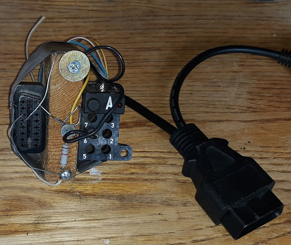

Here's the link to the how to build a flash code reader thread:
viewtopic.php?t=60660
Very useful for reading ECC codes.
Here is my homemade version using the obd1 port salvaged from my 94 850 and an obdII splitter:
