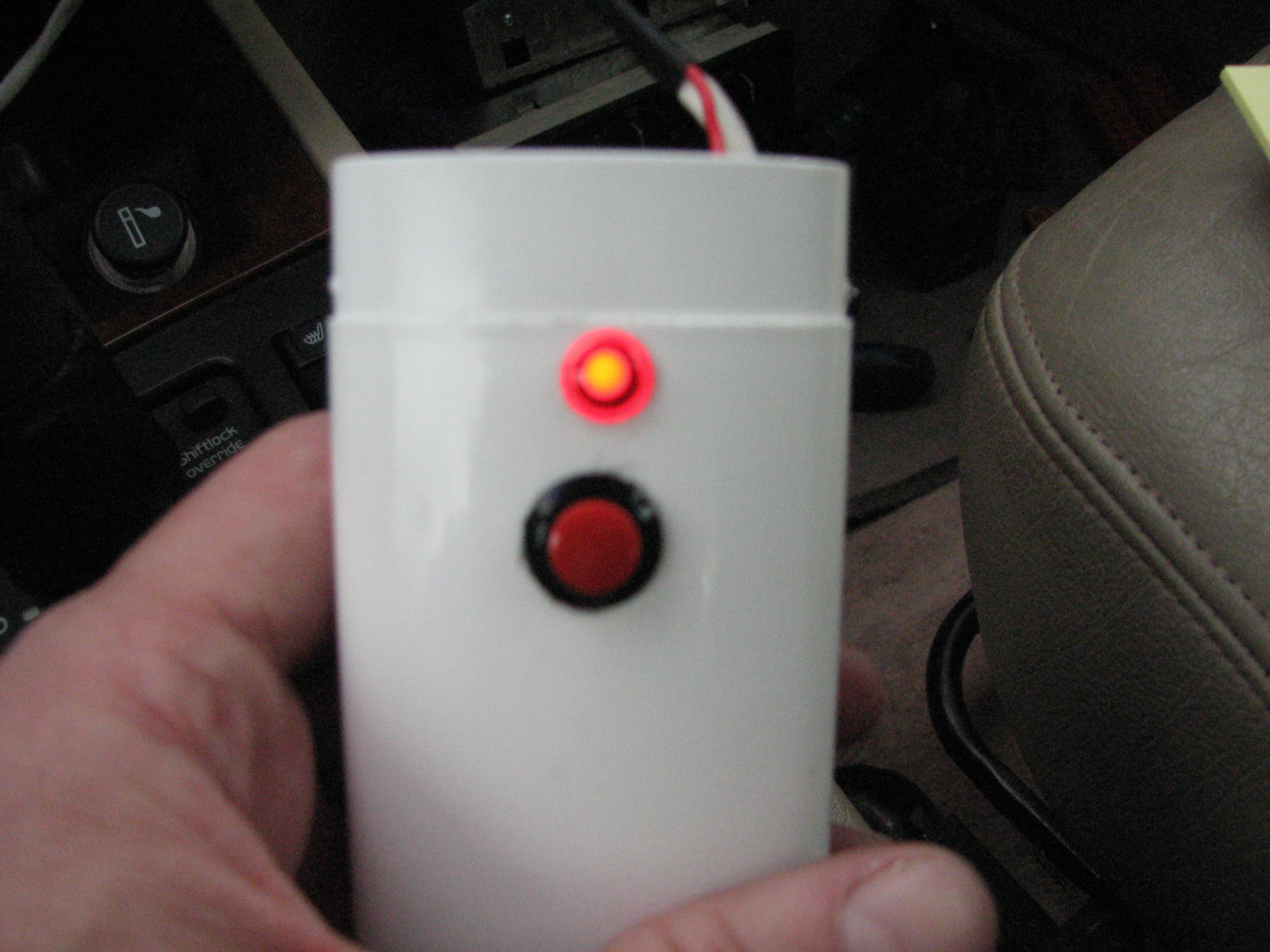

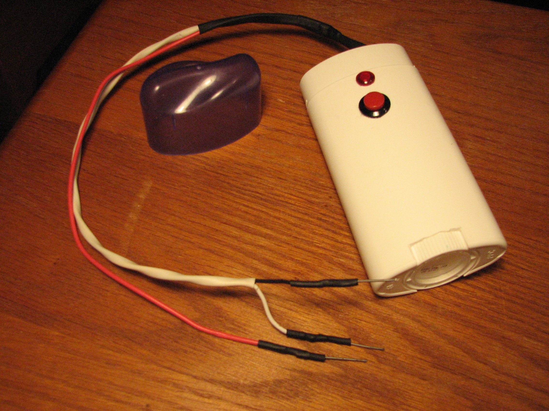

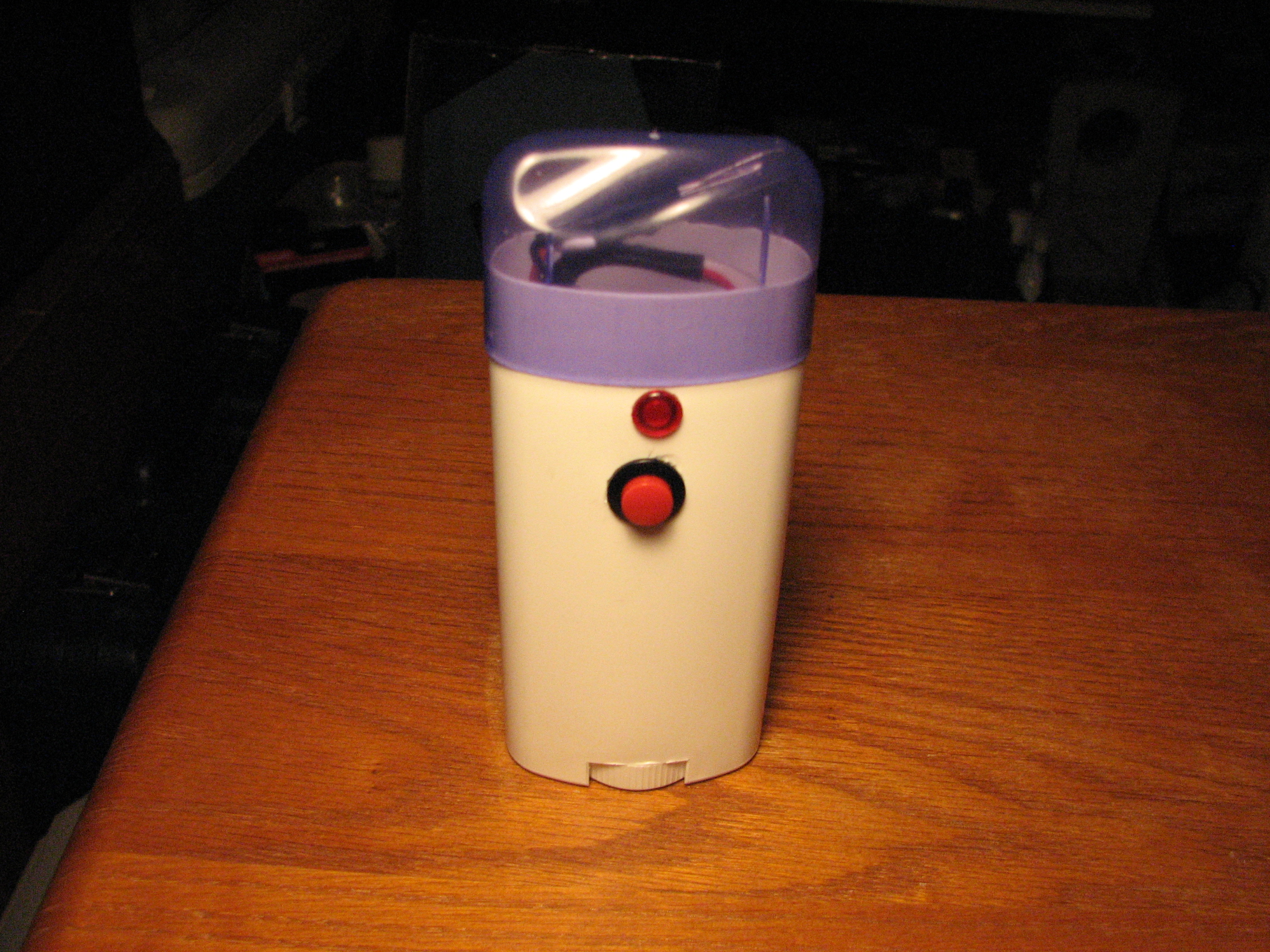

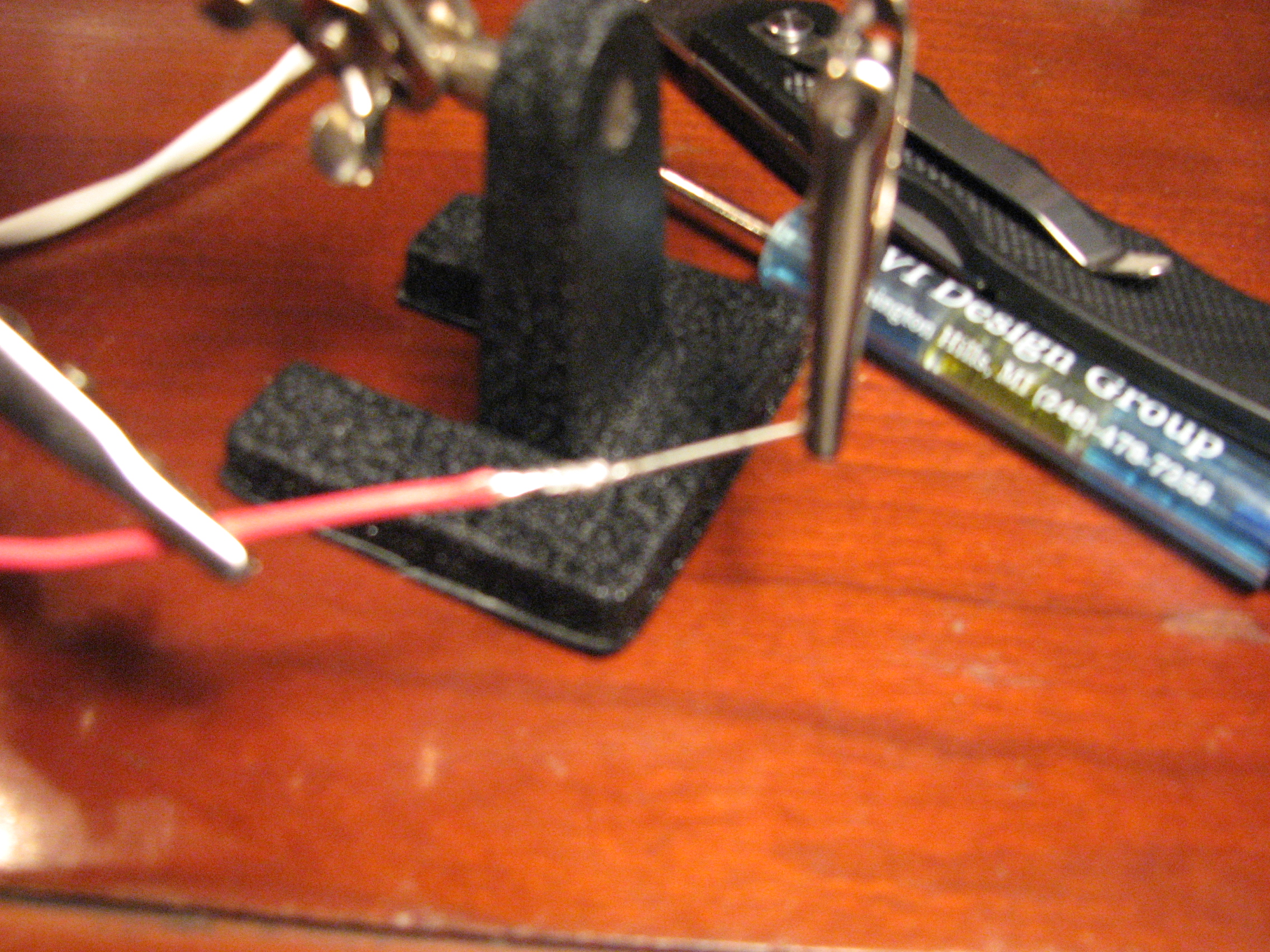

I made this a couple weeks ago to read the ECC codes from the OBD II port on my '96 Turbo Wagon.
It is documented in my ongoing thread (at this point) to determine my intermittent ECC failure, but I thought it could be mentioned in the tool section.

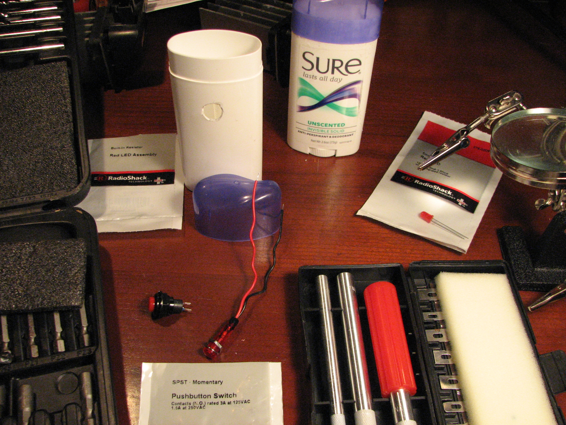

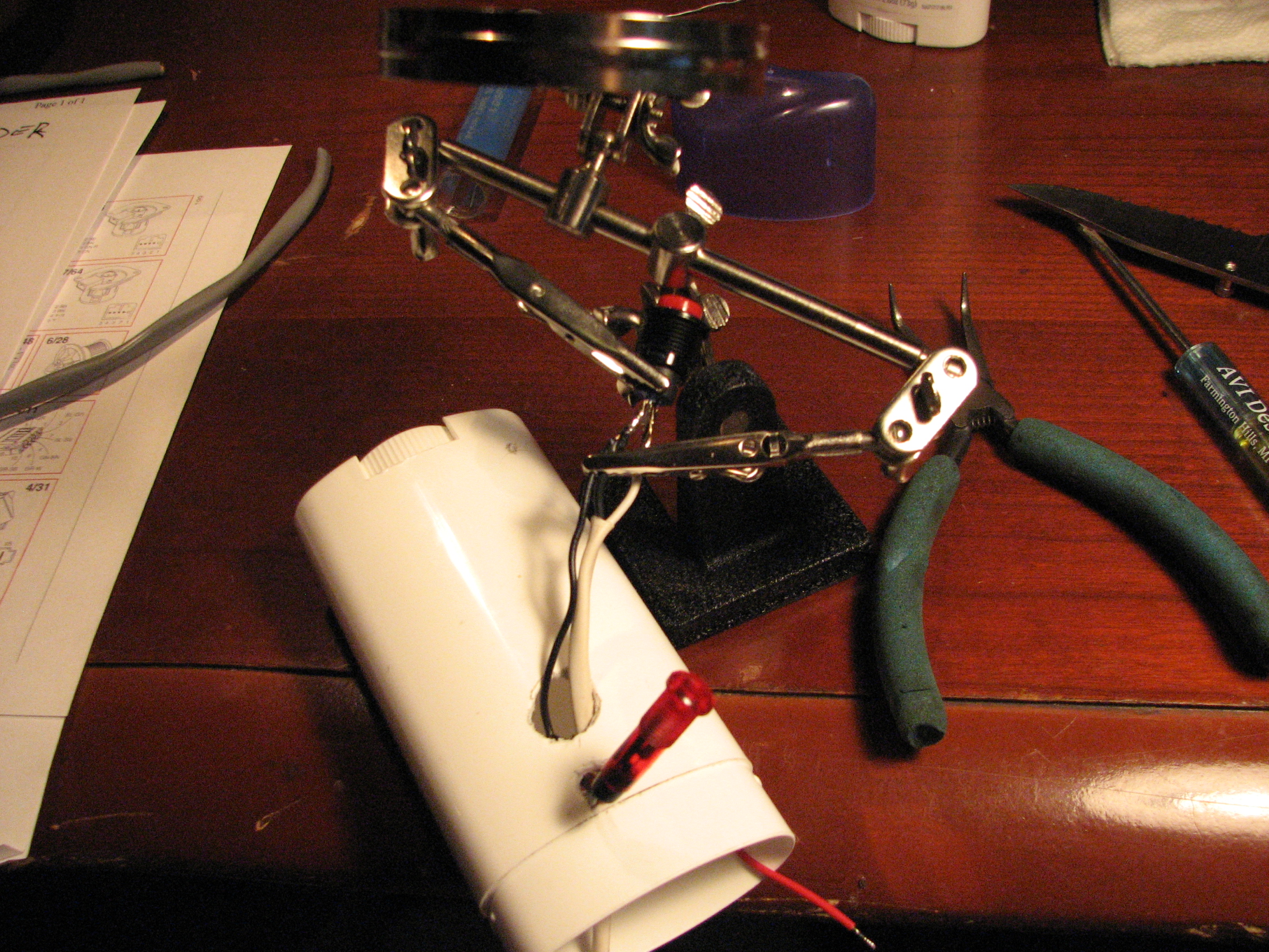

I was going to do a simple momentary switch, LED and three lead wires. Not needing it until the next day I was bored and decided to repurpose a garbage item.
Here is the Schematic.
The mother of invention is sometimes boredom.
The pictures are self explanatory.
Explanations on how to use this to read and clear trouble codes OBD I style through the OBD II port are in a number of threads. I will add links as I find them.
Have Fun.
OBD I style LED Flash code Reader.

Whoa, Ben, this is amazing. I like how you used the body of a deodorant product. Really cool!

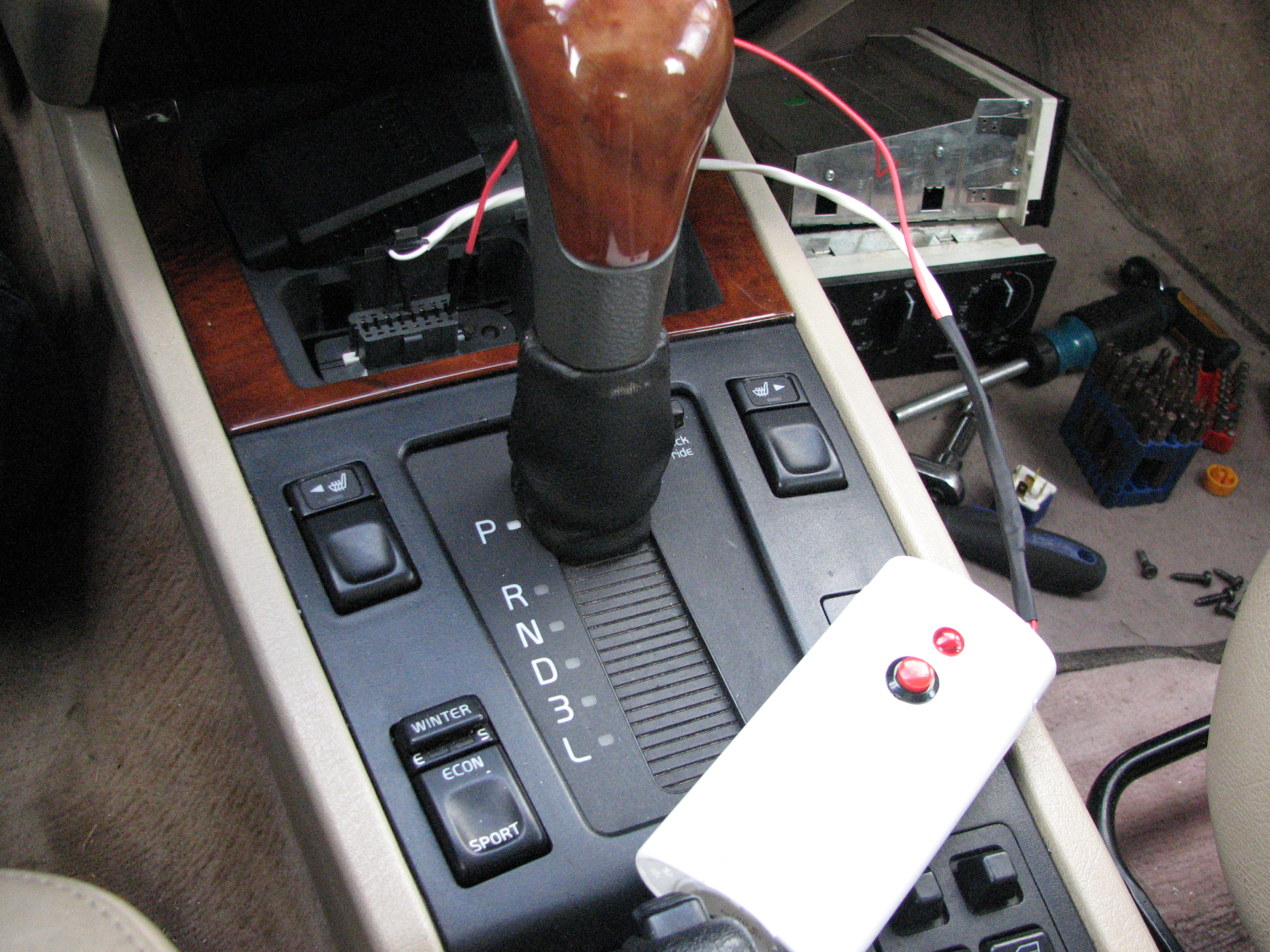

They are read in the same manner as the OBD I under the hood in the '93 to '95 850 series.Huskyhunter wrote:Did you ever find a thread on how to read the codes?
It also allows clearing of the codes and resetting service engine light.
There are threads here that explain this, as well as the code explanations.
Search for threads, I will add them to this one as I find them.
https://www.matthewsvolvosite.com/read-codes-volvo-850
This is the info on the codes and the jumper ports while using the OBD I box under the hood.
Through the OBDII port, the pin diagram at the top of this thread actually shows the pin configuration to get information from the ECU Monotronic system.
The service engine light can be reset from there after reading and clearing all codes.
Move the lead from pin #3 to pin #6 to read and clear codes from the ECC. If any codes come back, the issues setting them have not been fixed.
If you have a good ECC unit, and finally get the 1-1-1 code back, you have successfully taken care of the issues and there will be no more flashing lights at startup.
Pin #12 reads ABS codes.
Pin #13 reads cruise control codes.

I must say, I am glad to have put this into such an accessible unit. It is greasy and durable. Not even damaged in a heavy tool bag while being well utilized.

What a marvelous piece of kit! When does it go into production? Is production limited by deodorant use?
Sometimes you guys on this website aren't just great, but amazing!
