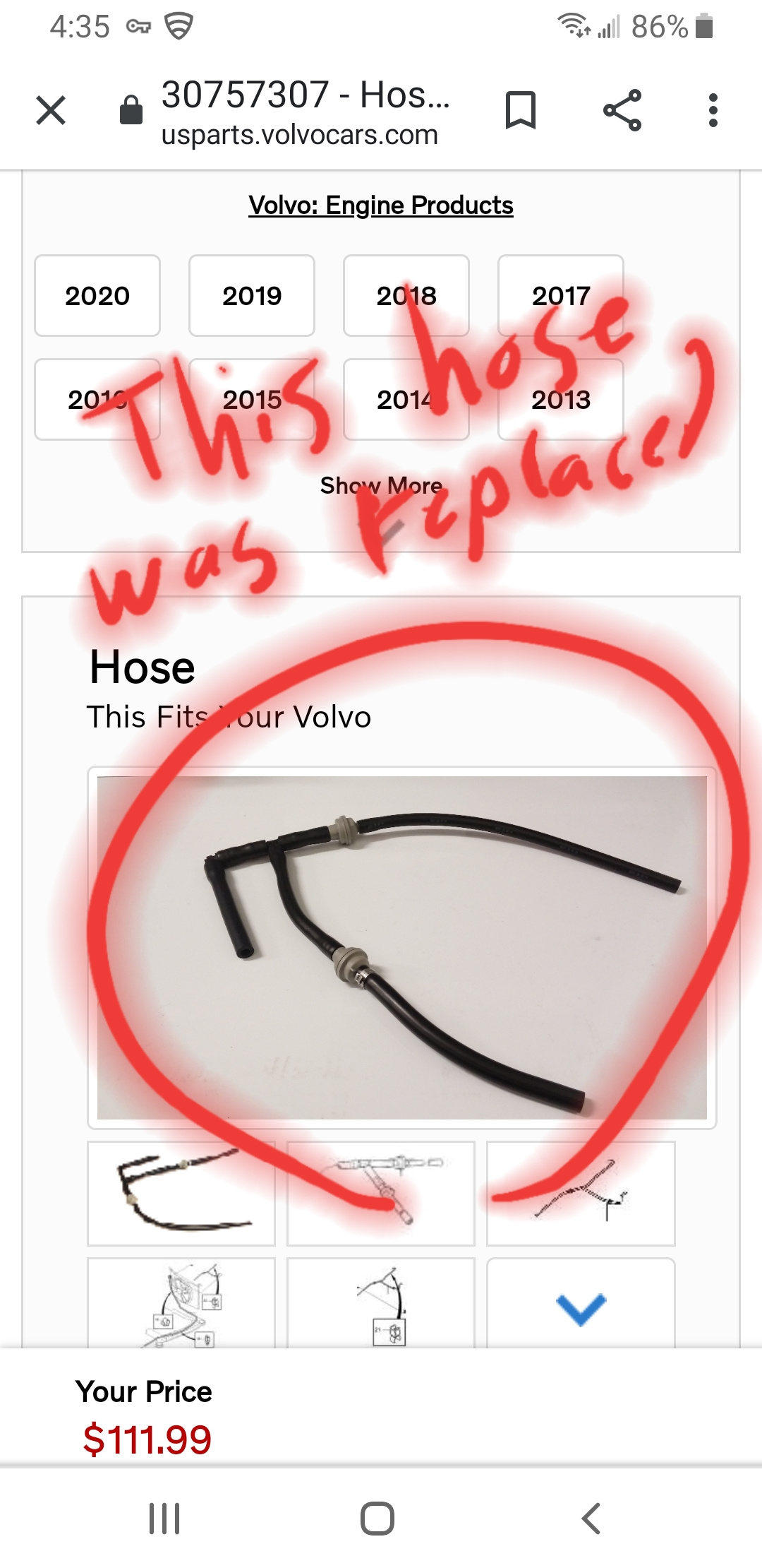

Yes vacuum leaks cause a hesitation. Just got my car back from Volvo service a hour ago and a hose assembly had a cracked vacuum hose. I had a engine light that came on for four days then went out. It was a purge valve code. The car had been hesitating for a month. Hesitation is gone now. I was just reading a post about vacuum leaks and ETM equipped Volvos earlier today. The below picture is the hose replaced on my car, though a vacuum leak anywhere likely will cause the same problem. You may want to block the booster off for a test run to see if it cures the problem. Maybe even smoke test the system for other leaks. June

All intake hoses good. Rubber intake boots replaced. Air filter a month old. Good call on checking the rest of the vac system. I honestly have no idea where the purge valve is on this car. Not much info online on the location either. I dont see it under the hood anywhere, I dont see it behind the rear fender area or near the fuel filter.

It does not seem to be vacuum related after blocking off. It doesn't seem to have other vac leaks, but will test that more.
To explain better, its sort of a mild dead pedal feel until about 10 percent throttle. It just lacks sensitivity from 0 to 10 percent.
