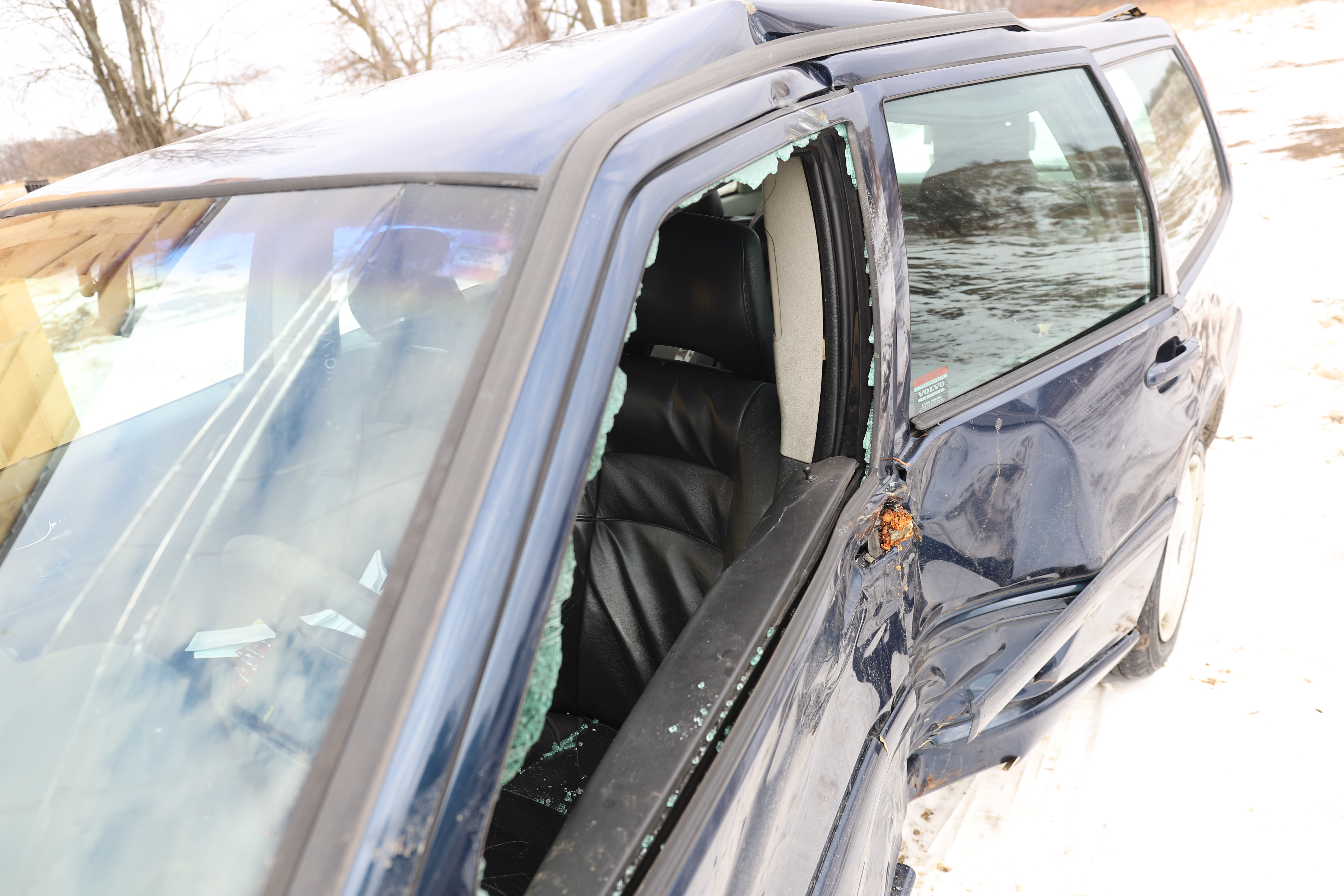

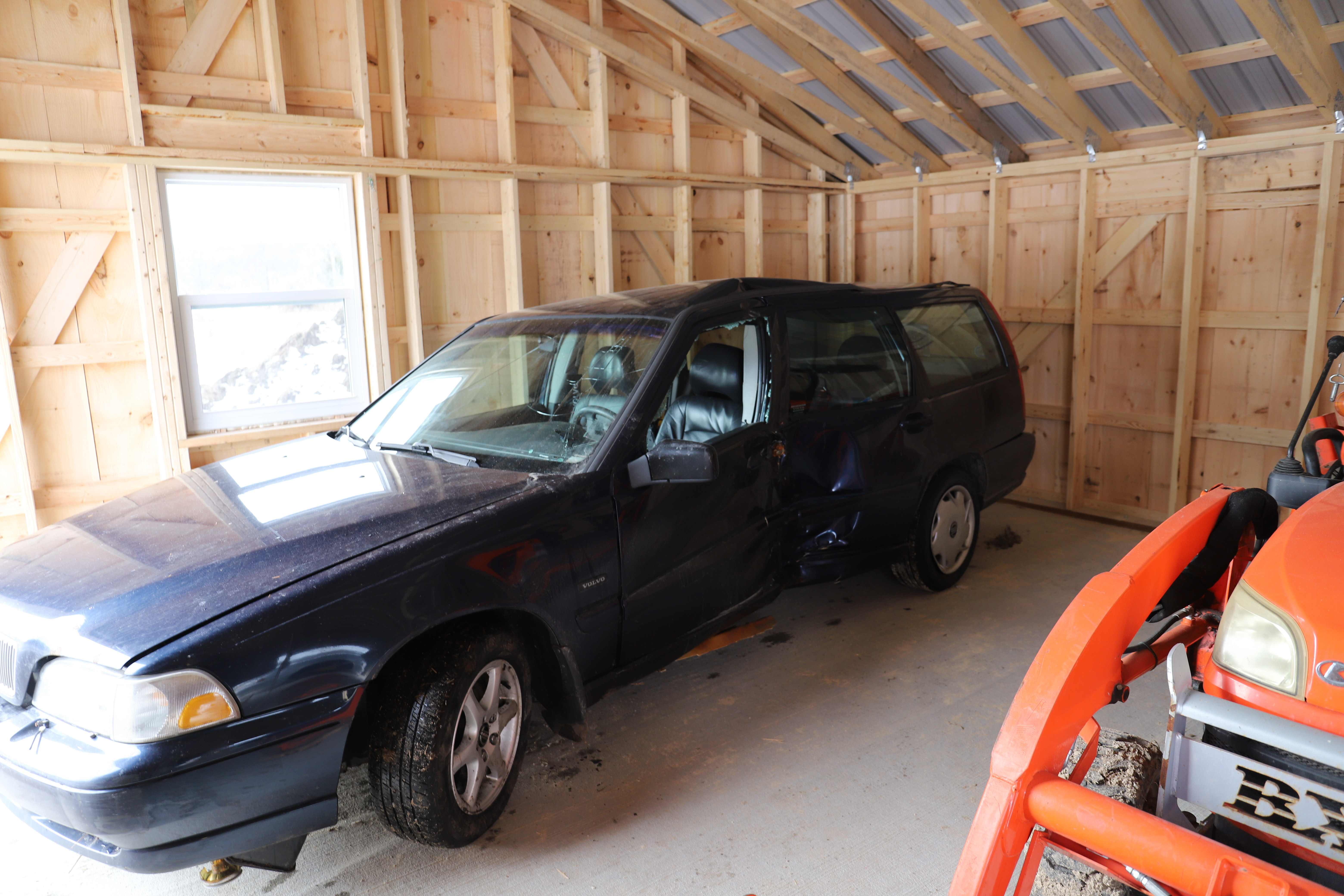

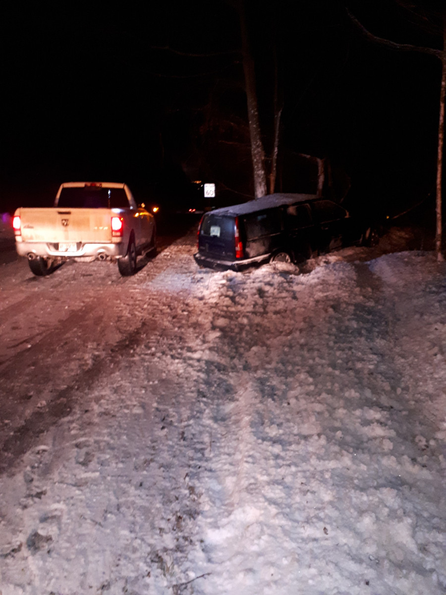

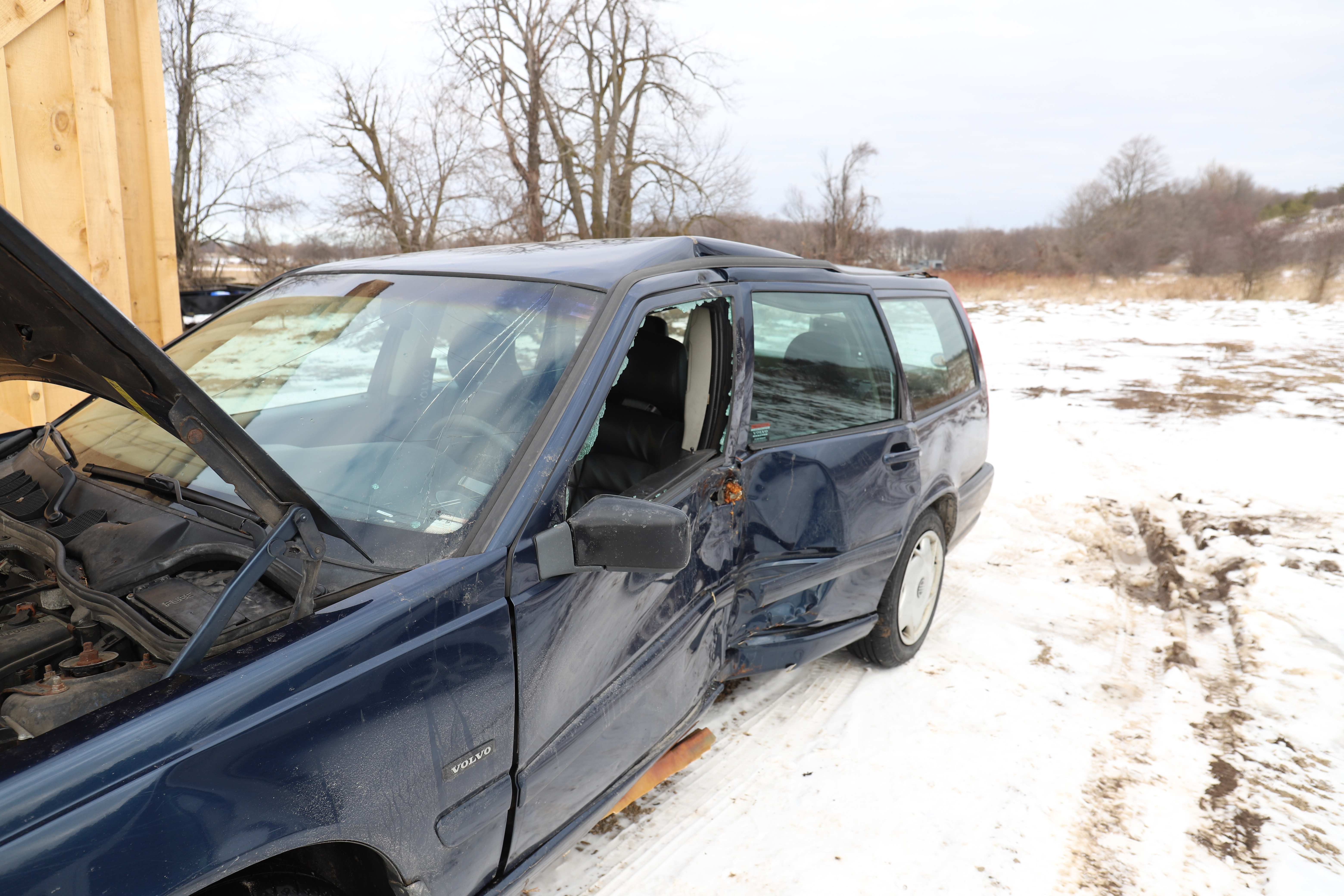

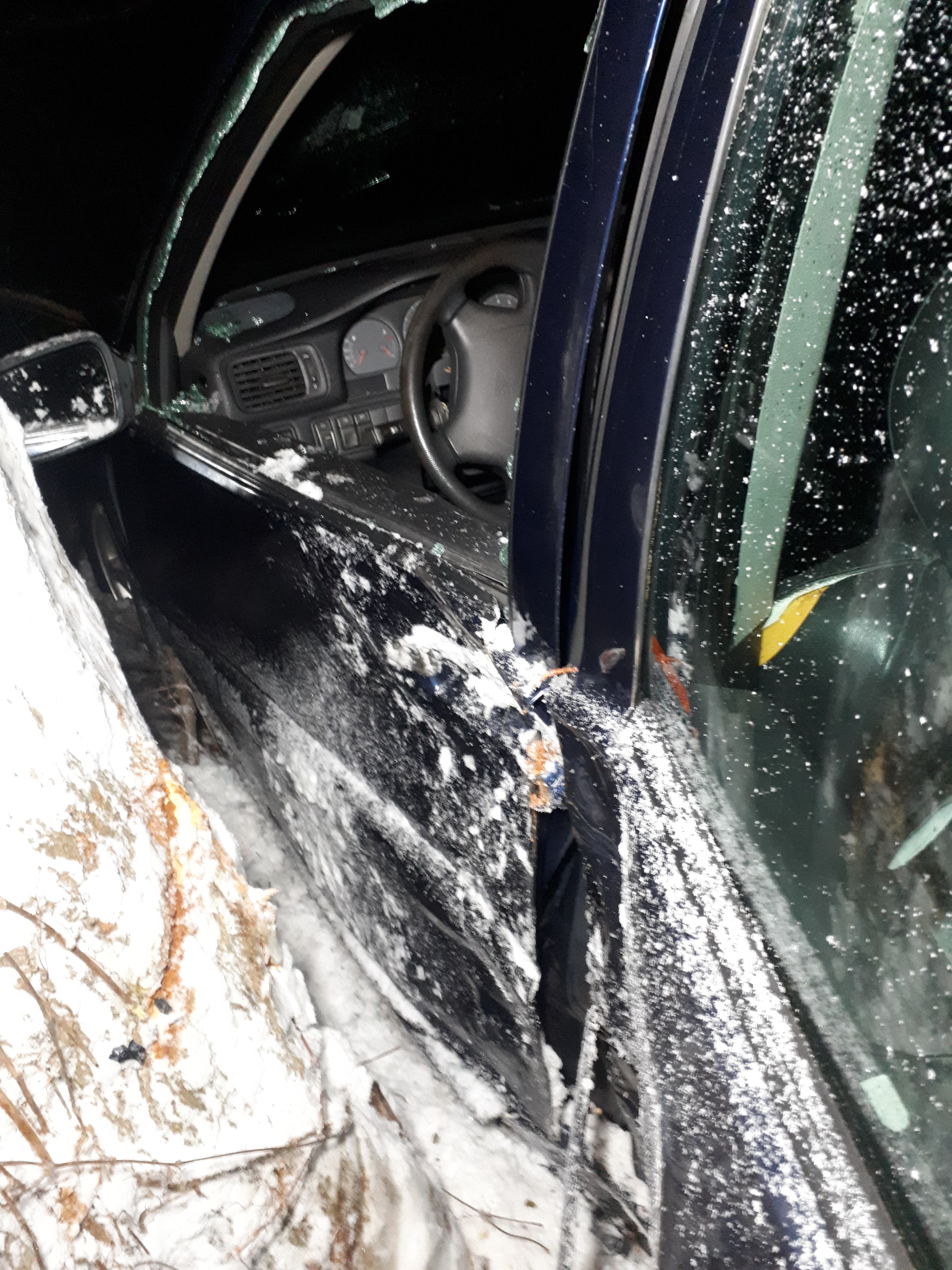

so a few weeks back i got into a fairly bad crash in the trusty v70 and i was very impressed with the SIPS technology. It was an icy road that i took a little to fast and ended up hitting the tree on the drivers door at around 60 km/h.
Came out with no injuries and better yet, my dog who was in the trunk came out walking. Crawled out of the passenger door and was shook up more then anything. At the time, all my mind could think of was that i crashed my favourite ride. Anyways, ive attatched some photos to illustrate the effectiveness of the safety that goes into the 98 v70's. The 99's have even more features including curtain airbags, and computer controlled side airbags. My side airbag did not deploy as the seat was not hit directly.
I

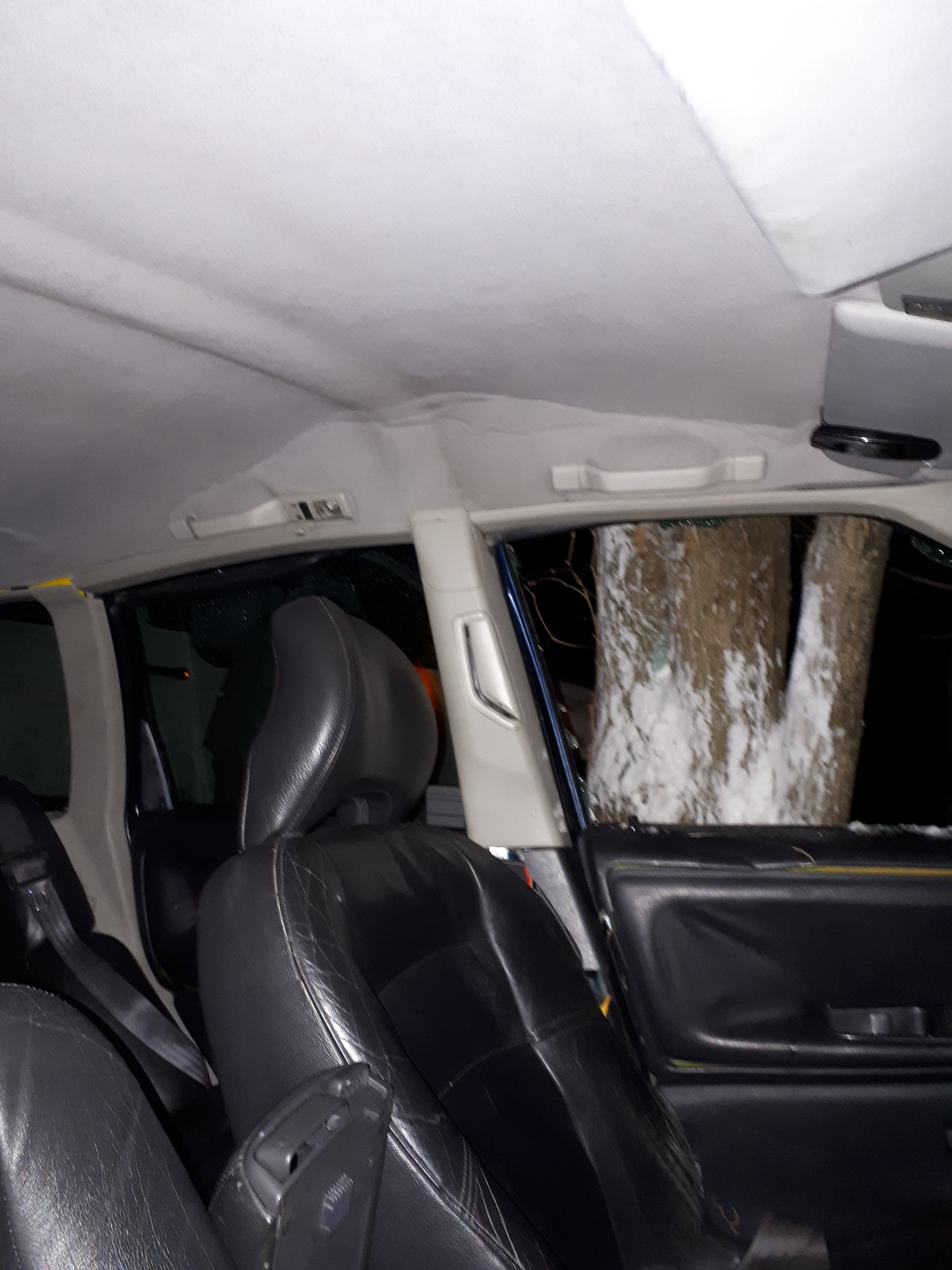

However, the seat did go off the rails and push about a half foot towards the passenger side which saved my back and head from any impacts. The B pillar was effective in transferring the energy away from my door and was probably the reason that tttshere were no injuries.

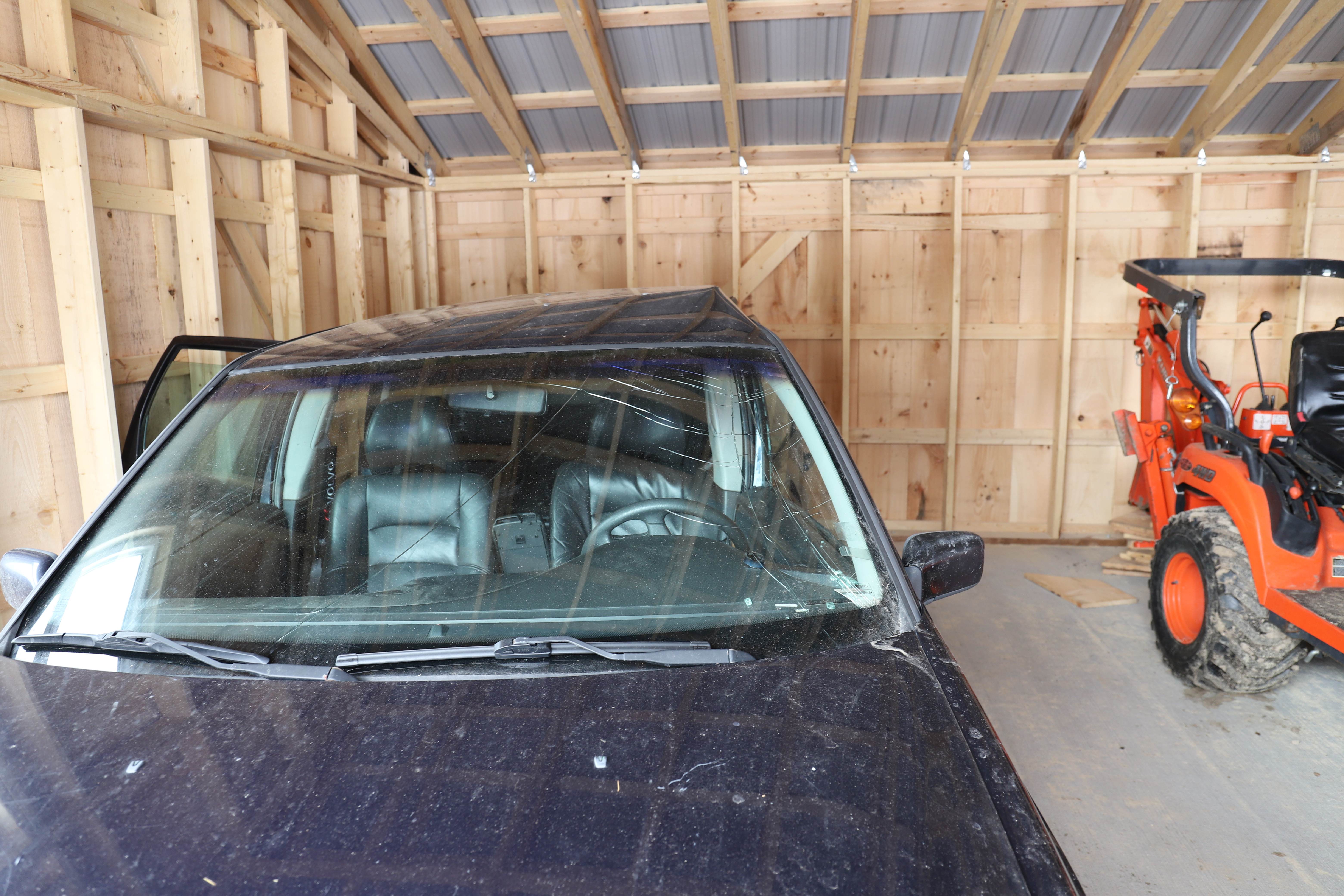

The car was and still is a tank, it still starts and drives which makes it a pretty good parts car.
Lessons learned were never cheap out on winter tires, and buy another volvo.
