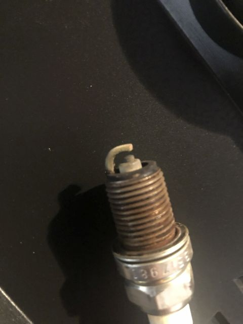

I pulled the coils and looked and it looks dry. At this point, I also decided to pull the plugs and make sure there's nothing unexpected there. They look used, but not horrible to me, especially since I have no idea how long they've been in there. In fact, I would say these look normal grayish white with very little wear for a plug. Opinions? These are the same plug in different lighting.

Oh, also did "glove test," and ever so slight suction, which I interpret as good.
