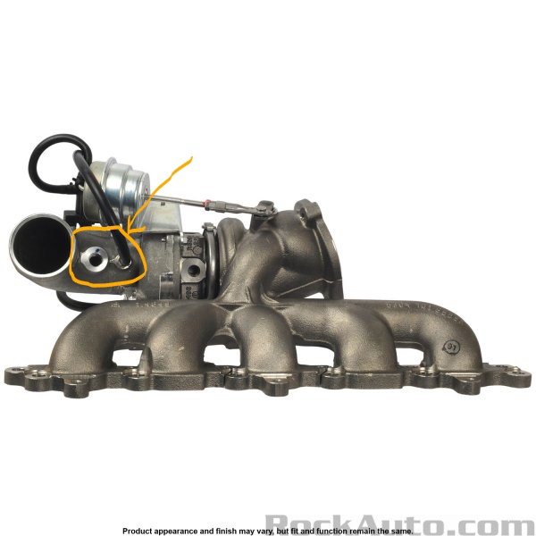

On the turbo on P1 models is a check valve fitting that is supposed to let crankcase pressure in but vacuum lifts the ball and seals it. The check valve goes in the location circled on the turbo pic. The ball may be gummed up, lifted and stuck. Or the hose to it is crimped or obstructed.

Thank you so much Jimmy57! I think that is a really good lead. I have oil on the turbo, so it makes me think that there is an issue with this breather hose assembly. I believe this is the part https://www.fcpeuro.com/products/volvo- ... 24#fitment
I have ordered this from Volvo dealership to be delivered tomorrow and I'll try to take it apart shortly. I think it should be fairly easy to get to from the top of the engine with a crowfoot wrench and some persistence. Thank you all so much for all the support! Volvo wanted to spend "2-3 hours" of diagnostic time working on this because I've been working on it on my own. This system isn't that complicated, just takes a lot of trial and error sometimes...

Wanted to loop back with this thread and let folks know that I believe this issue is fixed! I replaced the check valve (it's harder than I thought, important to get a internal snap ring pliers) and took it for a test drive with my manometer set up. It still goes above and generates positive crankcase pressure, but to a lesser degree and only at full boost. I believe this is likely normal, atleast for a car with 172k on the engine. The good news is that no seals have popped out all week and the engine is dry. Now to do a deep clean of the engine bay after all that oil getting thrown around before! Thank you all!
