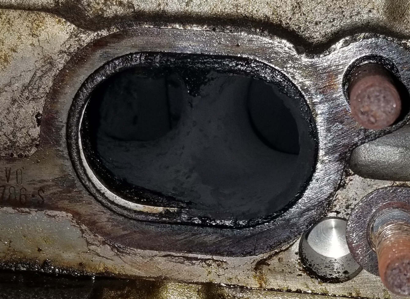

I was working on Herman (link in Signature) this last week, and found that the #5 cylinder's exhaust valve stem seal is leaking. Just looking at my options here. I'm sure there are things I haven't considered.

Atp is already in the oil. 8) There was a large build-up of oil in the exhaust port. Only noticed it because I had to remove the exhaust manifold and get it repaired. :D
