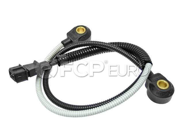

One on the front of the engine and one on the back of the engine. They look like this.
$168.07 that is why I say, check the wiring and connectors first.

Oops, not even close.RickHaleParker wrote: ↑02 Mar 2020, 21:08 ... One on the front of the engine and one on the back of the engine. ...
Both knock sensors are on one side of the engine, under the intake manifold. Checking the wiring is a PITA without removing the IM but you can do it. Easier on an NA obviously. I wouldn't bother if the codes don't recur but keep it in mind as something to eyeball during that next PCV job.
Don't sweat that high price tag for new ones. The junkyard is full of knock sensors and they are all working just fine. It is just a simple microphone, the sensors don't go bad but the wiring can.
