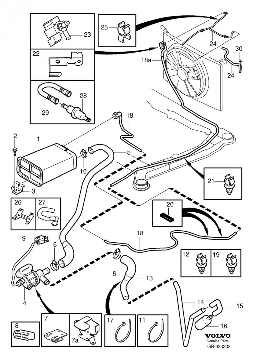

I found this diagram from another forum, the poster said it was for a xc90 but didnt say what year.
I cannot find item 4 which is the canister shut off valve on my 2001xc70, if you find it please let me know where. thanks
Oh and apparently there was a recall on these canisters
