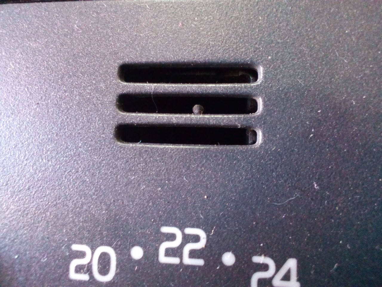

If you look closely there should be a what looks like something stuck in there (temp sensor) between the fan and the grille. I first tried to dig it out thinking it was dirt (oops), since you blew on it and the fan stopped you can try using a vacuum to clean grille or take it apart like i have and given it a good clean and inspection. I noticed mine staying on but not more than a few minutes after engine shutdown.
This maybe the temp sensor for the cabin ambient temp reading, do you have something OBD2 to check this value ?
