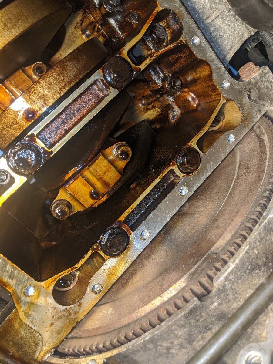

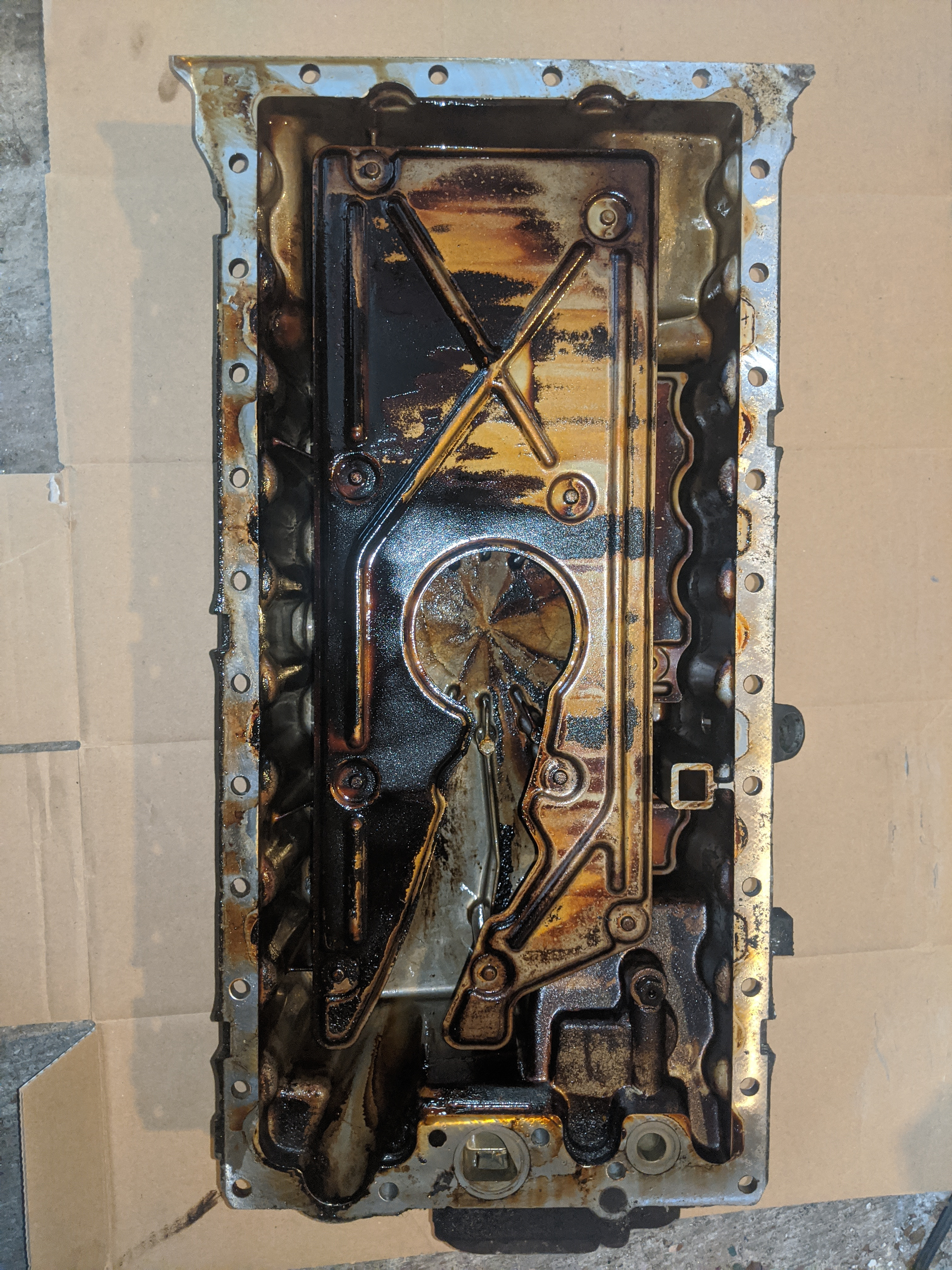

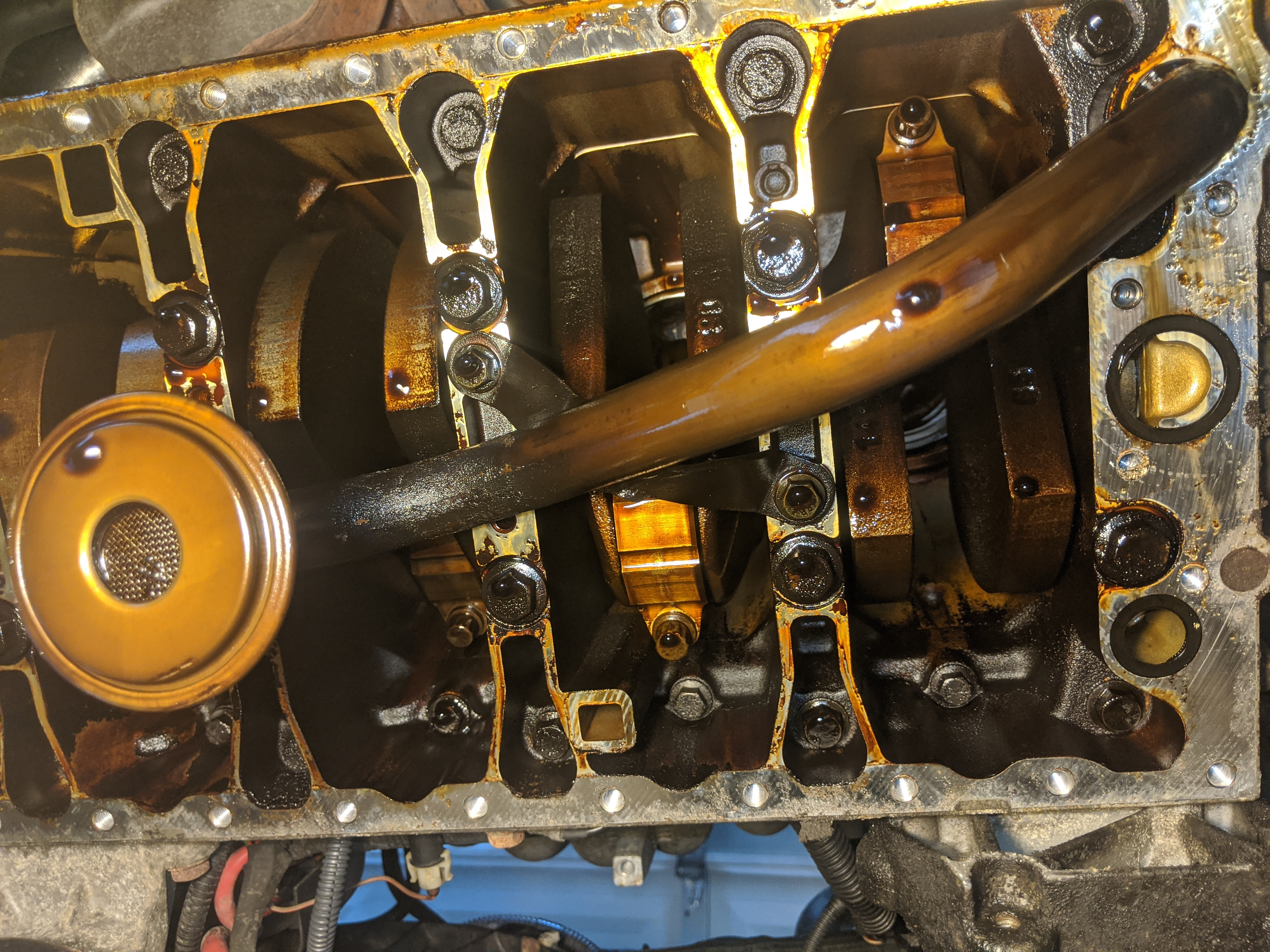

I've pulled my oil pan to replace gaskets and reseal it up. I'm in the process of cleaning up the pan but I was wondering if anyone could give me some opinions on the bottom of the block. How does this all look? Should I try to clean anything off from under the car (I have brakekleen and nylon brushes) or would I cause more harm than good?
Is there anything else I should check while I'm down here?
This is off a 99 na m56 with 212k miles. Up to 185k miles it was owned by an engineering professor so I believe it got regular oil changes for most of it's life. From 185-205 it was a highschool car so I imagine it was a little neglected during that period.

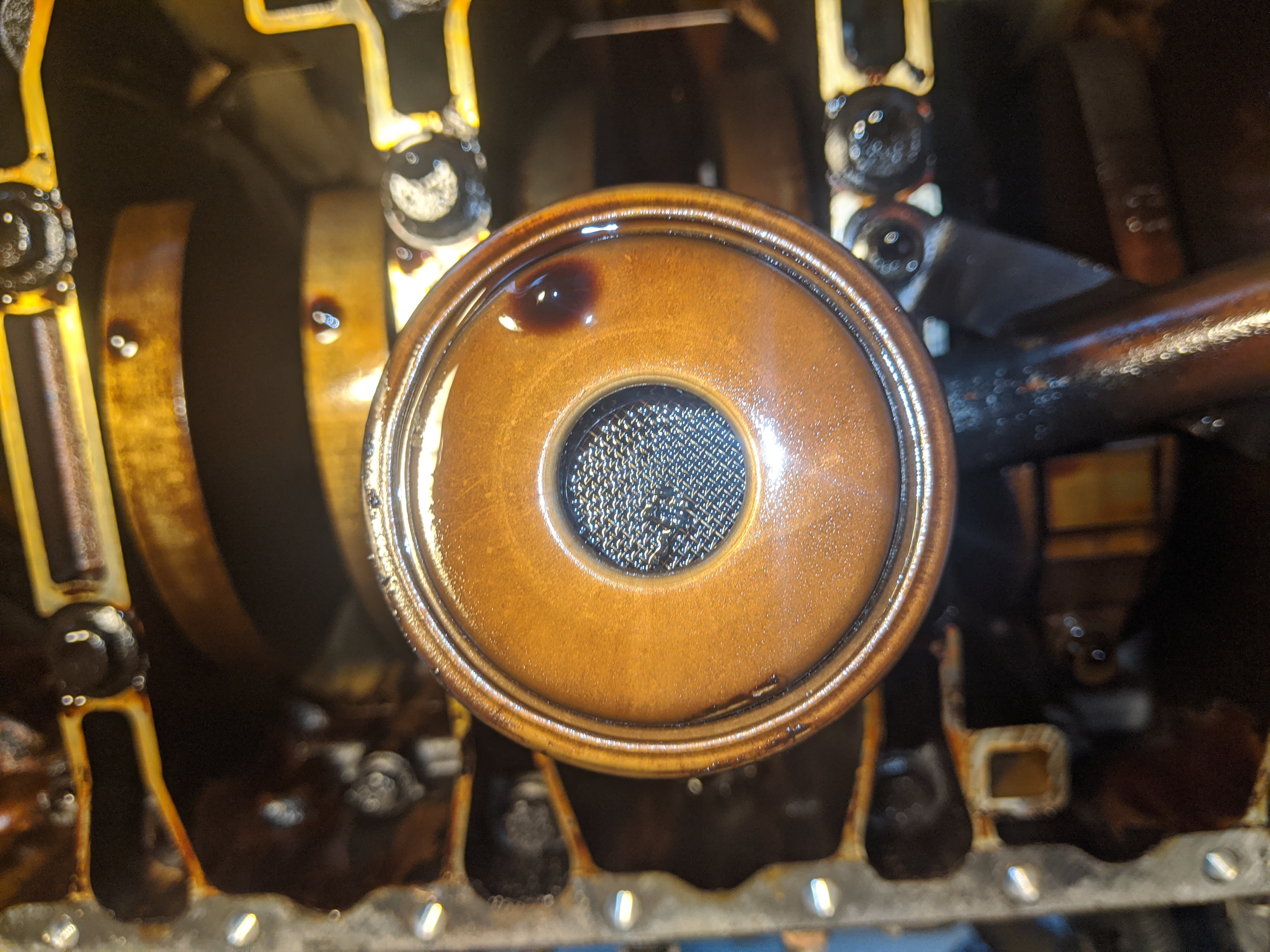

Doesn't look bad for the mileage. I wouldn't worry much with the light varnish on most surfaces. If anything, I would remove the oil pickup tube and clean it as thoroughly as possible. If that means the sink with dawn and then the dishwasher, okay, A local machine shop for a quick spin in a parts-cleaner? In the engine rebuild thread from way back, people did amazing things to their oil pans and windage trays with simple cleaners, brushes, and time.

Is the engine still in the car? If you have access to it, and all the stuff on the front of the engine is off, it is worth cleaning the oil return tube from the PCV catch tank to the oil pan. It is difficult to do from the front of the car when doing the PCV clean as it takes a hard turn downwards. Worth checking it is clean if you can.

You can see the oil return tube in the pics, looks very clean in both the block and the pan. But I agree!

Thanks guys, good to know it's in decent shape. I got the pickup tube down for cleaning and it seemed pretty good but I did find some metal shavings in the screen. Maybe that's also normal for this age?
