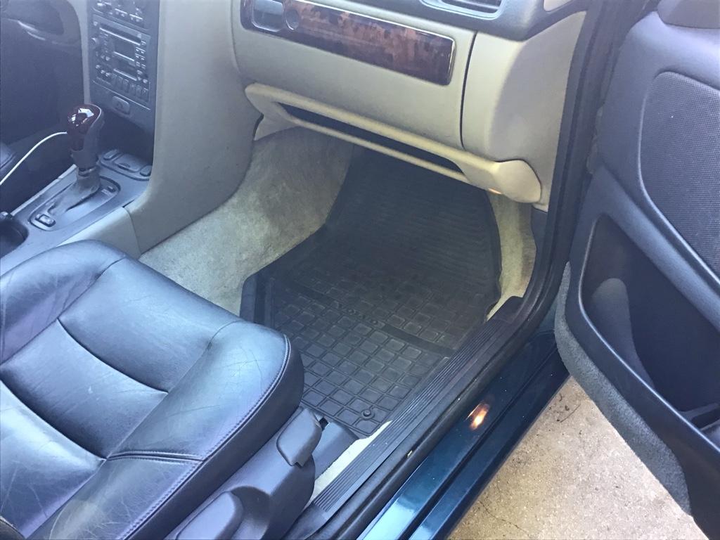

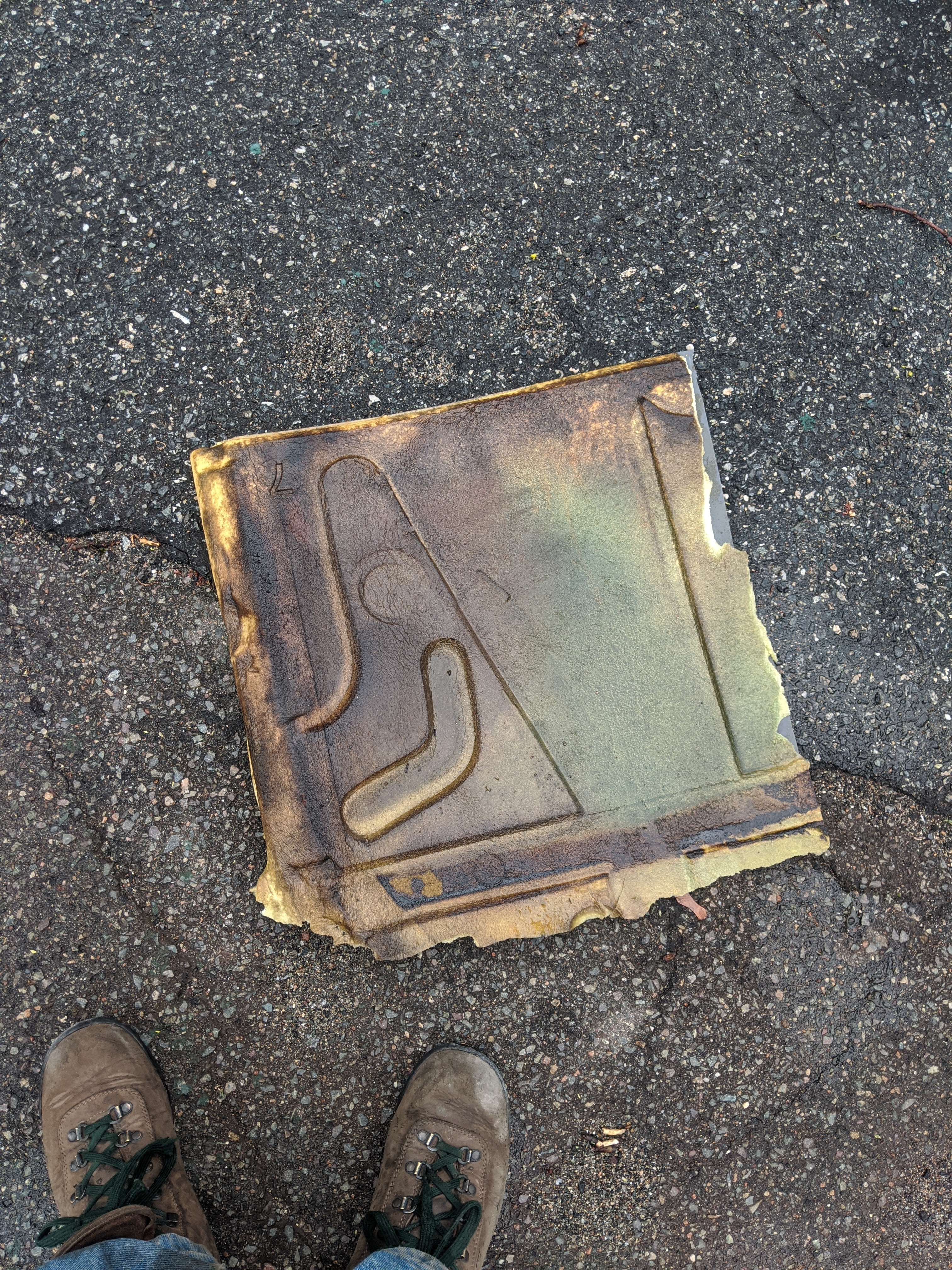

I experienced same issue with my car... previous owner changed the heater core a few years ago and never dried the passenger floorboard. I only noticed it a few weeks ago when I was installing an amp I picked up. I cut out the foam and took out the carpet... soaked with water and let hang dry for a few days in the sun then reinstalled the foam with tape. It’s dry now, so good enough for me.
