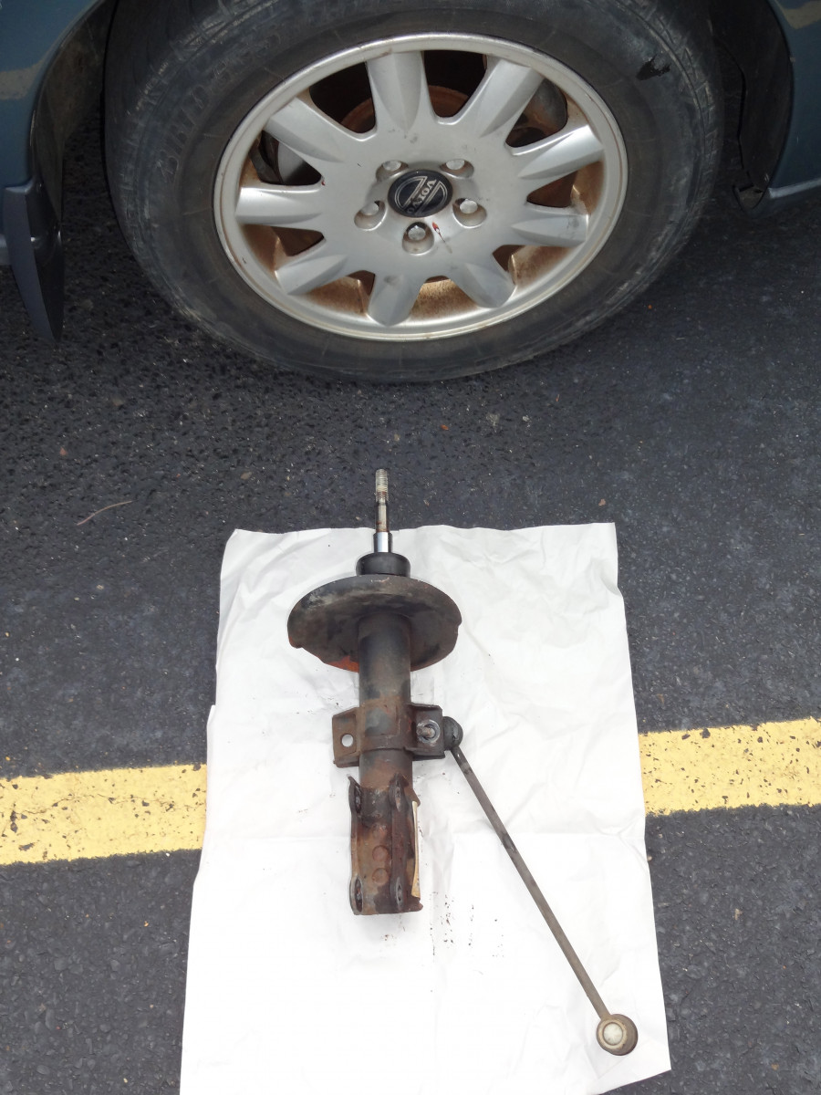

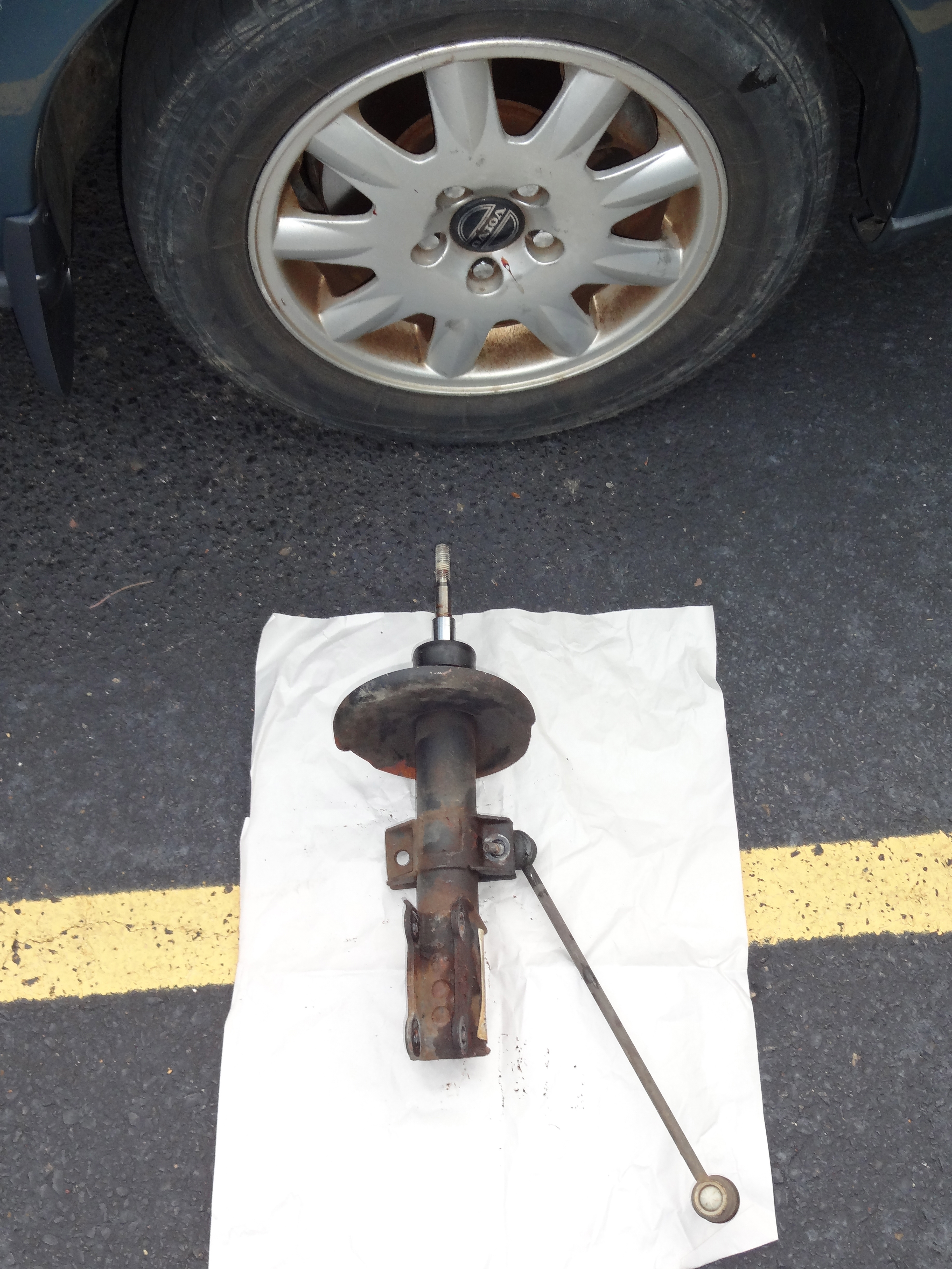

I will advise you to get some thick cloth tape and place a 10" strip across the very top of the wheel well. Believe me, when you go to set the strut in place you'll be watching the lower end and may very well scratch your fender's paint. My friend kept his eyes open and caught the top of the strut before I damaged the paint.
One of my '02's struts had ZERO dampening power. It's the one in the lower picture. It wouldn't even extend out of the car. The other was oozing smelly thick oil. You'll have no problems and will be amazed with the improvement.
And yes, that's blood on the wheel. No sacrifice too great.....
