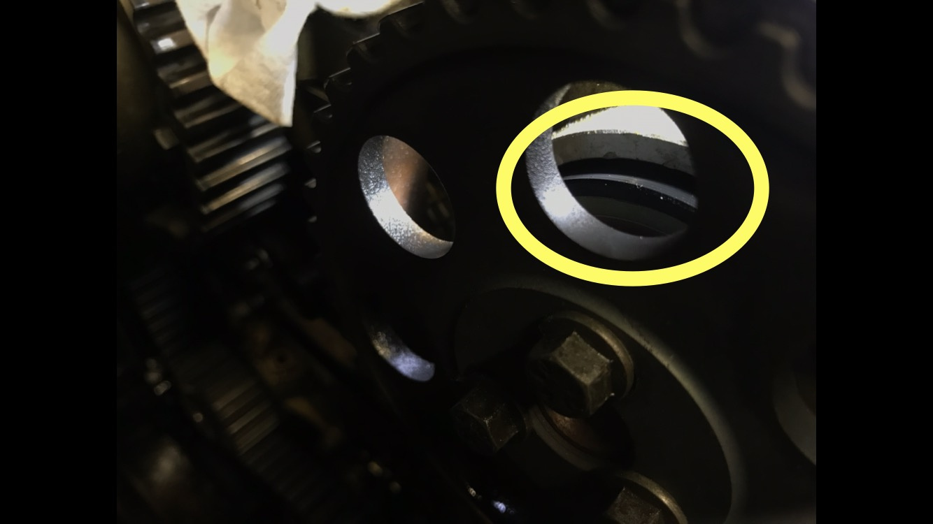

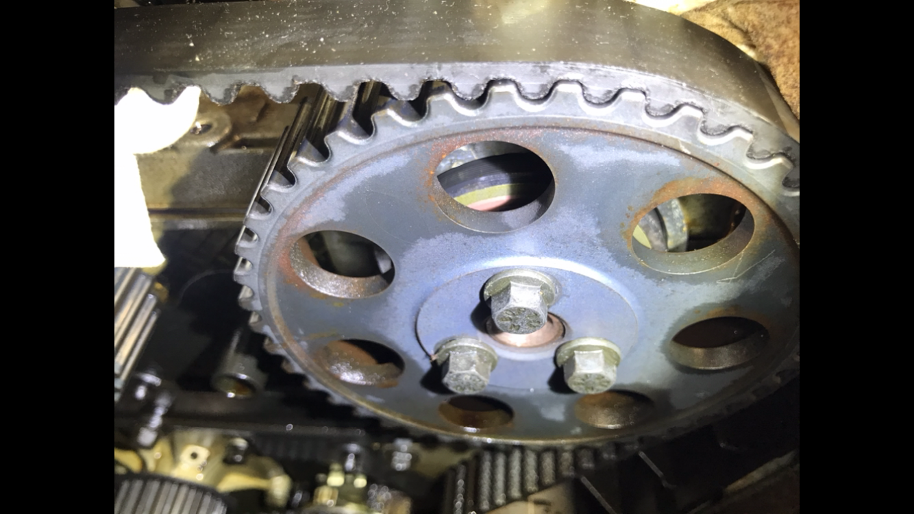

Have a peek behind the timing cover. What you’ll likely find is a front cam seal that’s been pushed out of its confines. If yours is a single VVT (exhaust), you might see something like this. Looking through the holes in the cam sprocket, you’ll see that the (front, intake cam) seal is pushed out of the head/valve cover. There’s also a chance it could be your front crank seal, you’ll just have to do some digging to find it.
