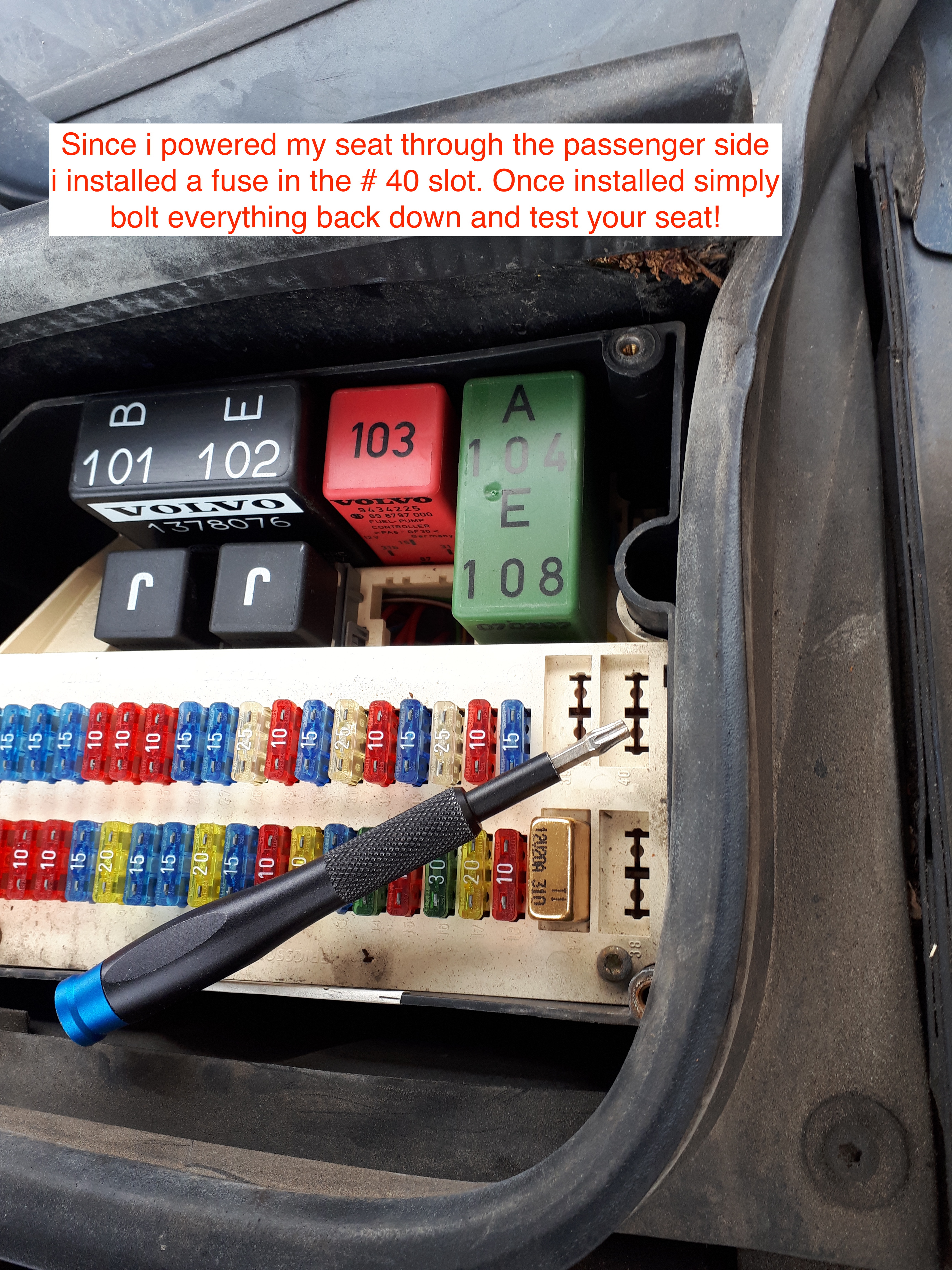

Fuse 40 = passenger power seat
Fuse 39 = driver power seat.
Note I just routed the wire under the passenger seat and to the driver seat. You can put it under the floor, however i just put it as close to the centre console as possible. I zip tied the excess wire to the moving part of the power seat.
Conclusions: If you do not have the driver side wiring then do not sweat it, get the connector and tap into the passenger side wiring. Alternatively you could try the accessory connector, and wire power directly from there.
I disconnected the battery before doing all this and had no issues.
