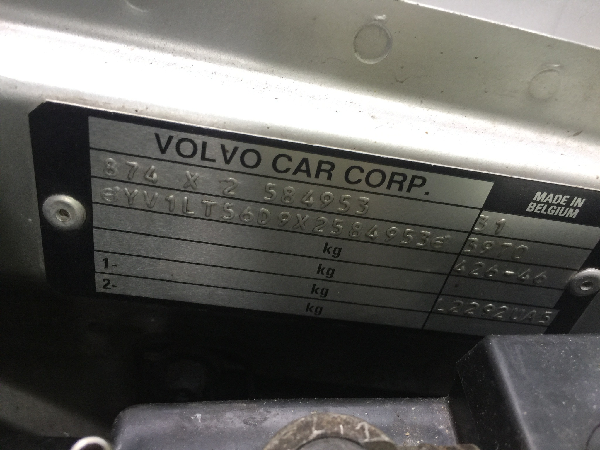

Nice sedan in silver 426 and Graphite 3970 interior
Build date 10/1998 in Ghent
VIN 584953
143050k= odometer July 2020
Ariane 15 wheels

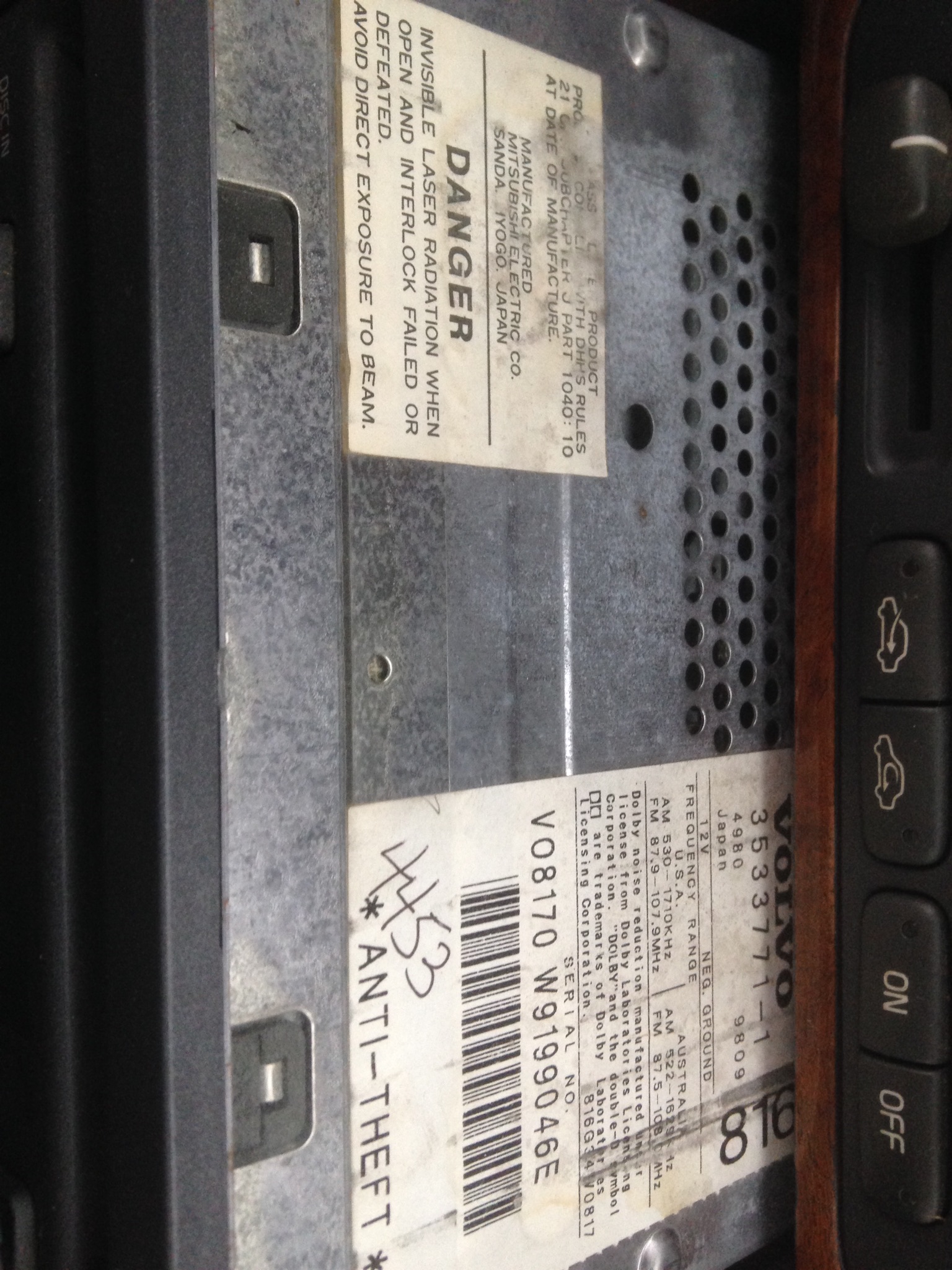

Radio code 4453

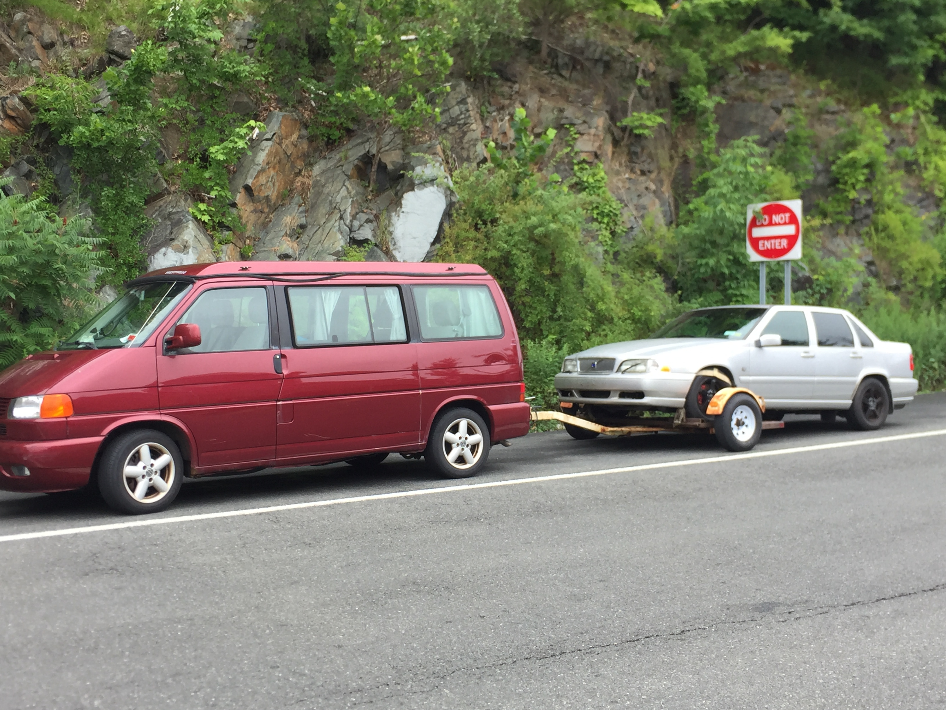

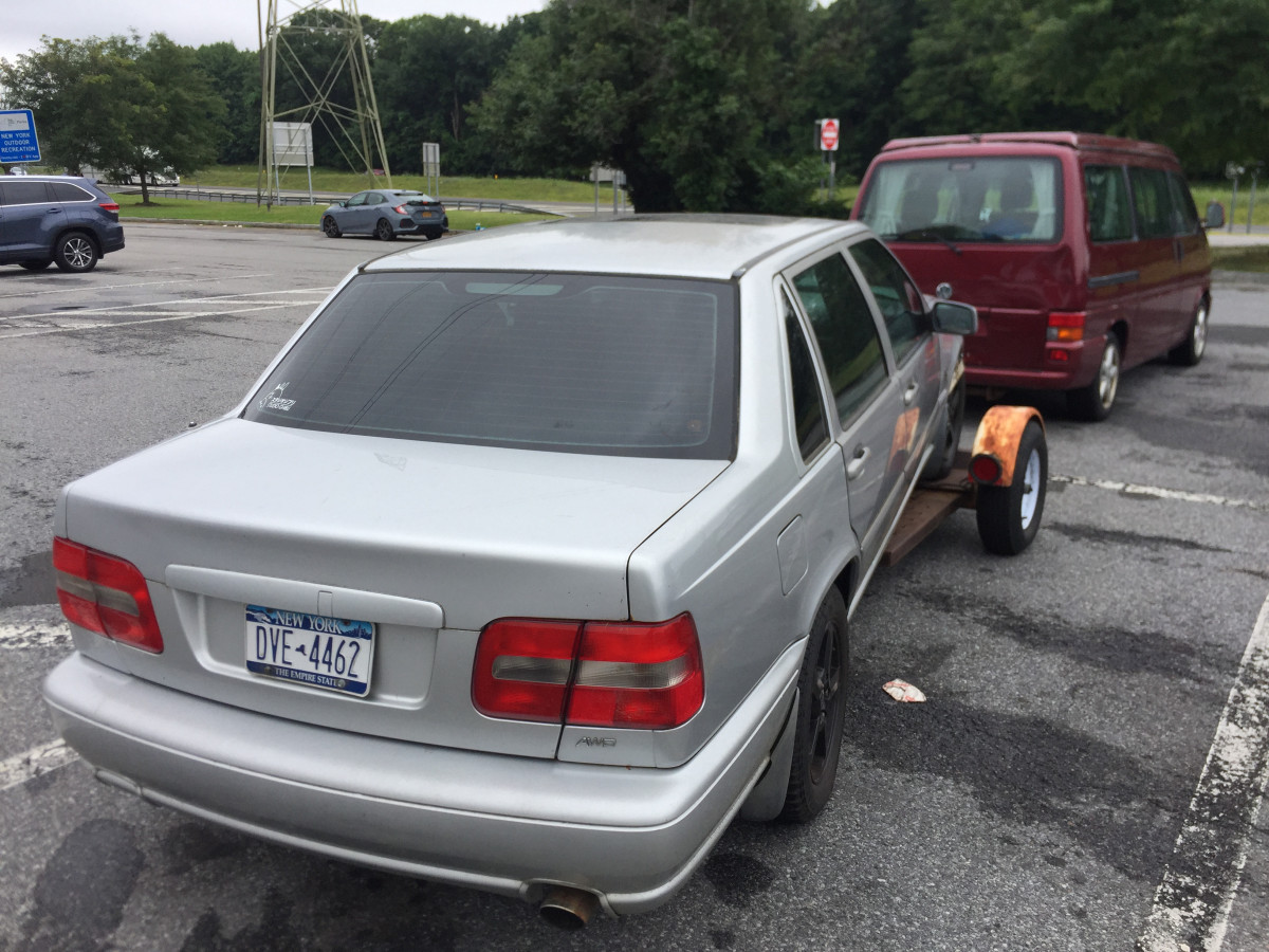

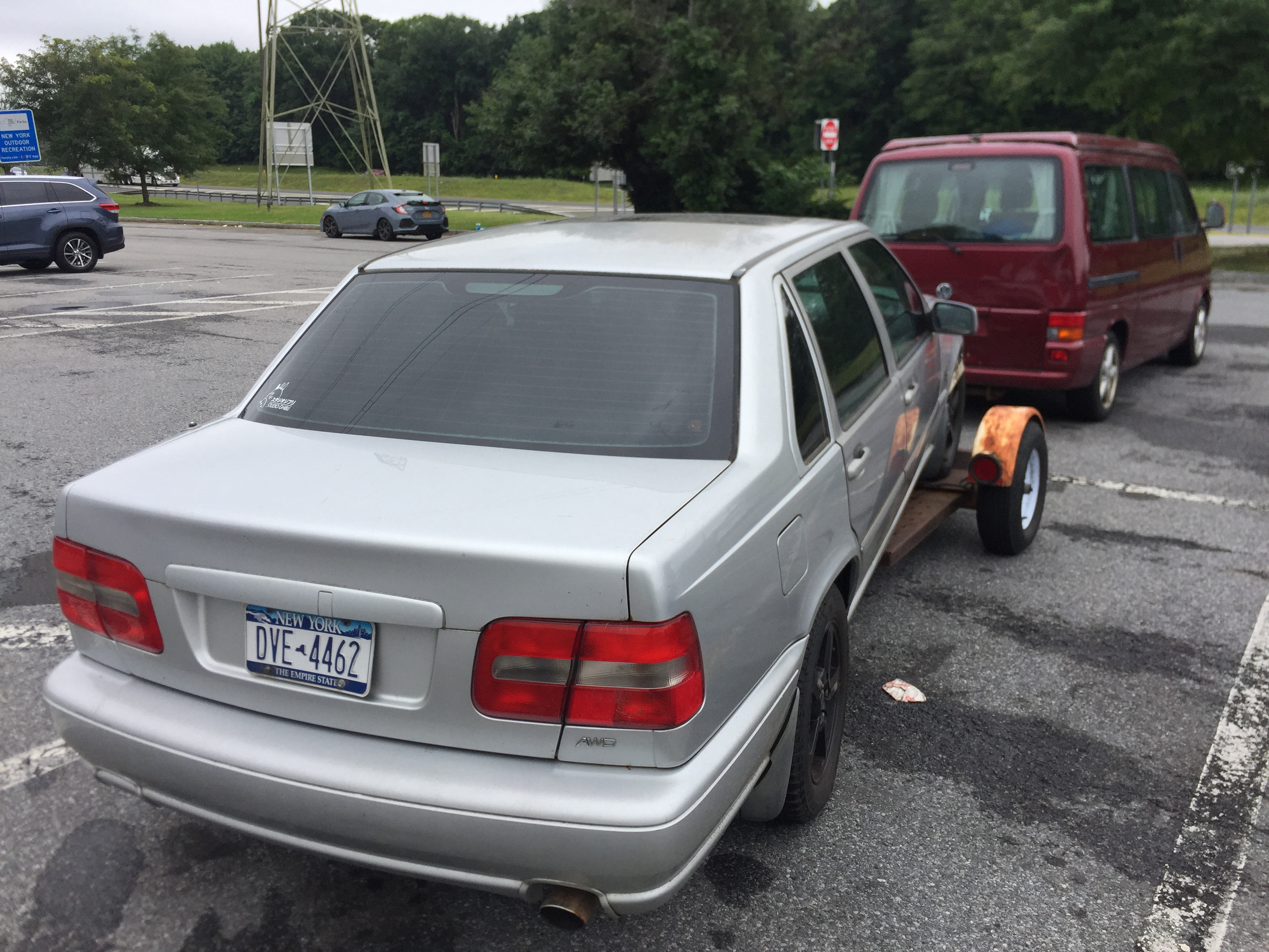

Removed drive axle for tow

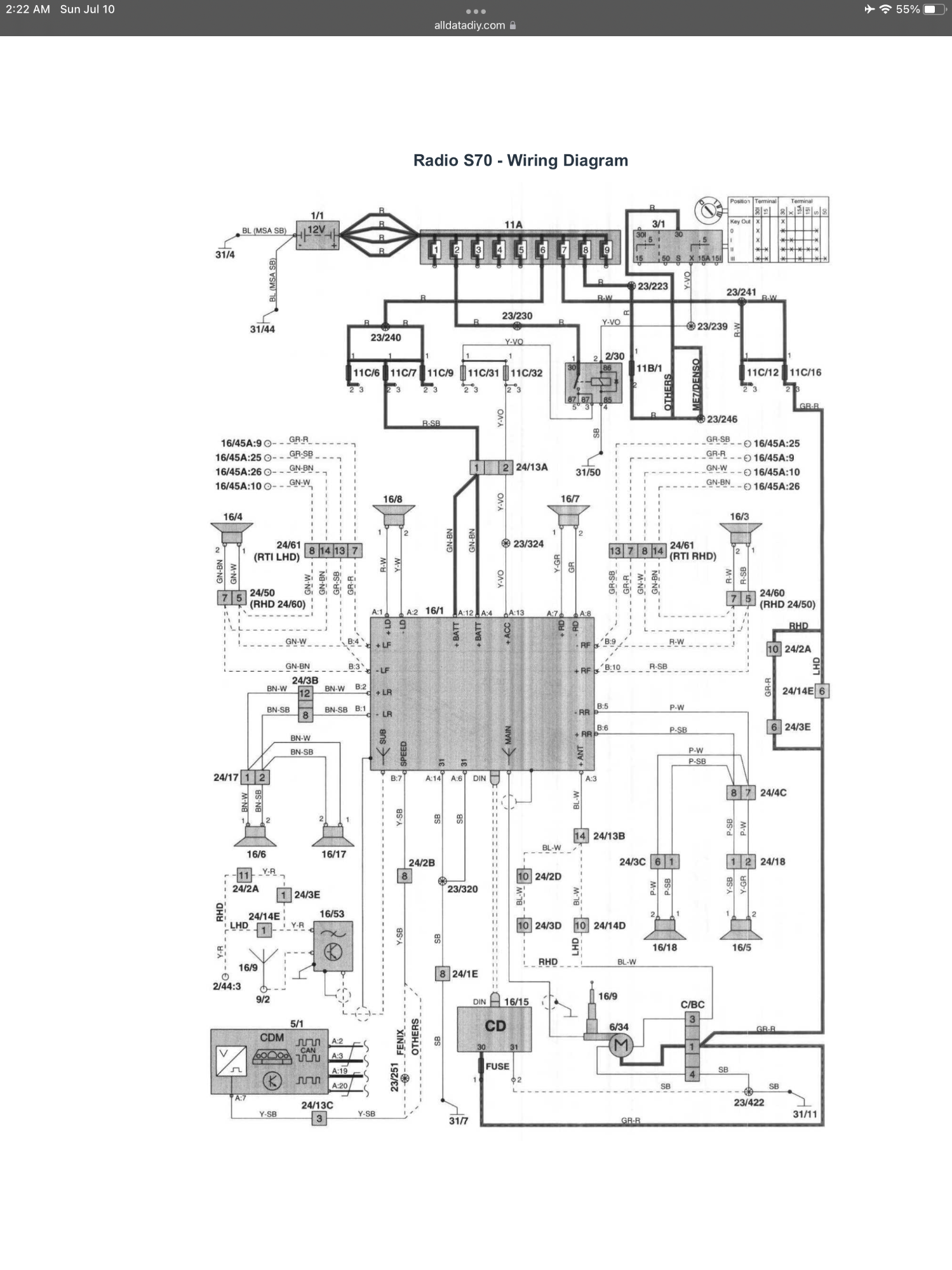

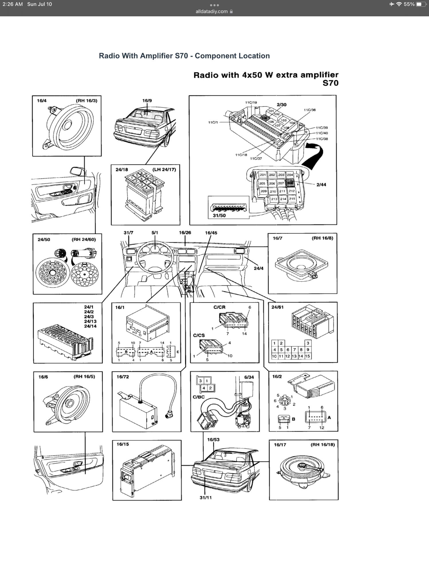

Stereo and amplifier wiring diagrams
- B33C6202-9F8B-4CBF-A1D2-7E18F1C81EF8.png (769.31 KiB) Viewed 3629 times
- 3D934C8E-9FBE-4754-8FD1-6ED22ECD69A9.png (1.02 MiB) Viewed 3629 times
- 5911C5C6-C622-489E-A67D-F0D5DE50670E.png (800.46 KiB) Viewed 3629 times
- 8D771589-B0B7-4928-97E7-2A390D025026.png (982.48 KiB) Viewed 3629 times

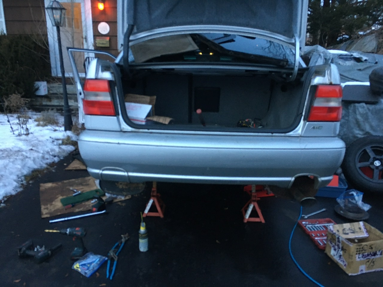

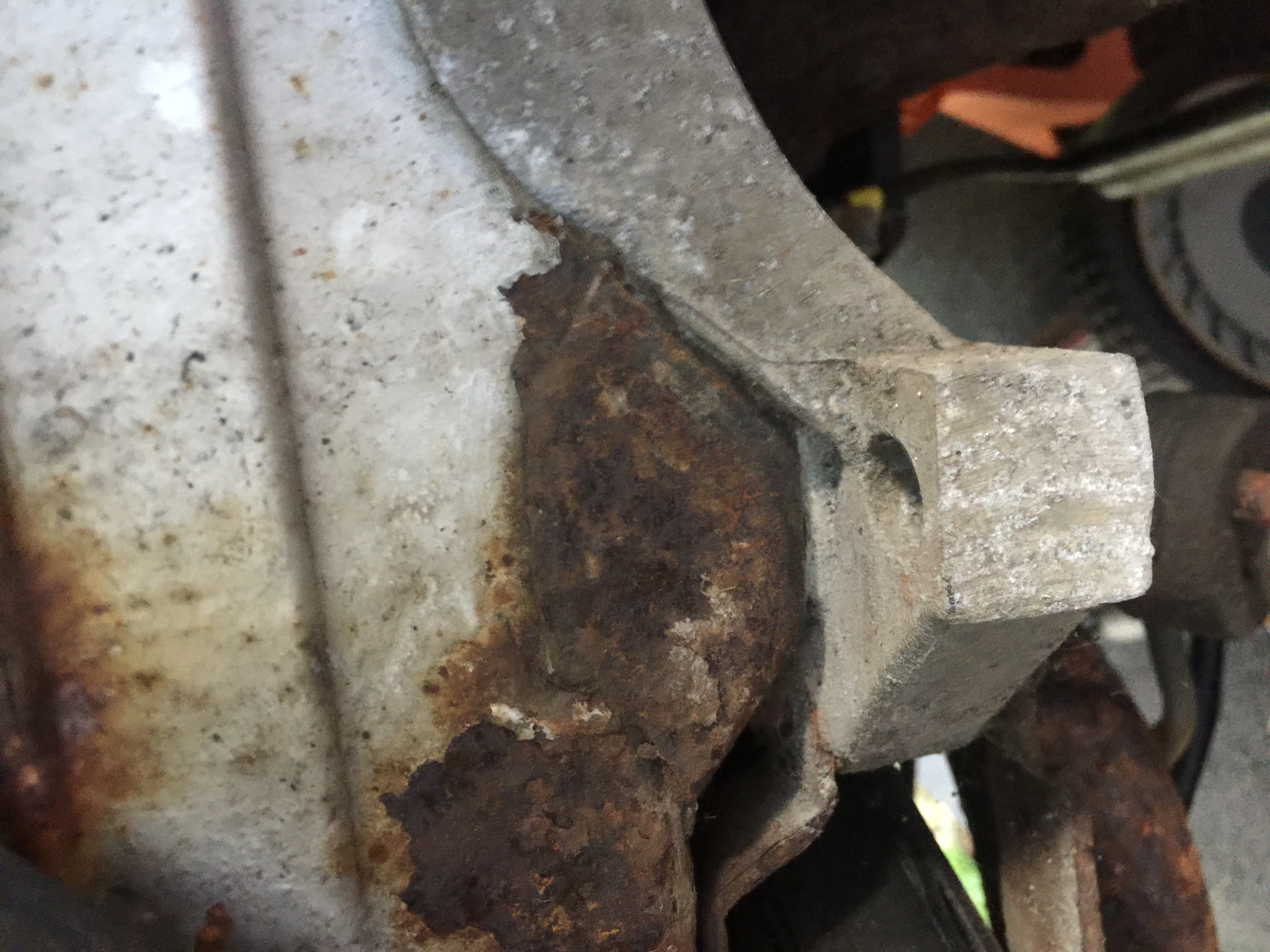

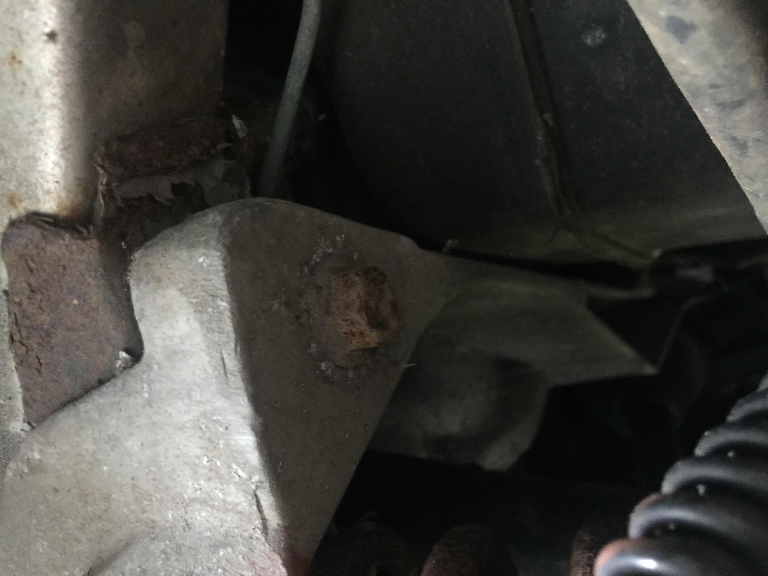

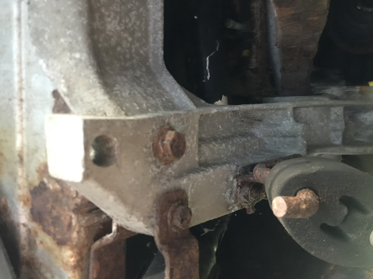

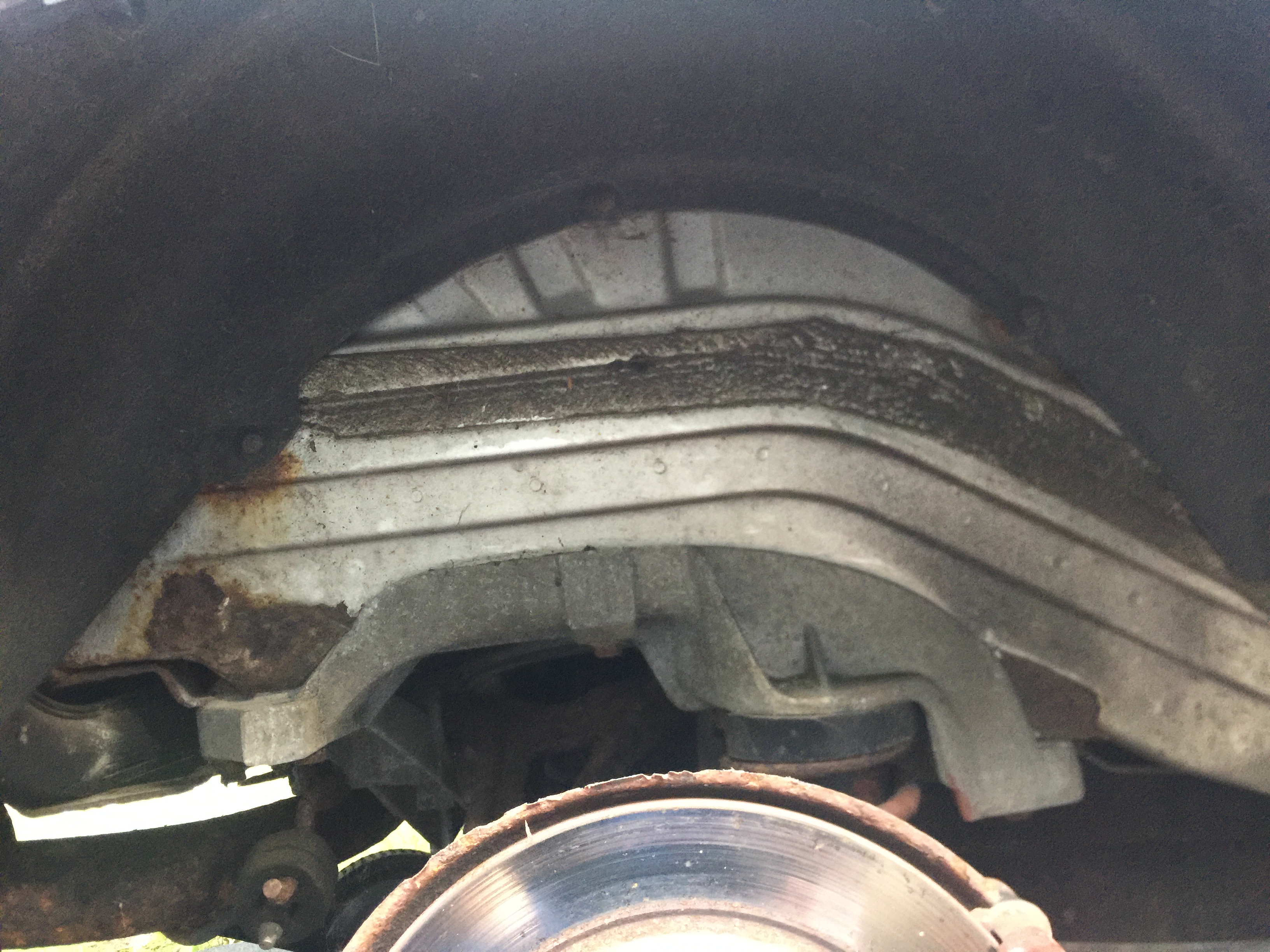

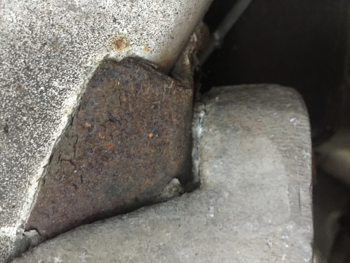

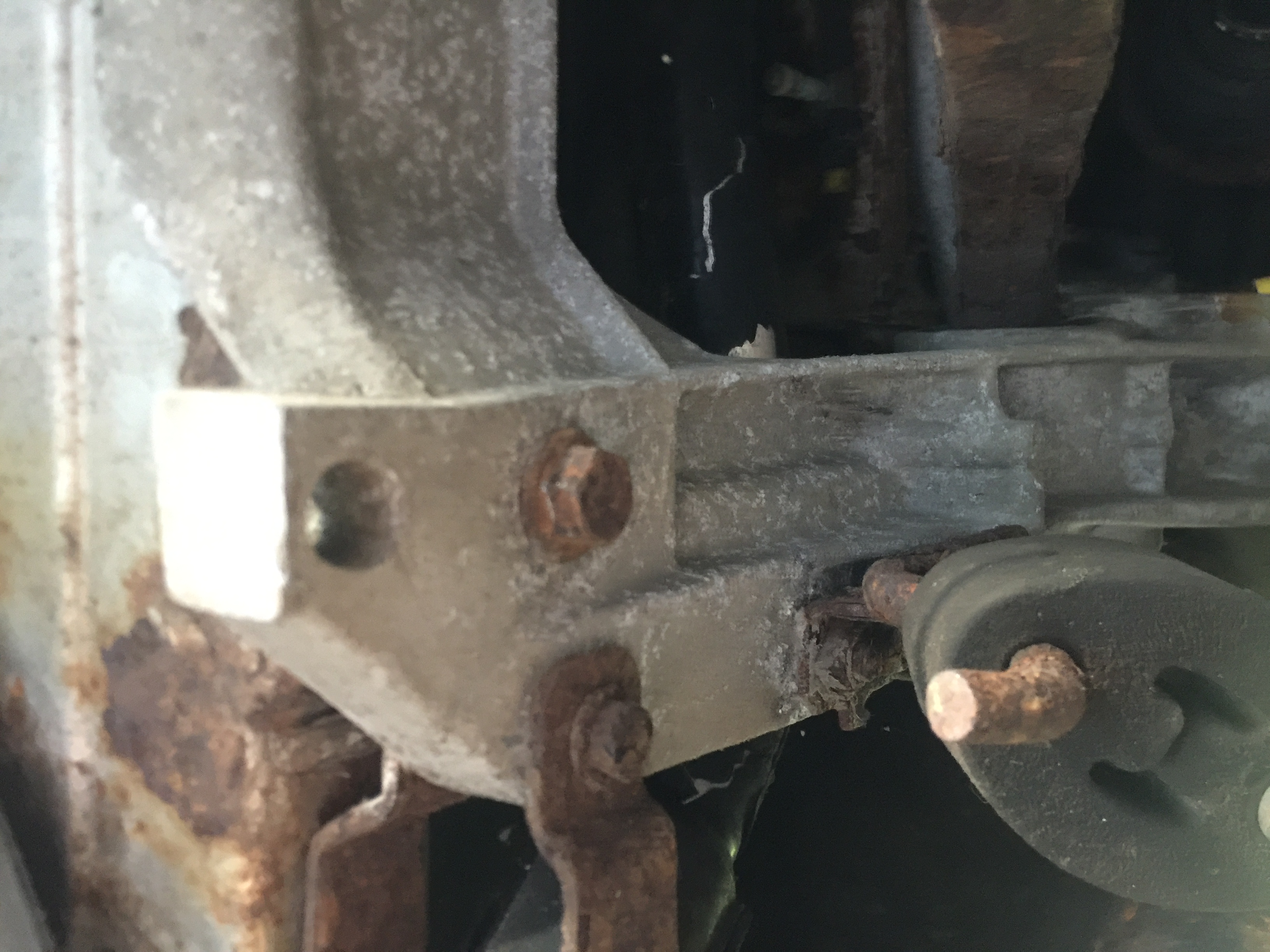

Spent 1, 3,5 minute propane head on subframe bolts. Won’t move even with a 5 foot cheater
Mi can feel the elastic nature of the 17mm hex head bolt

Need four pieces large bolts 949793 17mm head
Two pieces 985049 M10 x 40 mm flange screw, 14 mm head

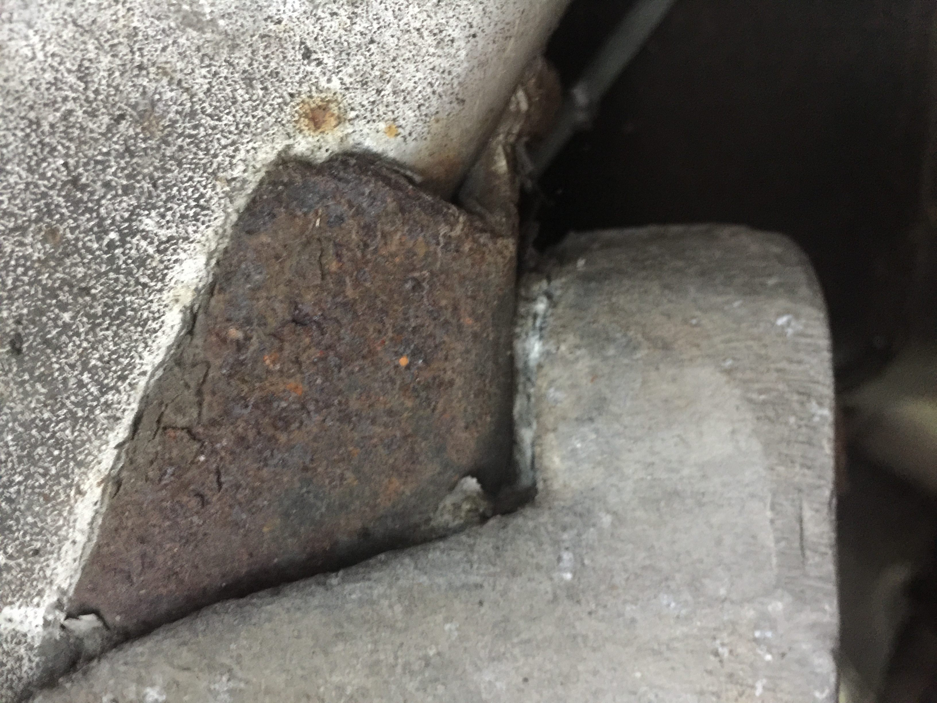

Impact driver is possibly the only way to go. I tried the old brute force but only succeeded in breaking most of the bolt heads off.
If it helps, when I broke the heads off, and pulled the sub-frame, it was the concretion of the reacting metals that formed a glue between the bolts shank and the sub-frame. With the heads broken off and the sub-frame hammered and levered out of the way, I used a stud remover (one of those things that act like a pipe-wrench and lock on tighter the harder you turn them).
What I also did was to drill small holes above the bolts with a hole large enough to spray penetrating oil into on one of those small tubes you get with the cans. I let that germinate for a few days with more PB blaster and they then turned out fairly easily.
The sub-frame holes for the bolts were scarily enlarged by the reaction between the materials.

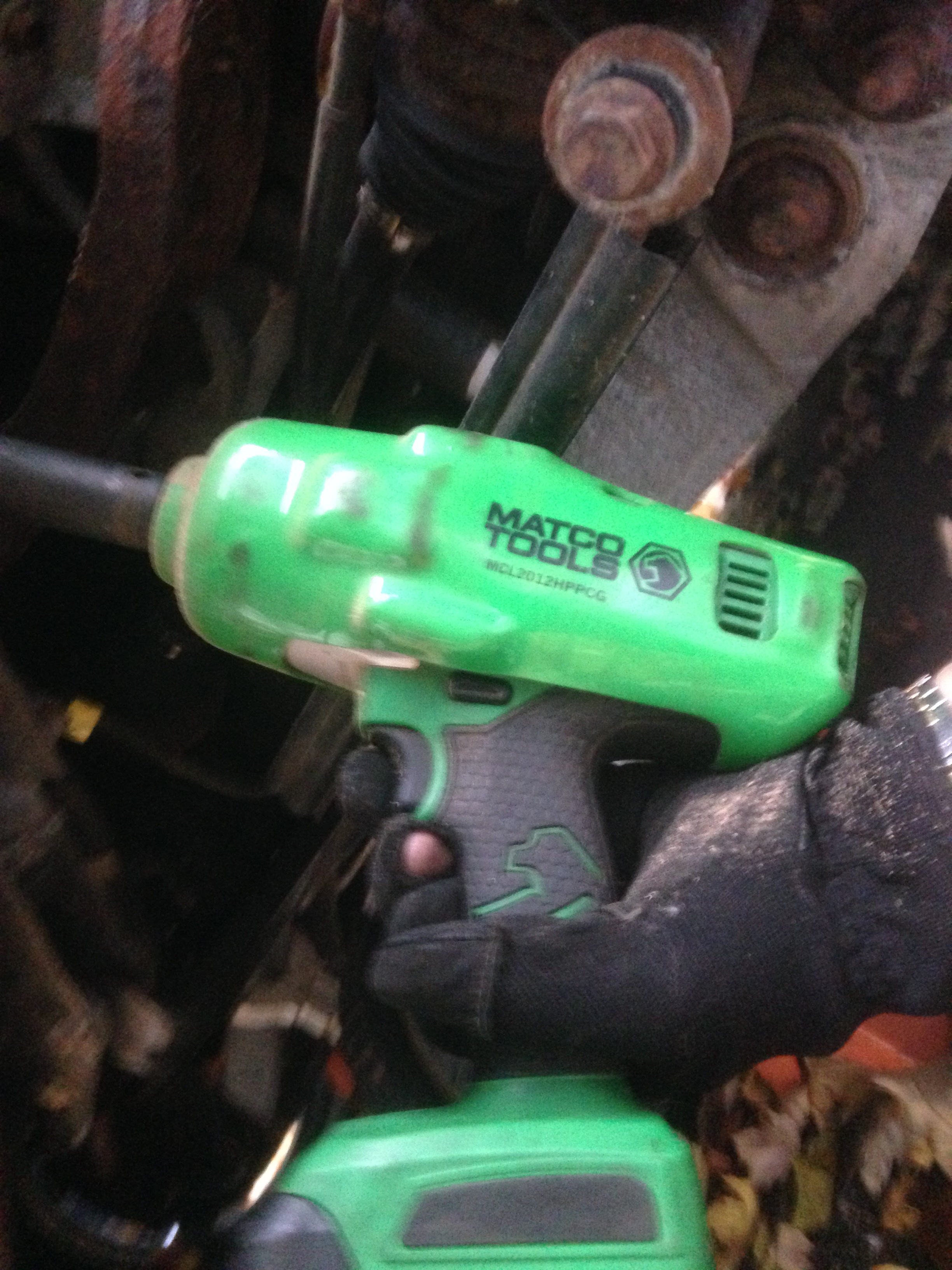

Got a serious impact rated at 1500 foot pounds
Brrrrrrap went those bad boys.

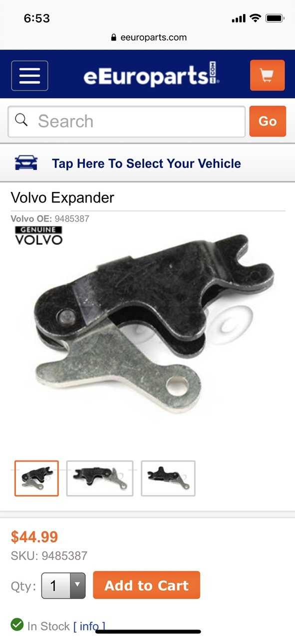

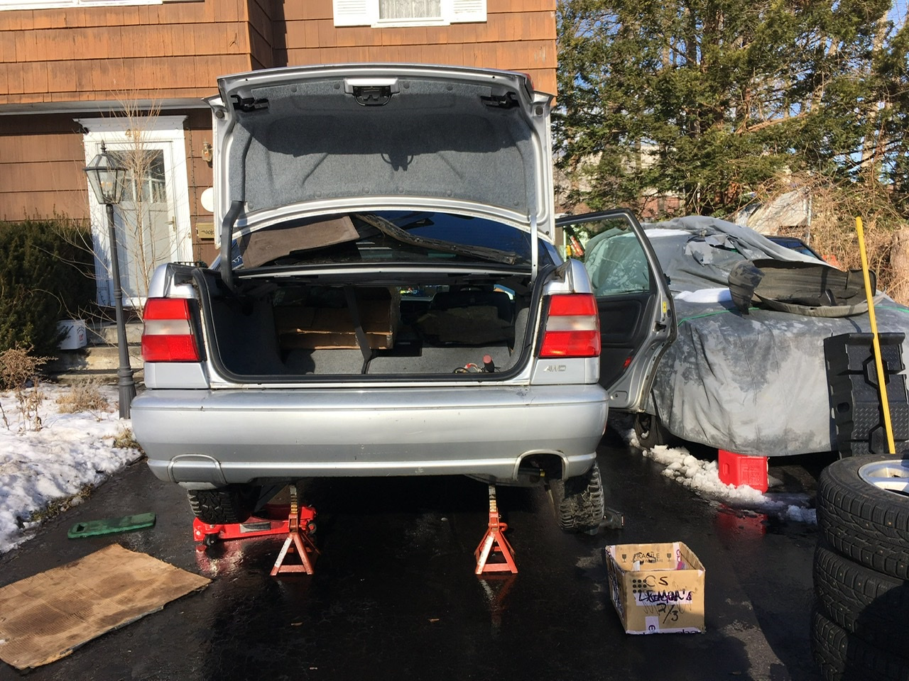

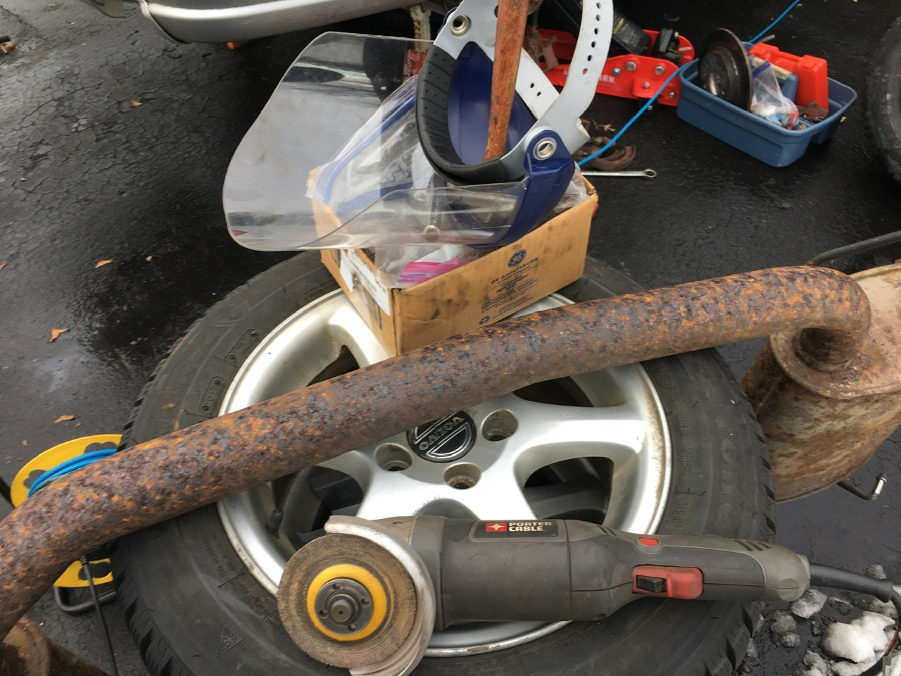

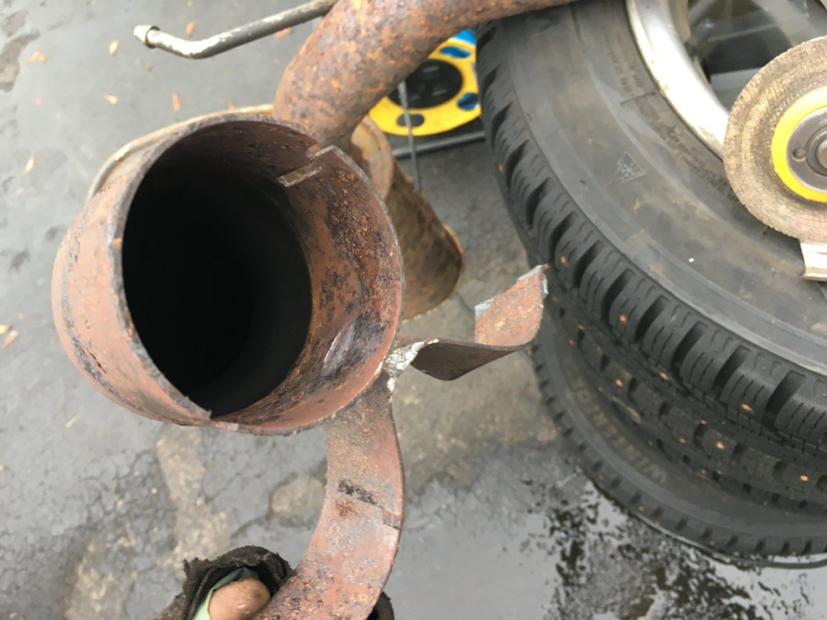

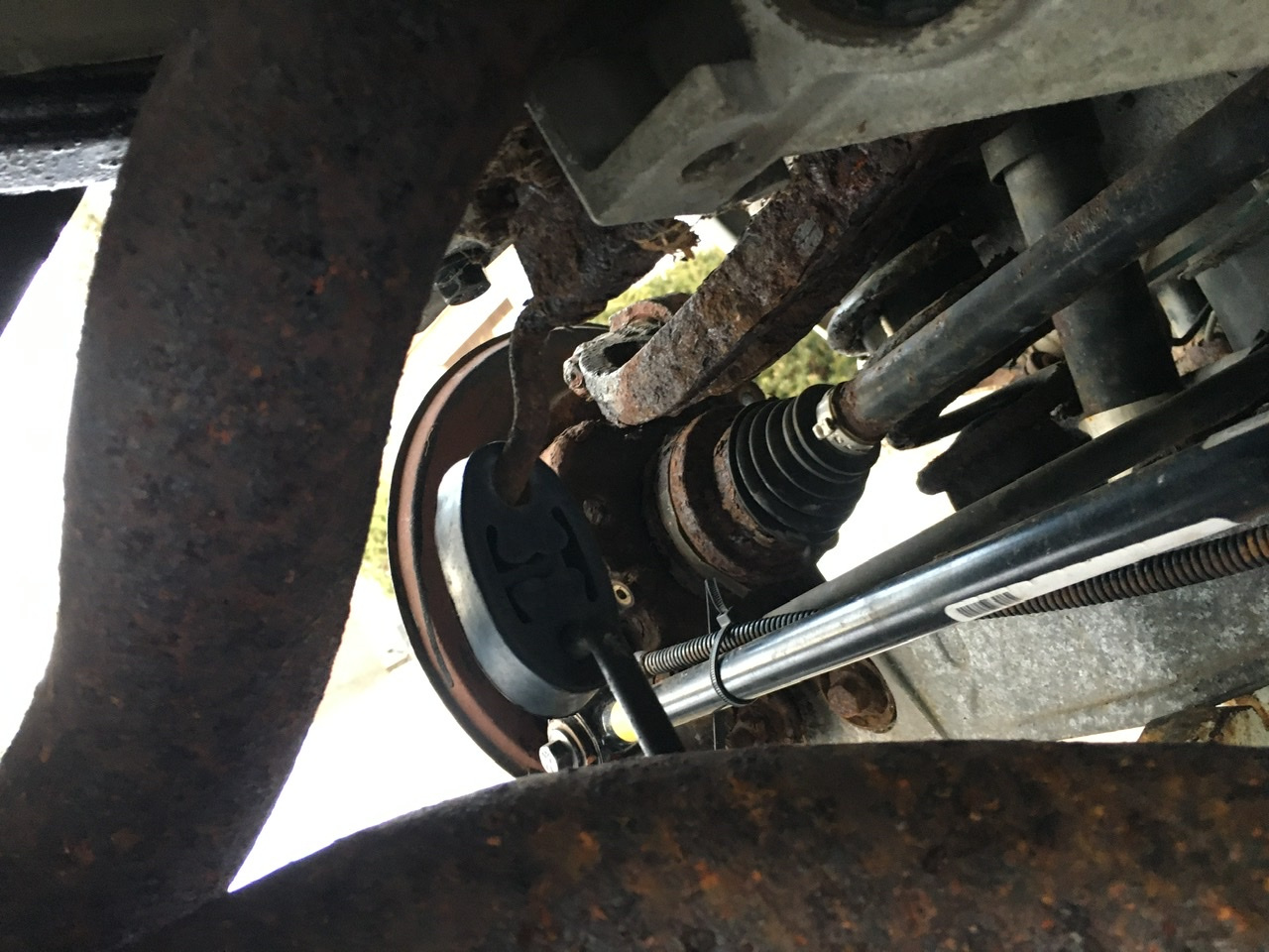

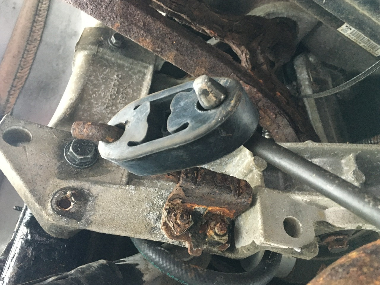

2022 work
Bridged fuel line to be resolved
Rear brakes installed, have to hook up left side fittings amd bleed
Need one of the expanders and new shoes.
Used battery installed
Needs fuel filler installed

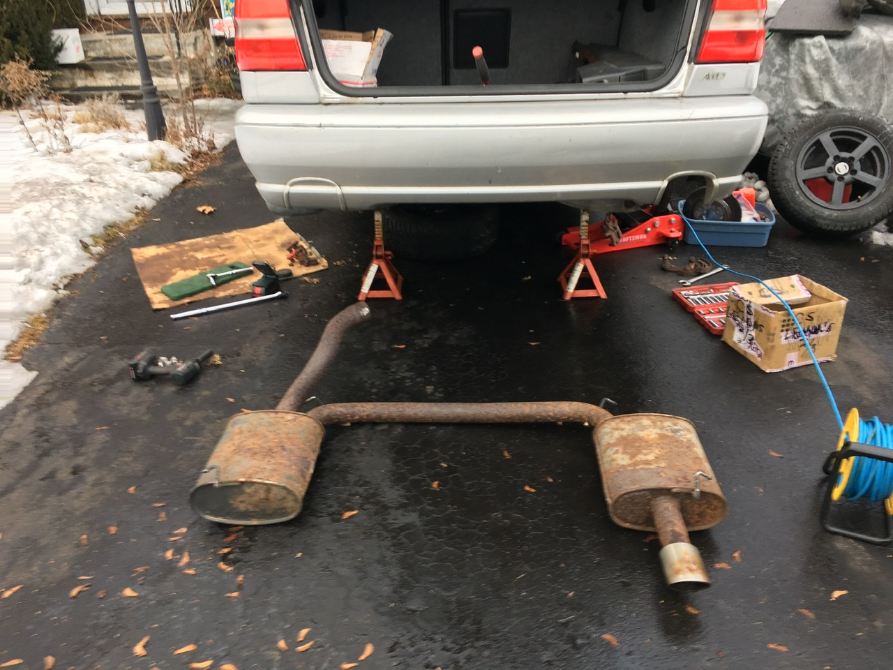

Needs rear exhaust installed, clamp
Abs install and test
New screws here.
posting.php?mode=edit&f=1&p=310520

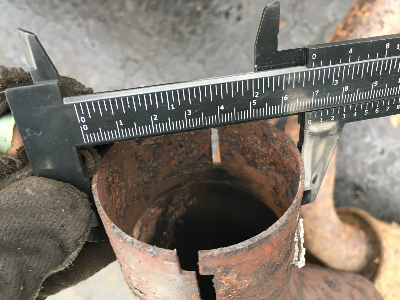

Have clamps for Bosal cat, installed
Rear pipe is 2 3/4 inch to be clamped
Beautiful 41F sunny day !!
New screws here.
