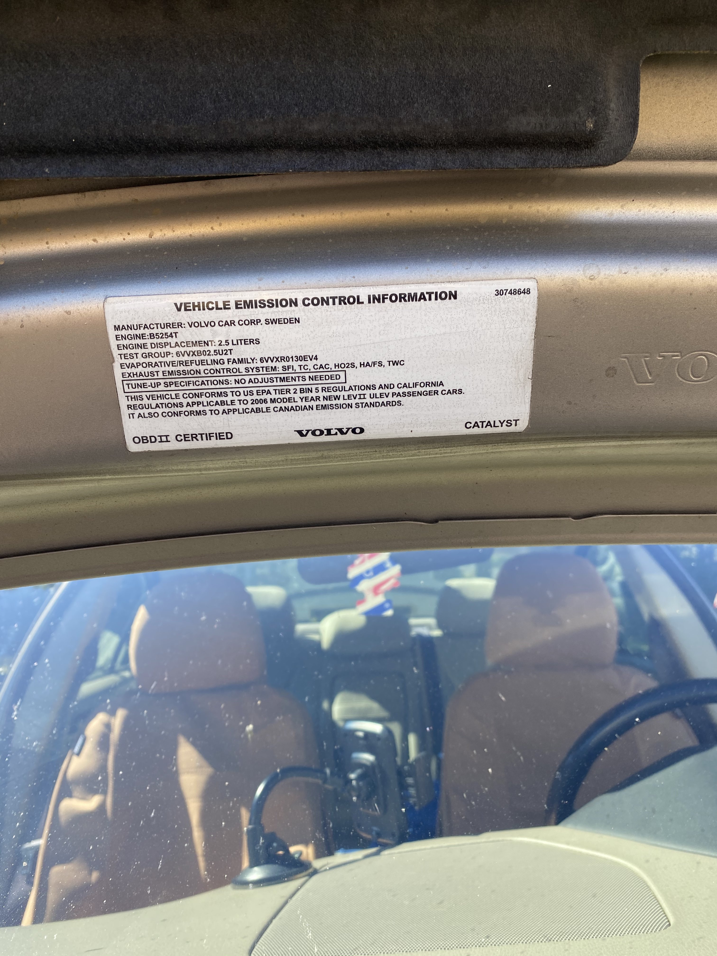

My son just bought a 2004 s60. We need to do the timing kit and SERP belt.
I’m trying to I’d the engine for parts but, I’m second guessing what I’m seeing.
I have taken a picture of this sticker. Can some help me decipher it? I know it should be easy but this number doesn’t match what’s coming up in the vehicle garage.

2.5 liter turbo
Corrected below
To be really safe get a picture of either the sticker on the timing cover or the embossed engine number on the engine near the water pipe
Corrected below

Ok. That’s what I thought it was. I guess I’m used to looking at my 98 GLTs so I was struggling finding the turbo on this one. I will get the picture of both areas that you recommend.
Thank you

As abov,e if you are lucky and still have the large sticker on the side cover of the tb, otherwise you will need to decode the stamping on the block www.youtube.com/watch?v=irtWJPYWyGg Use a Continental belt kit - if replacing the pump at 200k miles use Aisin (Continental includes Hepu water pumps which Bmw owners say have caused premature problems)

On that car there is no turbo to be found per the VIN number.
The emissions sticker is not original to that car or the VIN plate has been changed. Notice the emission sticker has information about 2006 cars. They would not of had that information in 2004.

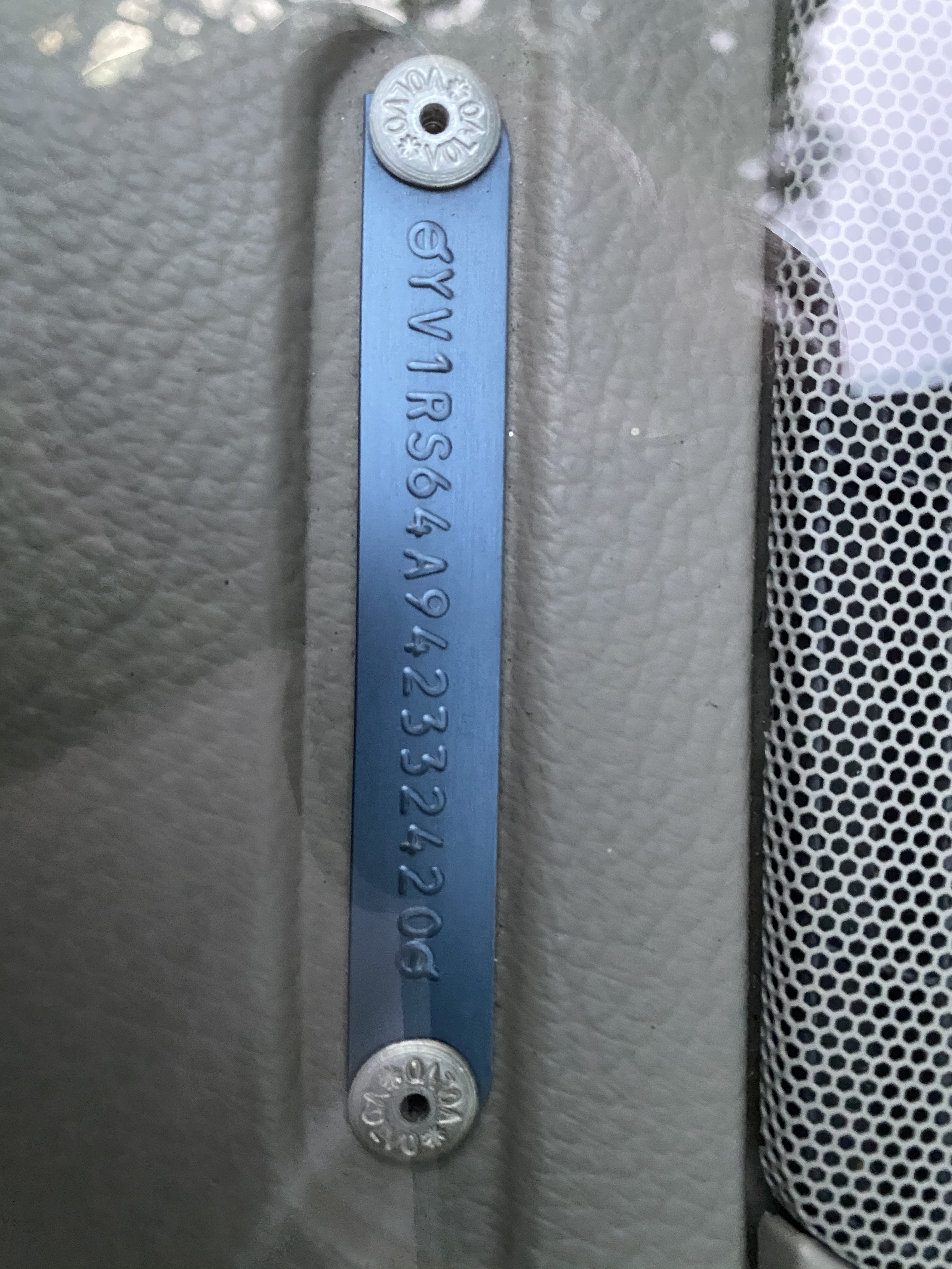

If it is a true 2004, there are two more locations for VIN number in the engine compartment. Middle of the engine bay up at the cowl. On the product ID plate which is located in under the hood at the left fender. VIN number is also on the title. All four should match.

Per the VIN number on the dash.
It is a 2004 S60 with a naturally aspirated 2.4L. (Engine code 64 = B5244S6). S in the engine code is for Standard or naturally aspirated. If it was Turbocharged this would be a T not a S. Transmission is a Aisin 5 speed automatic.
All this information is encoded in the VIN number except the transmission which is determined by deduction.
Outside of Canada and the U.S. the transmission is coded in the VIN number.
Vin breakdown for VIN YV1RS64A942332420.
YV1 = Volvo
R = Model: S60
S = 4 Door other then model S80.
64 = Engine B5244S6
A = Emissions: w/o EGR, w/o Air Pump, OBDII, Variable Valve Timing Intake and Exhaust, manifold close-coupled Catalyst plus under floor catalyst, Denso - EMS, & Zero Evap. Emission.
9 is a checksum digit.
4 = Model Year: 2004
2 = Factory Code: Ghent, Belgium.
332420 = Chassis number.

I’ll guess you have had a hood swap on this car at some point.
Get that engine number for parts ordering

If the VIN don't match and/or the Product ID plate location is wrong, the car is smoking hot.
