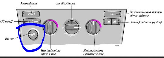

I'm looking for a blower knob replacement for my 2005 Volvo V70 2.4 - manual climate control. My setup looks like the one in the attachment (only no seat heater buttons because...no heated seats:) I can't seem to find a replacement anywhere online. The knob covers the control button itself which is a light (circled in blue in the attached image). The light illuminates the fan image and line. No luck with the local dealer (not that I'd pay the over-price anyway). I'm thinking someone here might have a line on a site or resource.

Thanks Rick and Oragex. I'll try the rubbing alcohol process. The knob works correctly. It actually is a 'cap' that goes over another knob. At night the knob under the cap lights up (chunky clear knob). It looks kind of thin, but snaps onto the larger knob. Seems to work okay but is getting a bit weak/brittle.
