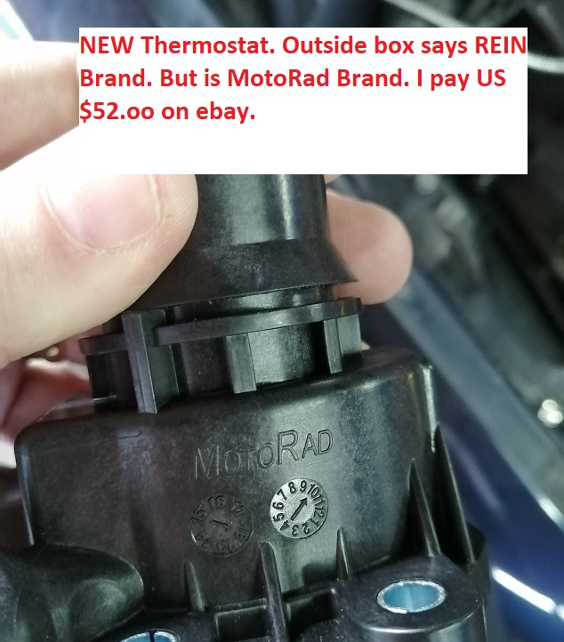

Today I took the car to the mechanic to install the new Thermostat. Check the pictures. The bad one has a rubber seal that was out of his position allowing water to pass. That's why my engine was taking like 20 minutes to get to the working temperature.
Check the photo of the new thermostat and you will not see the rubber seal.
I order a REIN Brand Thermostat. it Arrive in a REIN Automotive Parts box but when I was checking, find that is Moto Rad brand. I pay US$52.oo on ebay.
I was checking on ebay for MotoRad Thermostat and the same model, was around US$95.oo
BTW, we do not removed the intake manifold to install the thermostat. There was enough space to work. I will say it took around 30 minutes to install the new one.

The thermostat came in a box that have the REIN Brand, made in Israel ... I Hope this will last long :roll:
Today parts even if it says MADE IN GERMANY, it is not a sign that is good quality. I imagine that they have also lowered their quality in order to compete with China.
