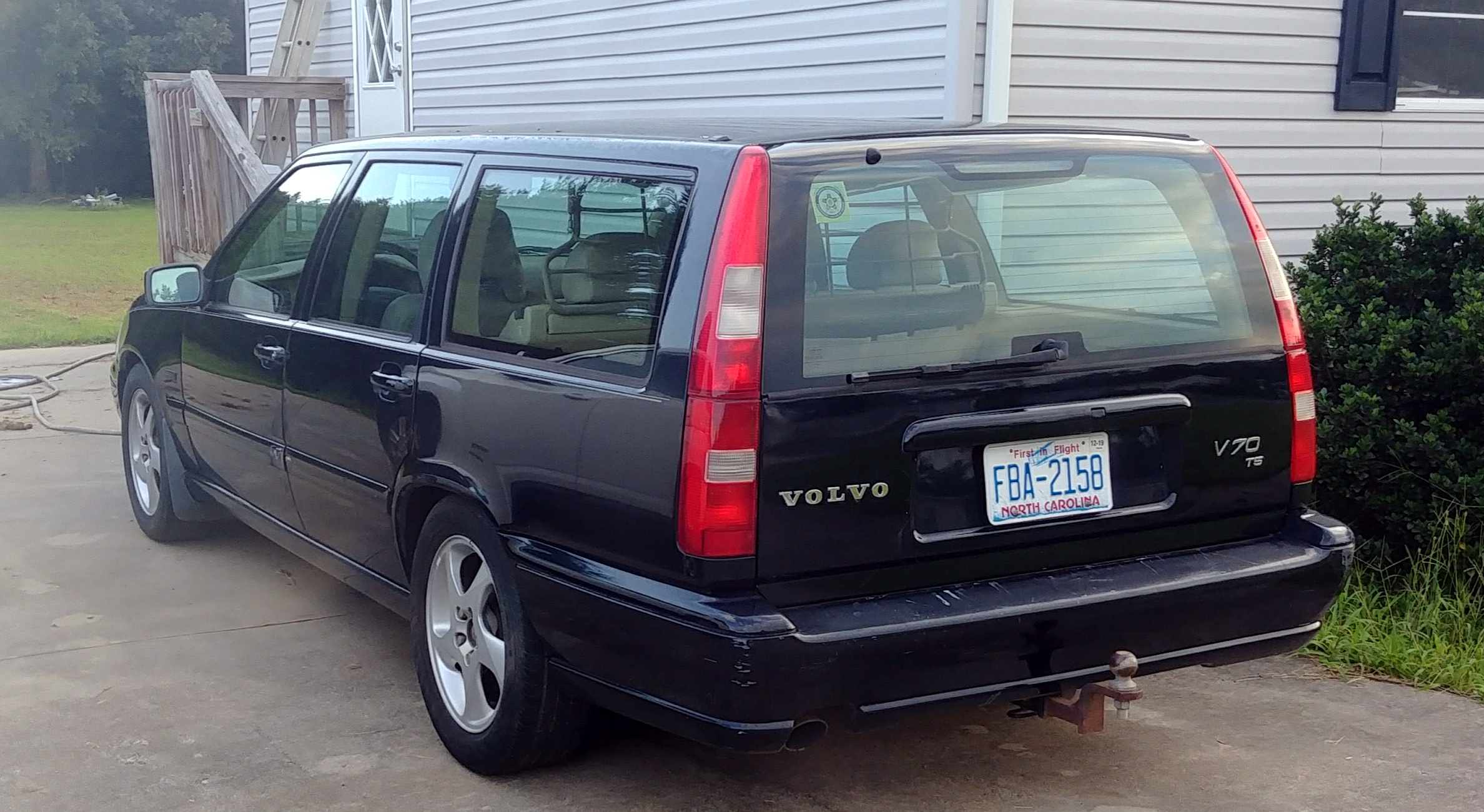

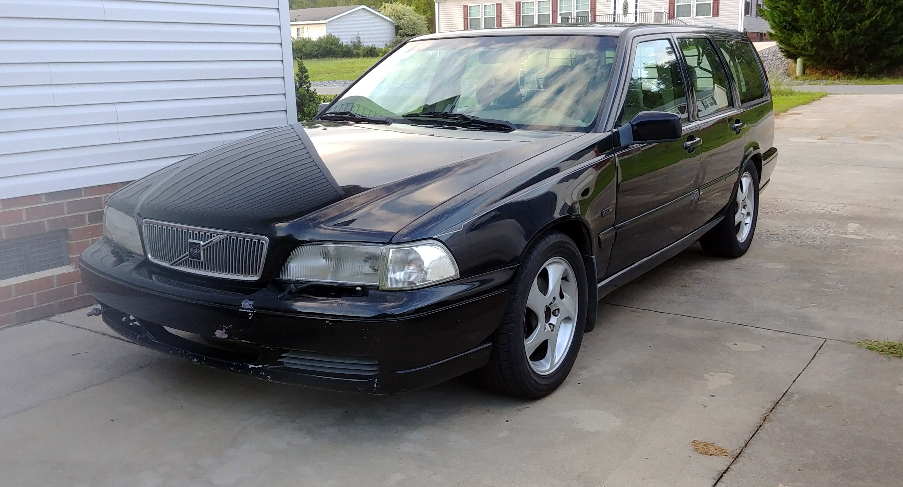

Stupid question but are you sure that is a 99? It doesnt have side indicators or the blue badge? Looks to be fully loaded so that is a plus.
Post a picture of the engine bay!

Beautiful Nautic Blue, VP colour of champions
