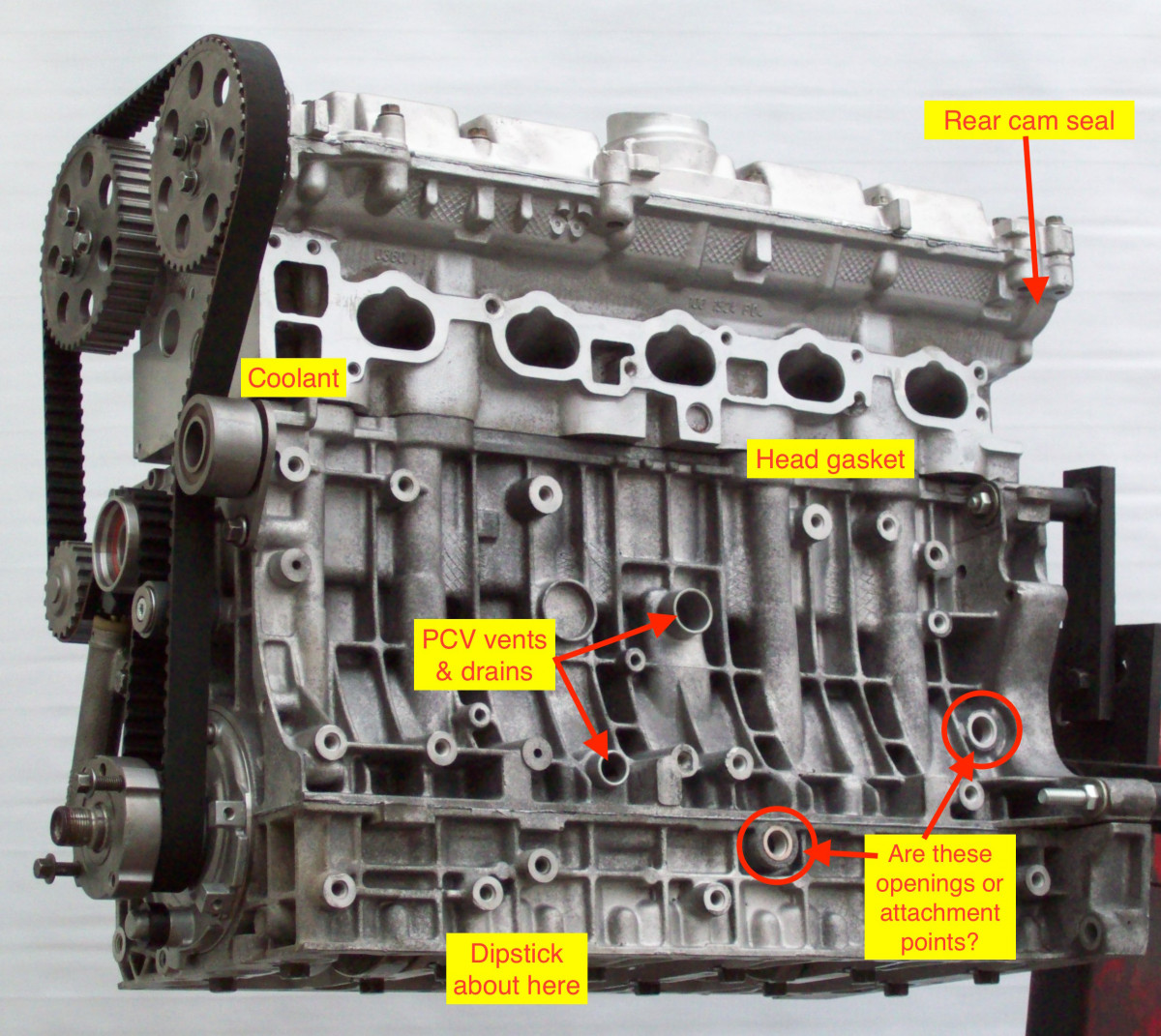

As I was poking around under there, I saw that quite a bit of oil is coming down the front / intake side of the block and blowing back across the pan. Not the pan gasket, it looks to be pretty high. Better light and a mirror tomorrow.
What’s up there under the intake that has oil pressure? Does the pcv box have any pressure?.. It’s just a vapor separator. Head gasket? (OH NO MR BILL...) hmm.

It may be one of the rear cam seals letting the oil trickle down. Those leaks tend to travel.
by BlackBart » Sat Sep 19, 2020 10:52 pm
Like on the distributor end?
by bmdubya1198
Yup. Pull the cap and see if there's a bunch of oil in there.

I looked at that. Possibility. There's an oil drip on the bottom of the manifold - unless it's spraying from way down there...
I'll check the cam seal at the distributor. I've had a PCV elbow hose split on my P2 and it really sprayed oil all over the front side, so that's suspect as well.
There's an even sheet of oil running down the side of the pan - a long trail of drips, rather than a big spot.

No smoking gun yet. The distributor cap and alum housing are dry. The front (cam wheel) end of the block is dry.
Is it me, or does the P2 have a lot more room to see and maneuver under the intake than the 850T? It may be the big ram's horn / barrel intake is way deeper than the flat-ish P2. I could reach the PCV hose clamp on the block from above and to the transmission end of the block on the P2. The starter, the knock sensors, PS hoses, and a lot of wiring in the way. I lifted the car and I'm trying to see with a mirror from below.
The underside of intake runners 1-2-3 are dry. Runners 4 & 5 are wet. 4 is directly above the oil pressure sensor. The dipstick tube is just forward (towards the cam gears) of that on the block. I snugged up the oil pressure switch, but it was tight. The big side hose with the 90º on the PCV is wet, and the block, as is most everything under there. I don't see any cracks in that hose, the clamp appears ok, but so did my P2 when it split.
So I think something is spraying, to get oil on everything, and running off the pan. I think the intake probably has to come off, then you might as well replace the PCV.

You need to get the intake off to determine if it’s pcv leak, oil pressure sender leak, or head gasket leak.

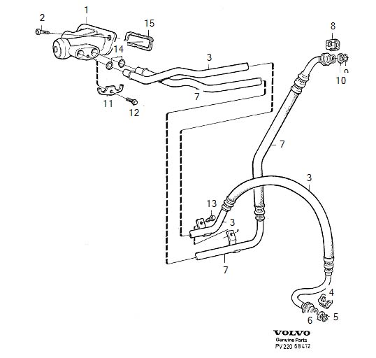

Isn’t the right side the turbo cooler (engine oil ) and the left side the transmission cooler?
Grasshopper. I see 6842413 and 6842414 , 2 each in your future

What abscate said - the cooler line near the alternator is oil cooler. If that line is wet above its metal-to-hose joint then you may be lucky, and the leak is just the sealing ring and/or o-ring where the line plugs into the radiator. Heck could even be just the metal clip on the line is bad or on wrong.

wait a sec.....is that right? They come out of the radiator, passenger side, going downward, turning to metal lines, then turning towards the passenger side sort of in front of the right wheel well. I lost them there, car is back on the ground. Looking up a parts diagram now.abscate wrote: 27 Sep 2020, 18:09 Isn’t the right side the turbo cooler (engine oil ) and the left side the transmission cooler?
So, let's say that line is spraying oil mist......what about dipstick vapor and lack of clear suction on glove test? Two issues here you think? ...or......crackcase pressure helped that oil line union to fail...?
Master...you have already provided the part numbers that I have yet to seek in my quest....

Good call, but no oil up that high. I actually wiped those fittings on the radiator and they're bone dry. It starts halfway down the rubber portion, but above the metal pipe union. Looks suspiciously like the dipstick pipe o-ring could be spraying on it, but I couldn't make it do that holding the throttle by hand with a light right on it.erikv11 wrote: 27 Sep 2020, 20:22What abscate said - the cooler line near the alternator is oil cooler. If that line is wet above its metal-to-hose joint then you may be lucky, and the leak is just the sealing ring and/or o-ring where the line plugs into the radiator. Heck could even be just the metal clip on the line is bad or on wrong.

How about hose 3528201 and hose 3528207 for $238 so far, plus associated seals and gaskets and those o-rings.
https://www.volvopartswebstore.com/show ... evel=24662
I'm understanding the plumbing better now, thanks.
