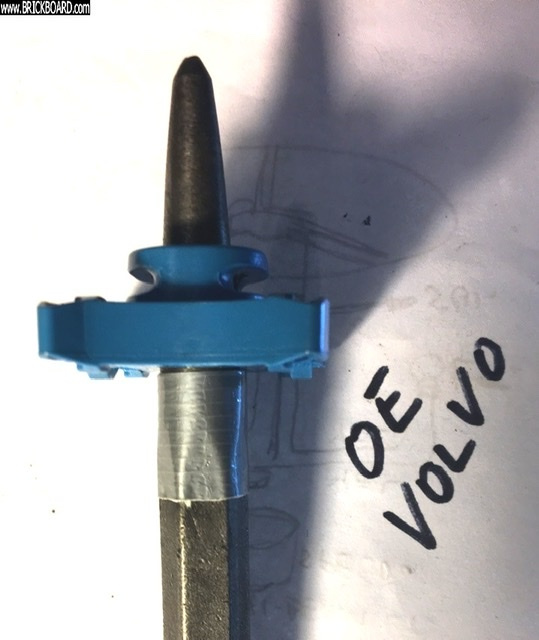

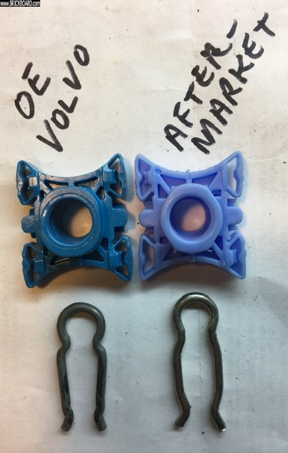

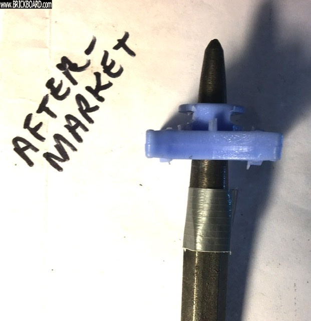

I found the aftermarket ones to have smaller holes so I drilled them out just a bit.
Note how the OE part slides further down on the tapered punch. The last photo shows difference in hole diameters before drilling out the aftermarket one.

Oh, also....cn90 wrote: 18 Oct 2020, 11:06 Actually, I don't mind saving money as long as you know ahead and drill the holes bigger before installation...
The original clips are better quality and better fit than the aftermarket ones so I re-used the original ones.
