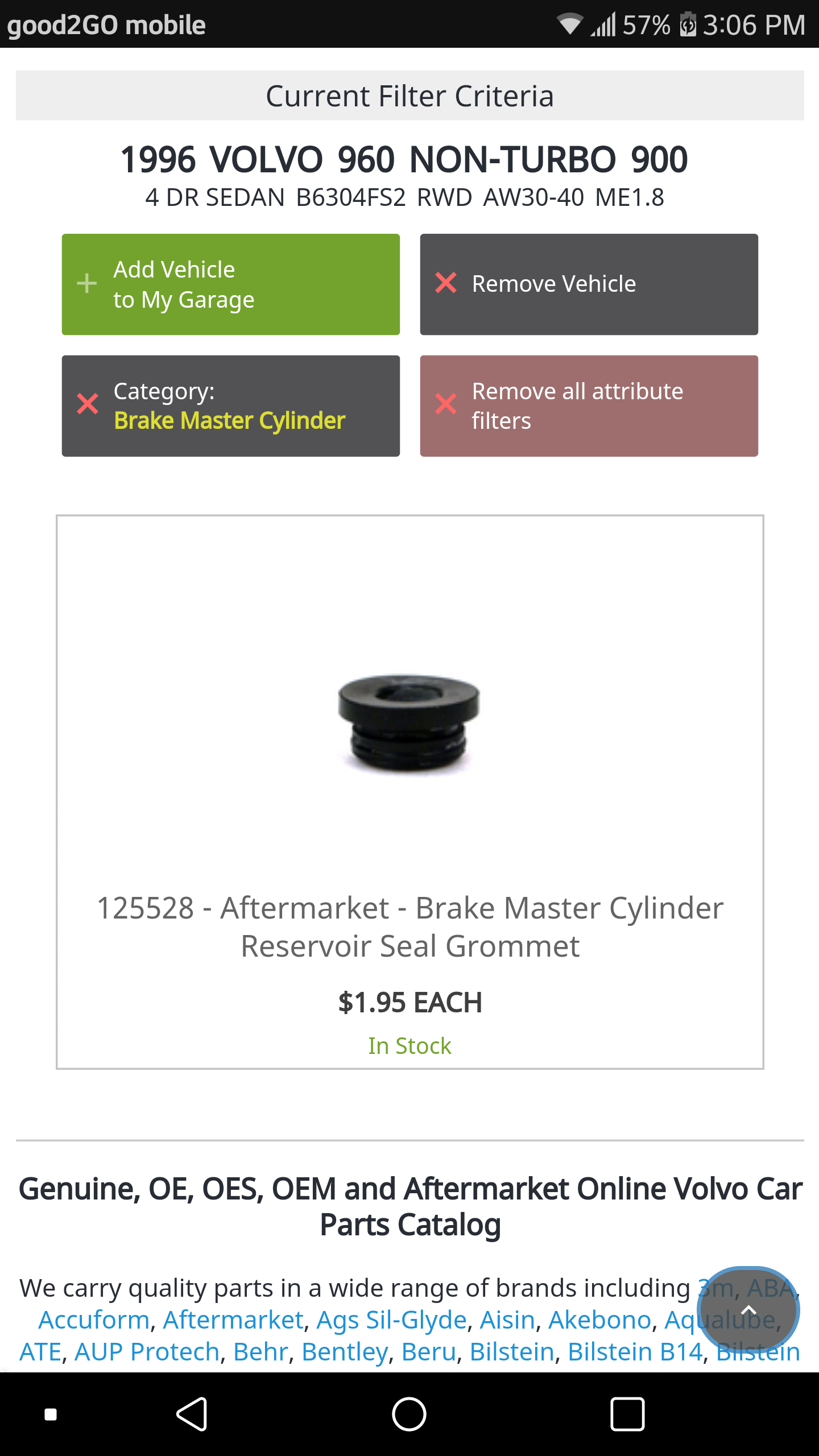

The whole recondition for me also might be about $20. A new MC is $79 and reman MC is $45. Im wondering if I can use a fine sandpaper drill bit for the honing. Is this the seal I need or not (see pic)?volvolugnut wrote: 25 Oct 2020, 13:20 https://www.homedepot.com/p/Powerbuilt- ... /204505222The MC piston moves in a cylinder like a piston in the engine bore. As brake fluid absorbs water, the cylinder will corrode. A brake hone smooths the master cylinder inside so the new rubber seals will not leak.

No, this seal shown is the seal for the tank. Neither IPD or FCP have a seal kit. Beware of off brands that may have bad rubber.
A sandpaper flapper should work if it gets the cylinder smooth and shiny.
