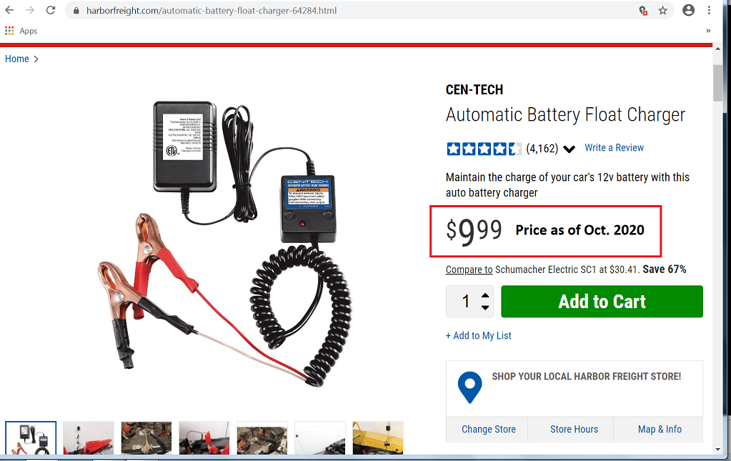

Yeah,
A good device is the trickle charger, about $10 at Harbor Freight.
If you have the coupon, it can go down to $5.
Inside the garage is easy, just plug it in.
Outdoor is a bit more challenging, make a habit of charging it let's say for the whole Saturday when you are at home, then unplug it.
