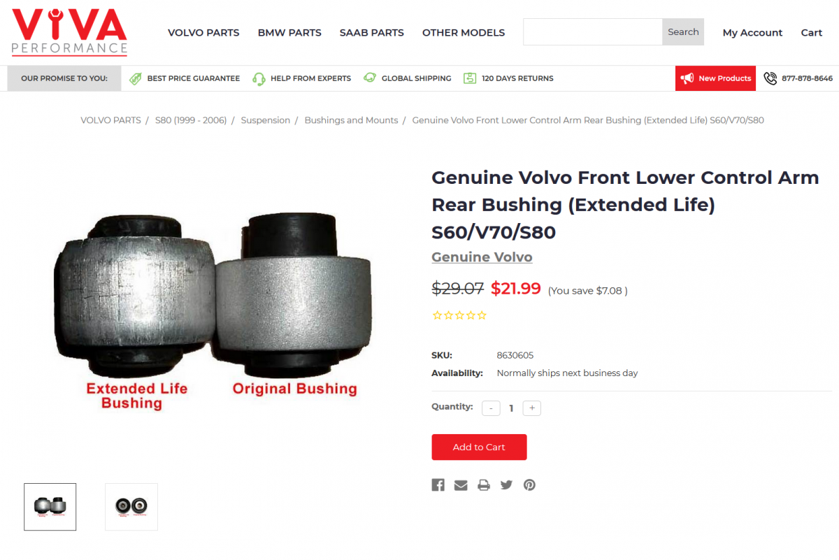

Do not use old bushings. The XC70's use a taller (more rubber) rear lower bushing than the regular bushings of the V70's which also fit. Here VIVA is really suggesting the XC70 bushings for the V70 and other compatible cars. I believe I crossed reference dimensions for these on CARID's website.photoguy wrote: 17 Nov 2020, 12:59 Afternoon.
I'm working on my new '07 XC70, before it gets ridiculously cold in the frozen tundra here. I'm picking up some nice used body parts from local Volvo recycler, he has some control arms with only 32,000 miles. I'm rebuilding the front suspension and steering, I've never purchased used front end parts, is this a bad idea? $70 for both.
Thanks!
https://www.vivaperformance.com/genuine ... 0-v70-s80/
https://www.fcpeuro.com/Volvo-parts/XC7 ... d=586&v=97

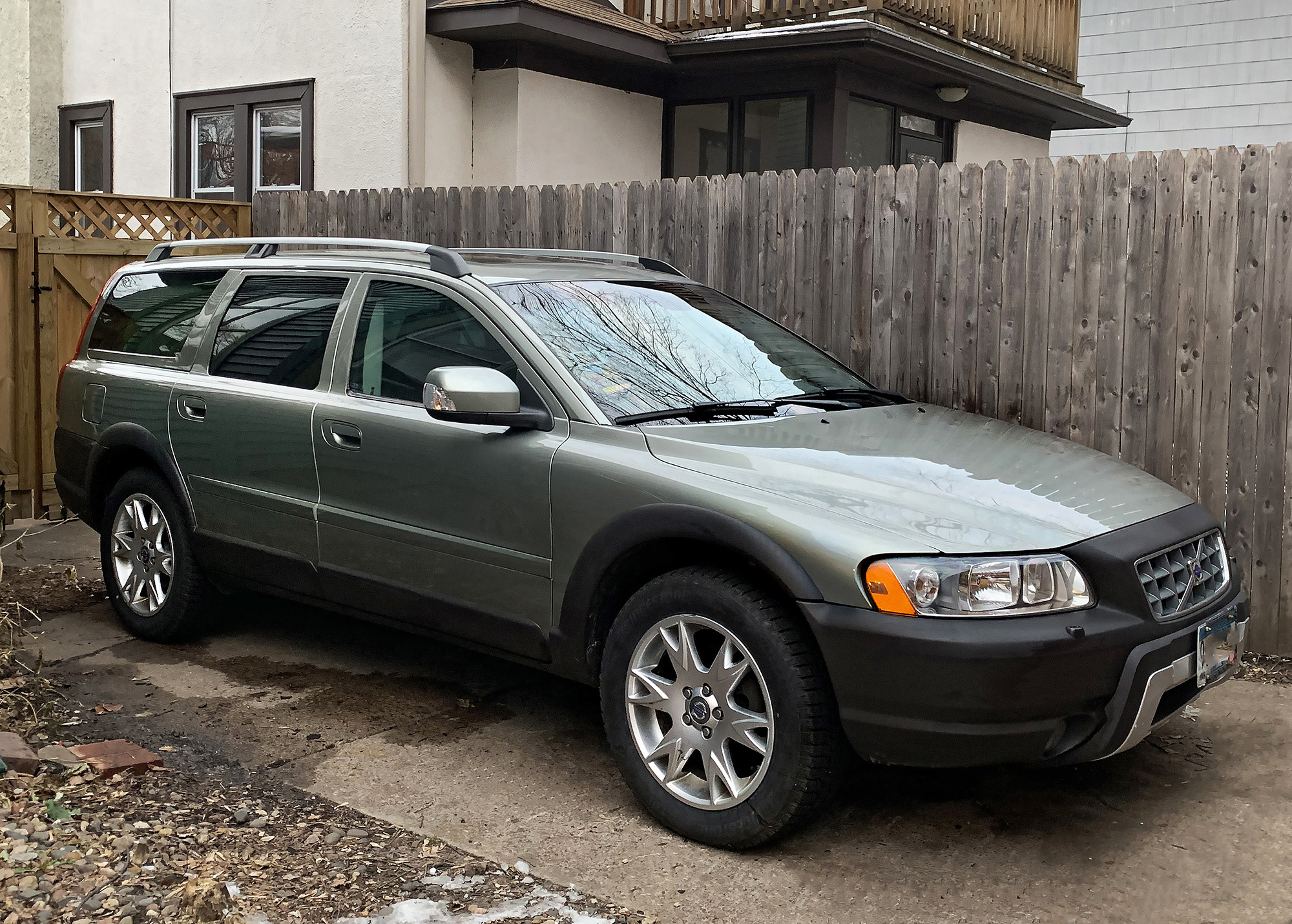

Well, I took the advice here and purchased, thank you! The donor car was identical to mine (2007 & Willow Green), and very low miles only 32,xxx. The arms are factory, and look really good, bushings look great, I did the screwdriver test. I'm doing the work myself, taking advantage of our two days of warm weather. Trying to save some money during these tough times.
I just purchased my one owner XC70 for $1400, with 264,XXX miles. It's been so well cared for, I felt a little guilty over the purchase price, but that's what was offered to me. Came with a pile of dealer and independant Volvo mechanic receipts.
Thank you!
