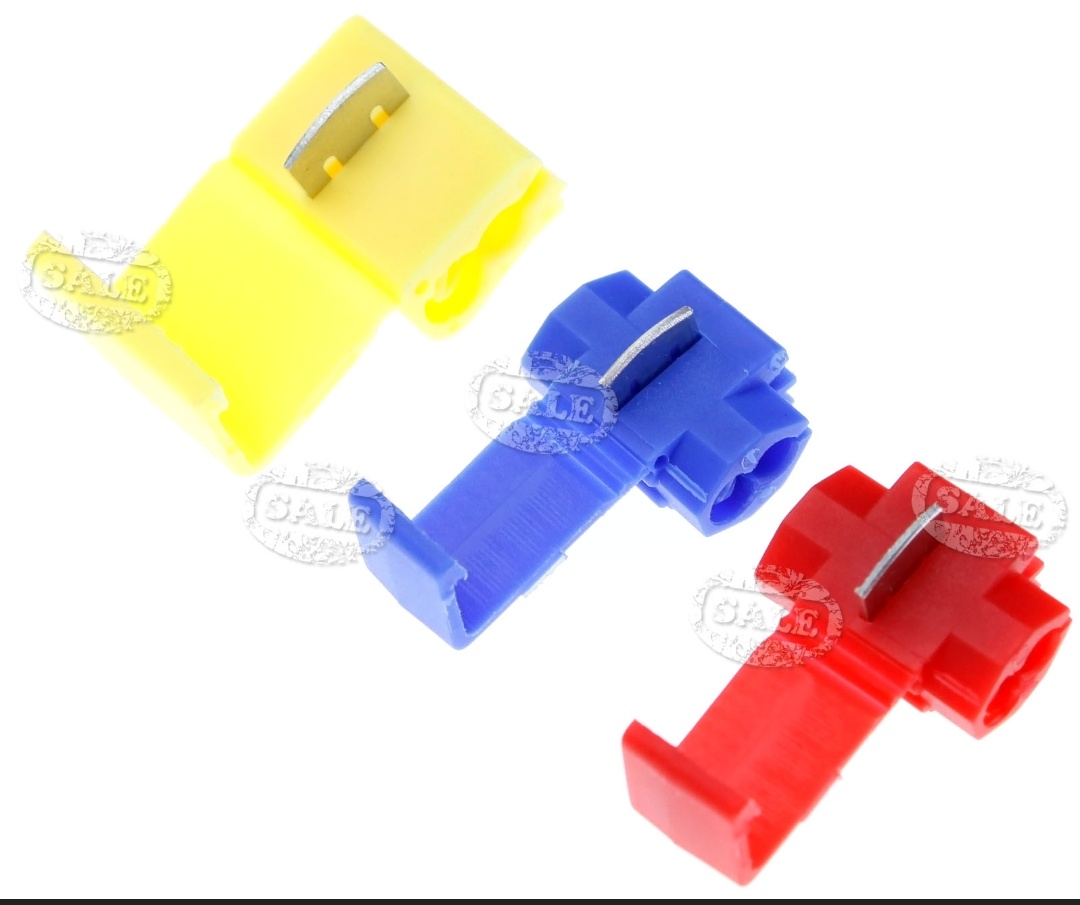

You could trace down the wiring for pin 6 to see if it's broken anywhere, or check the resistance between pin 6 and a good ground in the engine bay. There shouldn't be any resistance unless there's a short in the wiring. You could also try to run a new wire to pin 6 from the positive lug to the pin wiring as close to the ETM plug as you can using something like what's in the attached pic, just make sure to run an inline fuse that's the correct size if you do and remove fuse 7 in case there is a short, to see if the ETM powers up.
Install the fuse last in the new wire. It'll have power at all times this way, so a different connection point will need to be found if this does work. If it doesn't, just tape up the wire from where the plastic connect (in the pic) was connected.

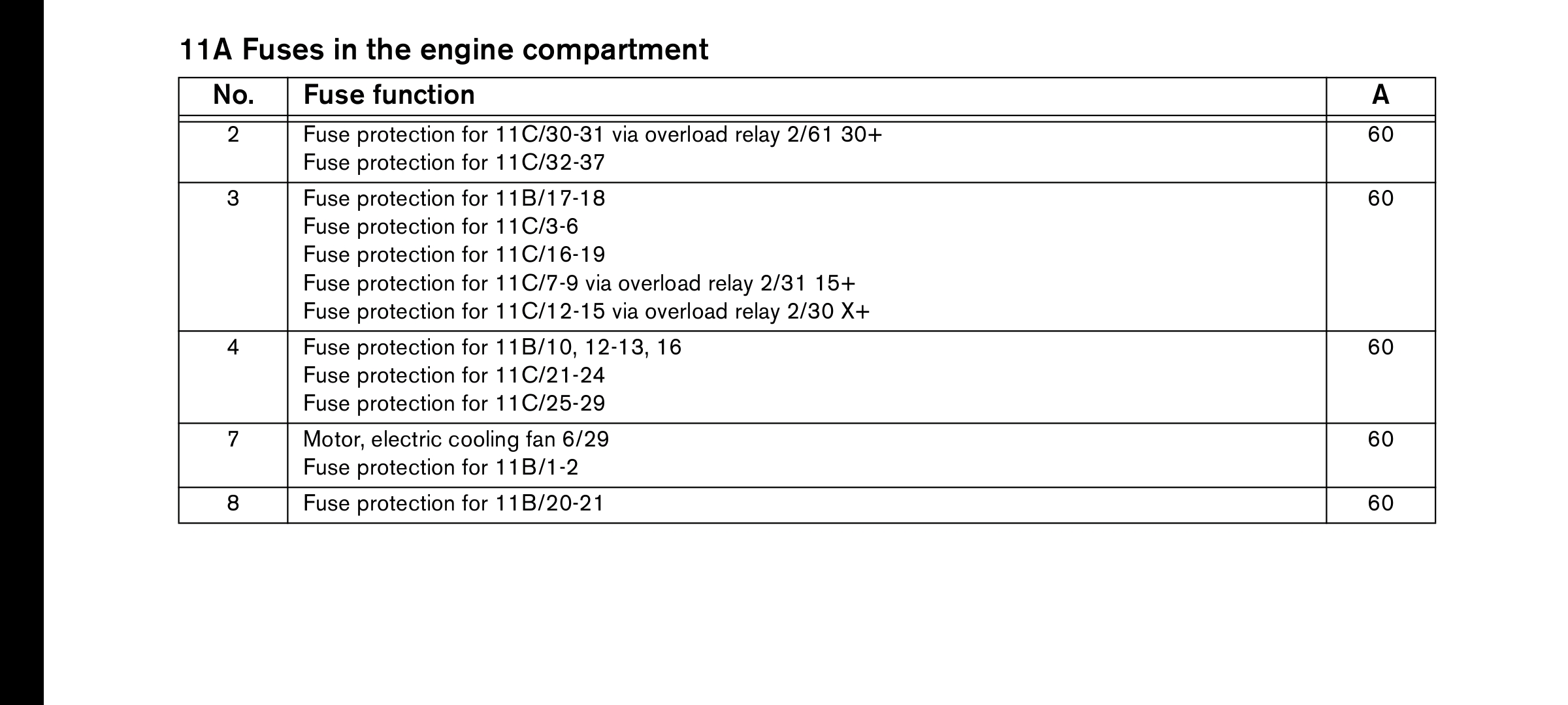

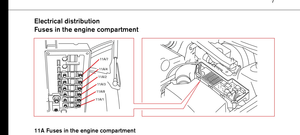

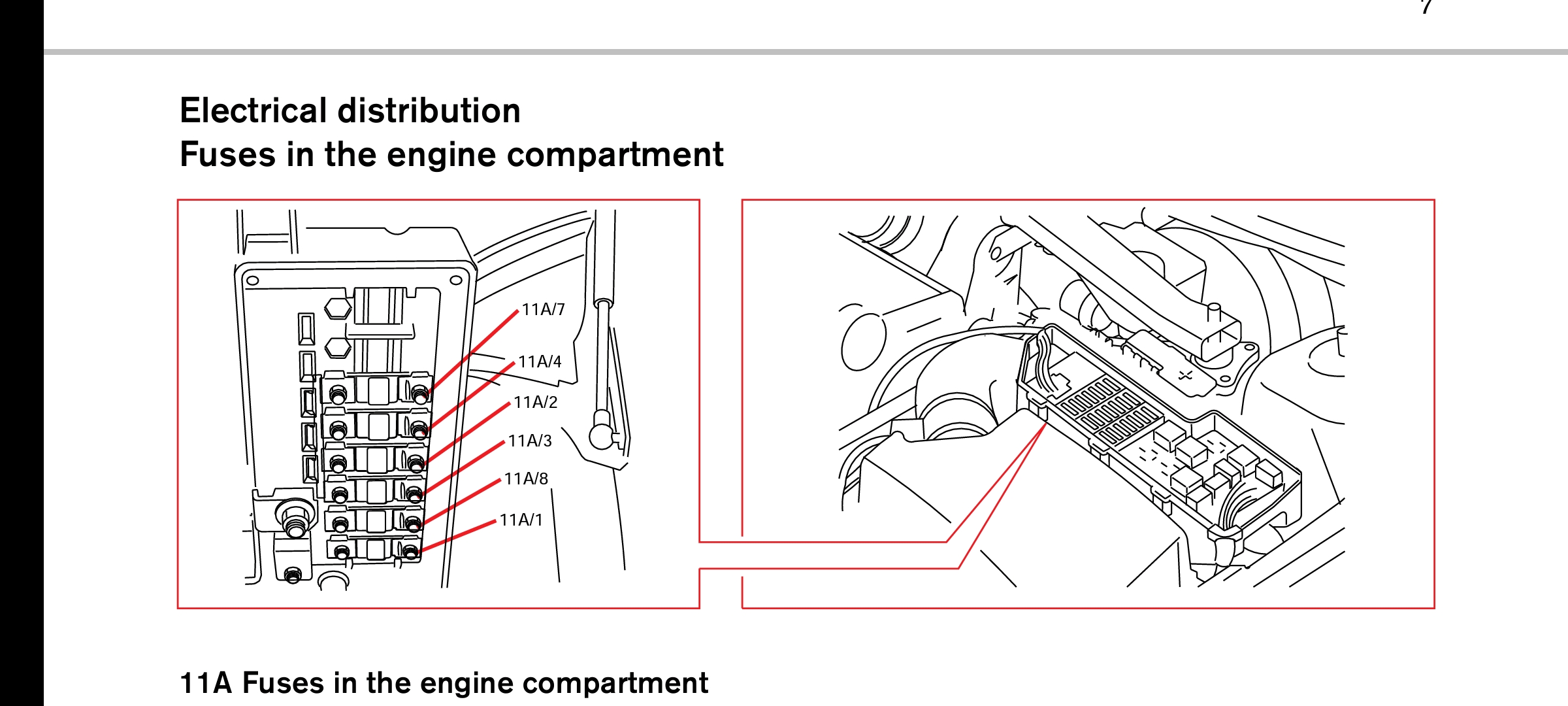

There's fuses underneath the distribution block too that you might want to check. They're a bit difficult to get to, but you need to disconnect the battery, remove the nut on the lug (also a good time to clean the rings if they're corroded), the 4 torx screws, and the wiring connector that's plugged into the top. Then, if I remember correctly, it should lift up but it may be snapped into place. I can't remember since I haven't had mine apart in awhile.
Yours may differ from mine, which is a 2001 S60, but here's the diagrams for mine that might be helpful.
