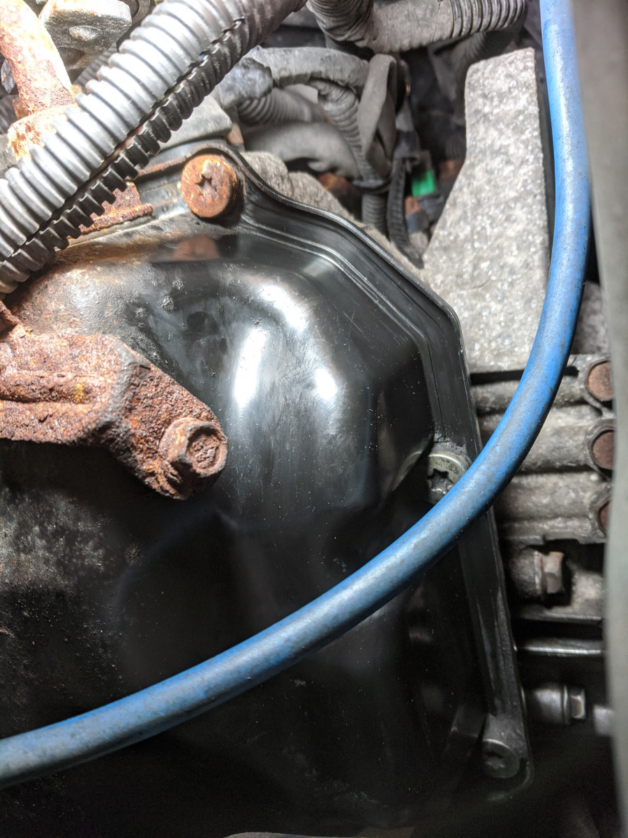

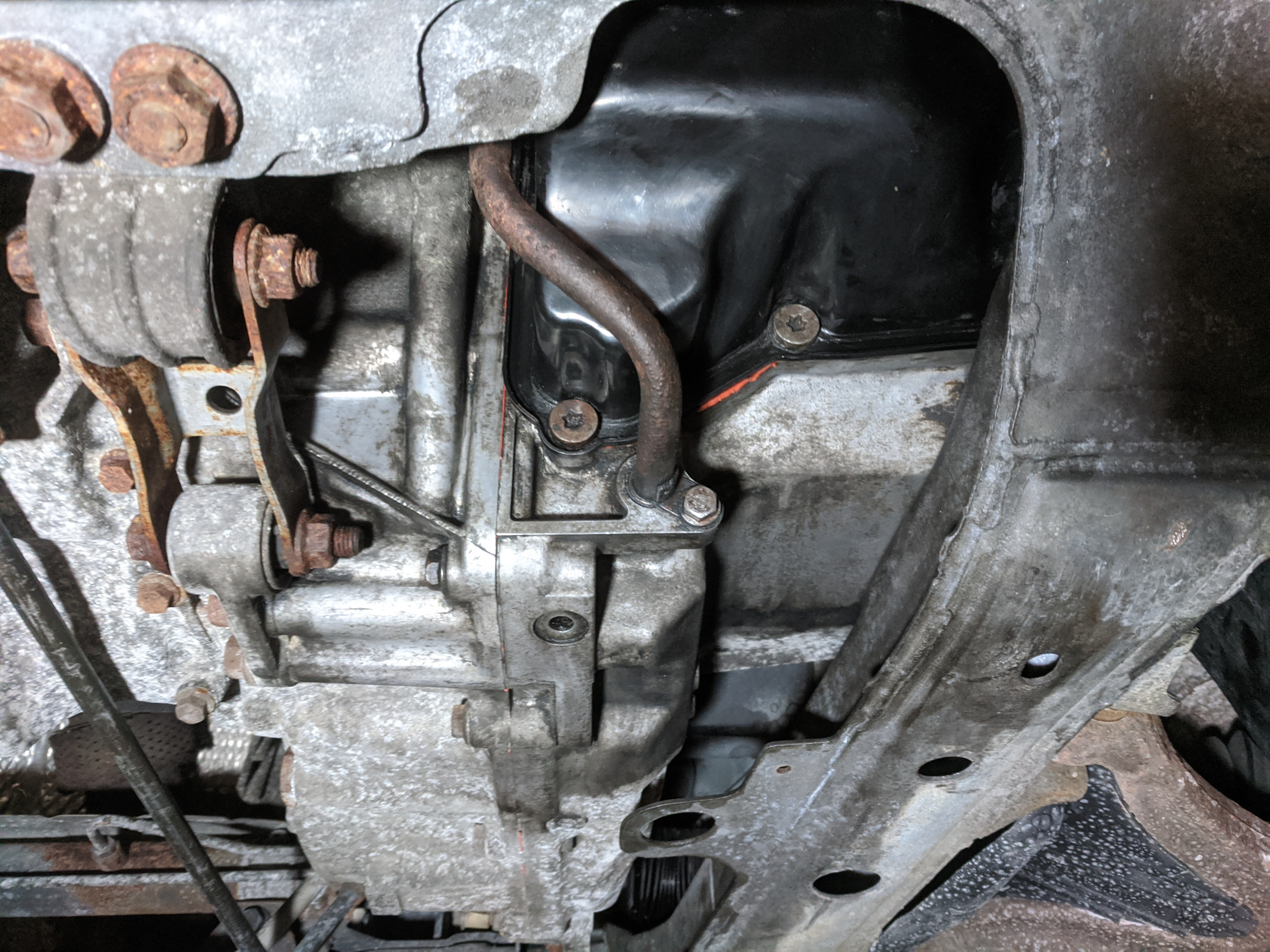

Following up on this: The pictures show the transmission valve body cover. It is sealed to the transmission using RTV silicone and nine bolts. I believe the silicone on mine has failed, allowing this fluid to leak.

I finally cleaned the transmission valve body cover. The transmission fluid level was perfectly at the top of Hot on the dipstick (after driving 30 mins, engine running, having just cycled through the gears). This makes me think the cover is not leaking. Perhaps it's engine oil running down from the top of the engine where the oil fill cap has an old cracked gasket. I'm going to clean that next.
It's funny how the coating of dirty oil protected the metal beneath from rust. Look at the bolts on that top picture, exposed rusty vs. oil soaked clean. Makes me wonder if the annual Fall oil undercoating which some people do is actually beneficial.

Nice clean-up job!
