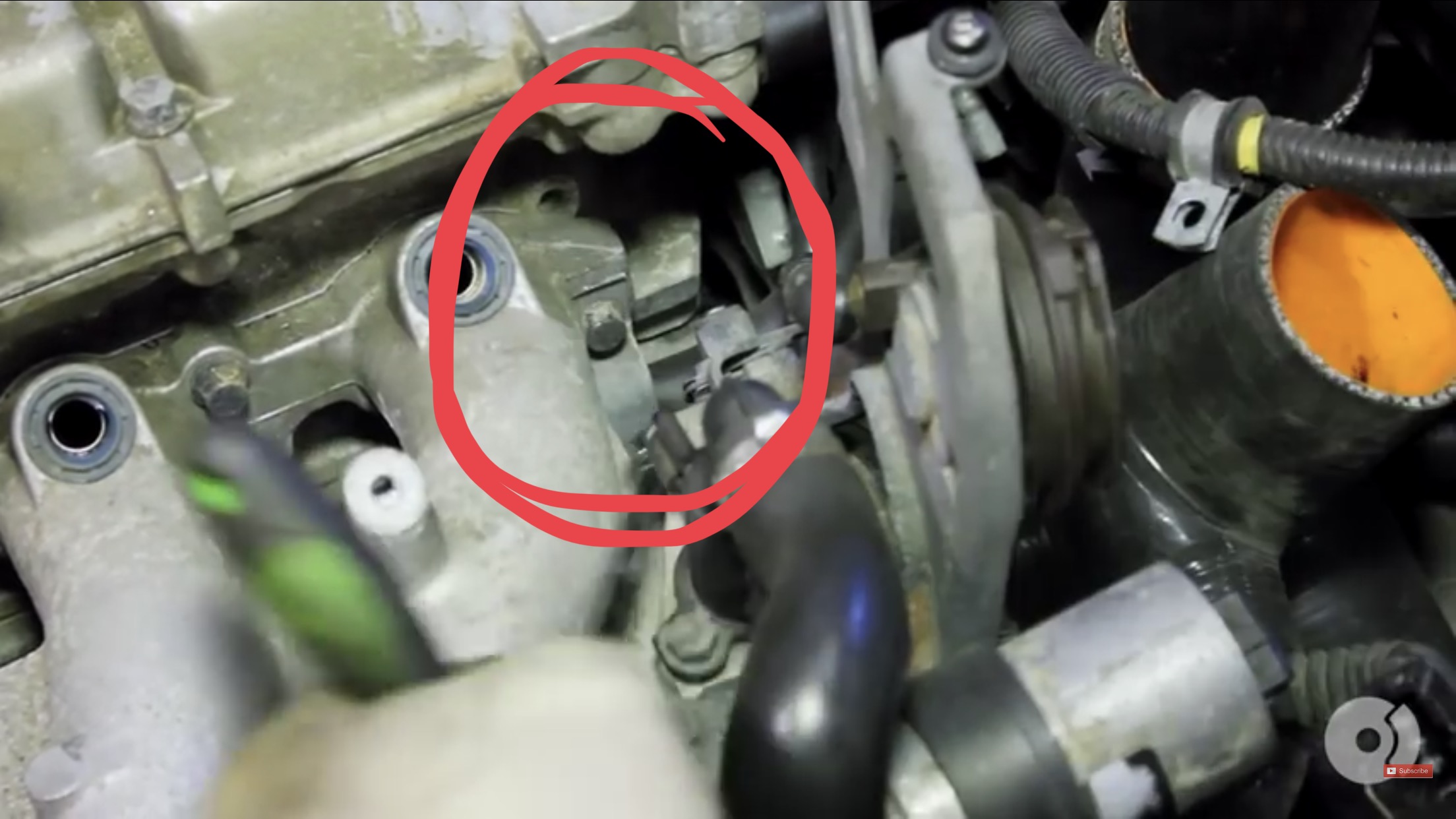

Take a picture of your intake manifold just left of your throttle body. Post it here.
I had the VERY same problem you described
This was the problem:
The PCV retaining clip was between the intake manifold and the engine block. Huge vacuum leak. Here is a screen shot from the FCP video I followed while I did my PCV and the moment in the video where I realized my clip was in the wrong spot!
I hope this is all that is wrong with your car.
