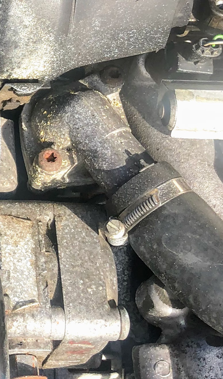

I actually did the block test back in 2017 while diagnosing a similar coolant issue (turned out to be an improperly tightened radiator hose back then):
viewtopic.php?f=9&t=81752
It came back negative at that point, but it's possible things have gotten worse in the intervening 50k miles since then. I actually still have the fluid that I had to buy to go with the kit, does anyone know if that stuff expires or if it should still be usable 3 years later? I checked local AutoZones and none of them have the tester available, will have to check Advance or O'Reilly.
