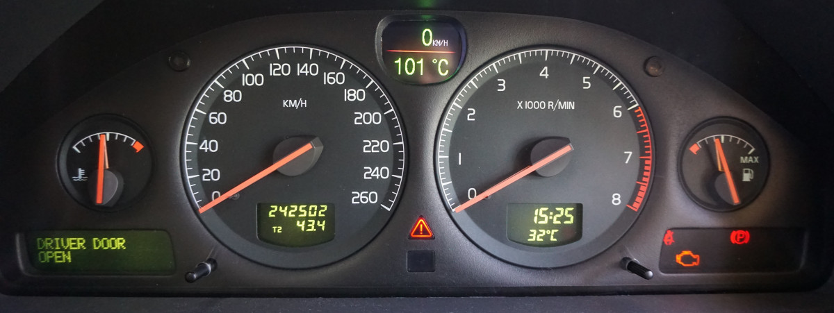

ive got my overheating temp alarm set at 104 C and ive reached it while stuck in traffic on a 30 C day (AC off). It also alarmed at a fast food drive through, couldnt hear the fan working. What should be the abnormally hot temp be or atleast the temp that the fan should be working at?
what temp is overheating?

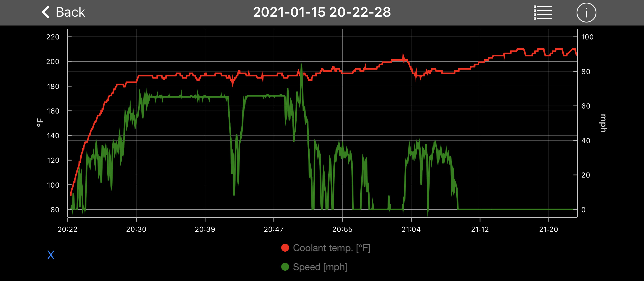

Very curious about expected normal temps as well. I produced this graph of ECT vs Speed after a driving session a few days ago. It seems that the average temp when driving was around 195F, but climbed up to 205-210F after idling for a while. The dashboard temperature gauge stayed around the middle from about 185F all the way up to 210F, so I'm assuming the ECU considers all of that to be "normal" range.

So the engine cooling fan activated during or after shutdown today,engine ECT was 99C (AC off) so im now thinking the engine cooling fan operation is dependent on a few factors/sensors, most likely the ambient intake temp or even ambient temp (30 C)
