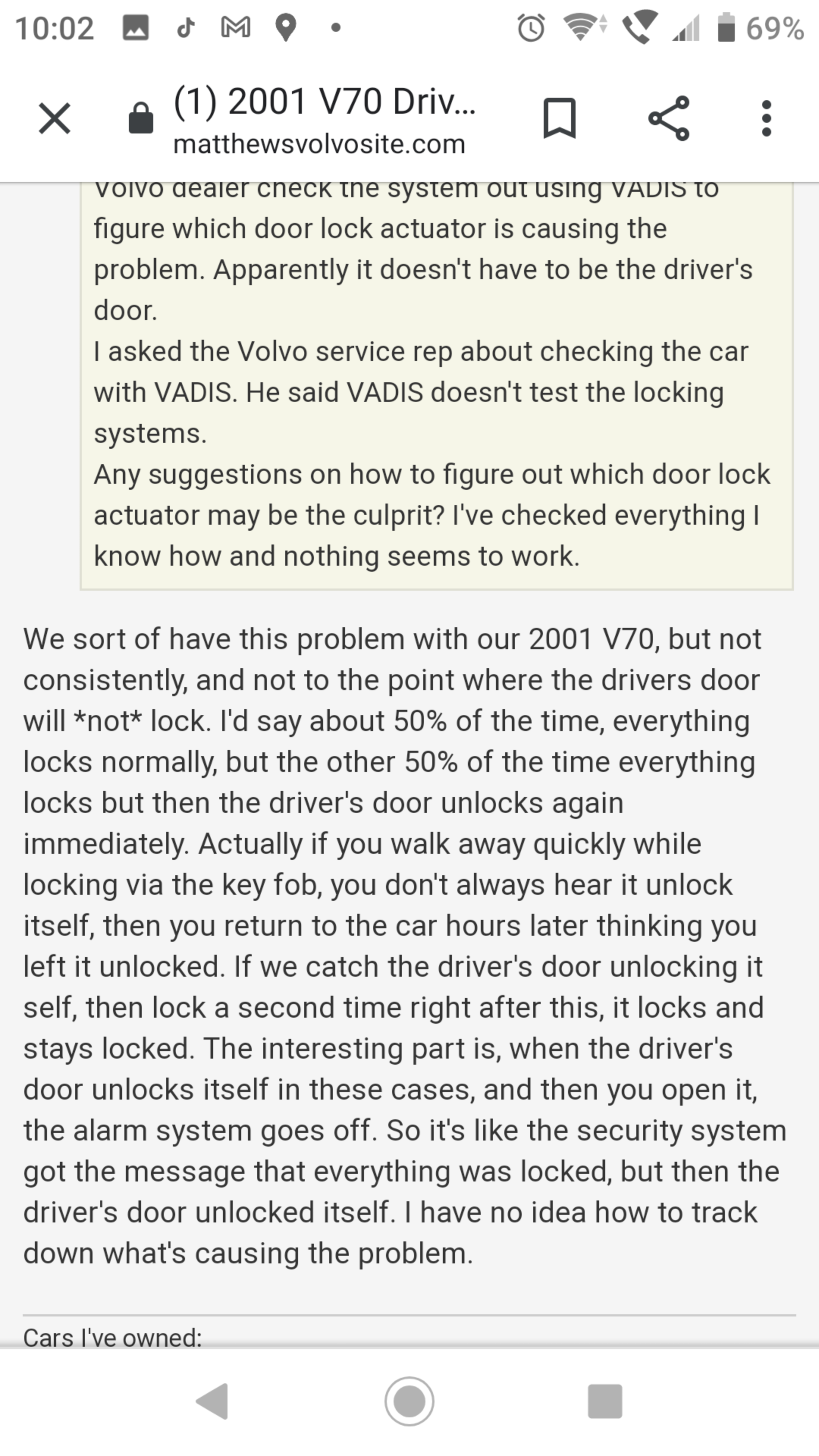

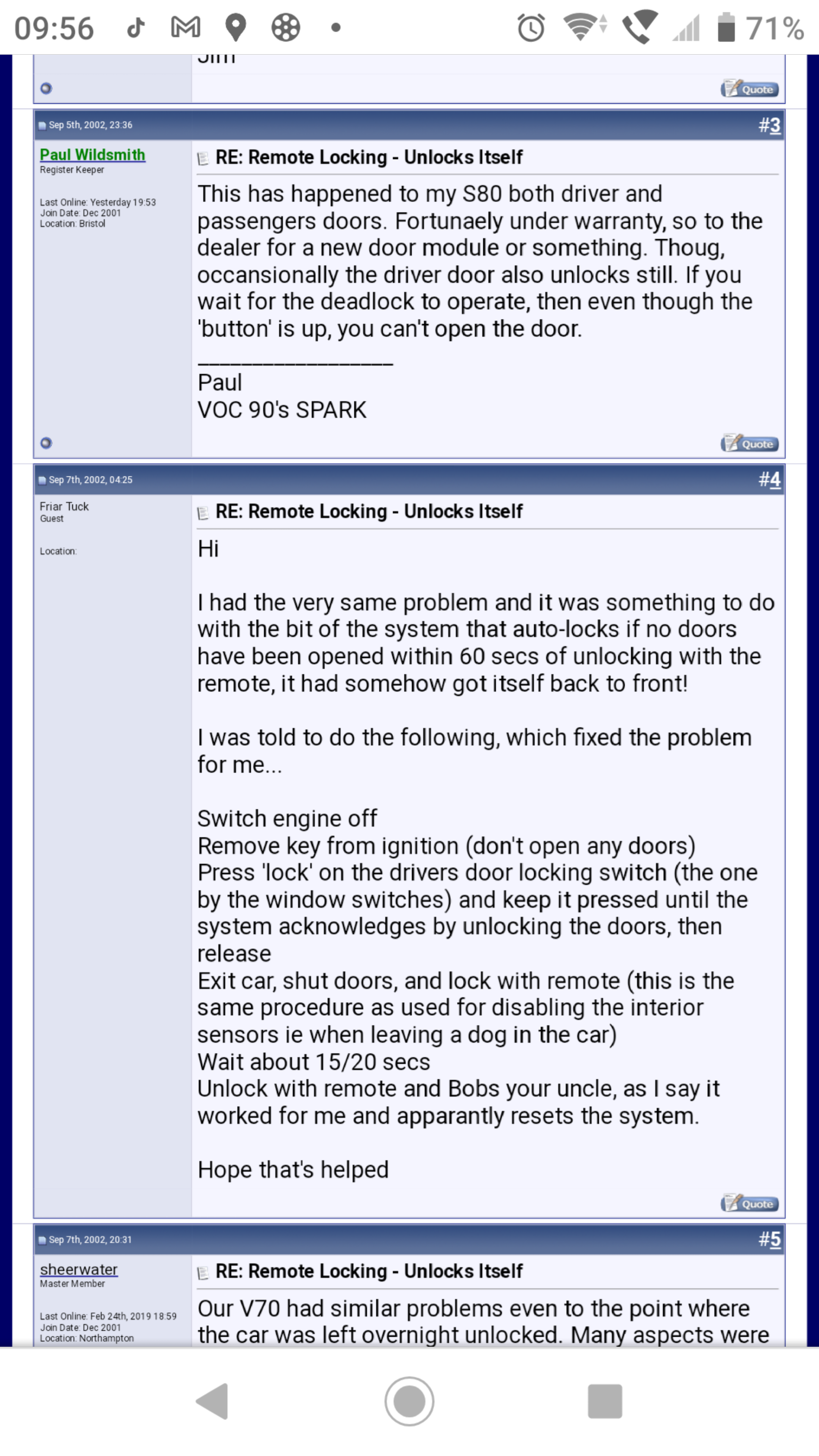

OK so it seems this ghost
is not uncommon just affects in different ways... I can't see a resolved case though
I'm going to see if it's some form of calibration issue, by trying this reset process...
Will post my results

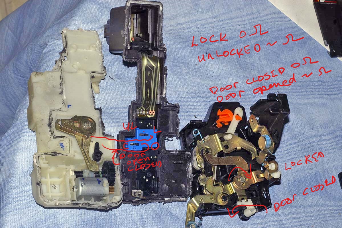

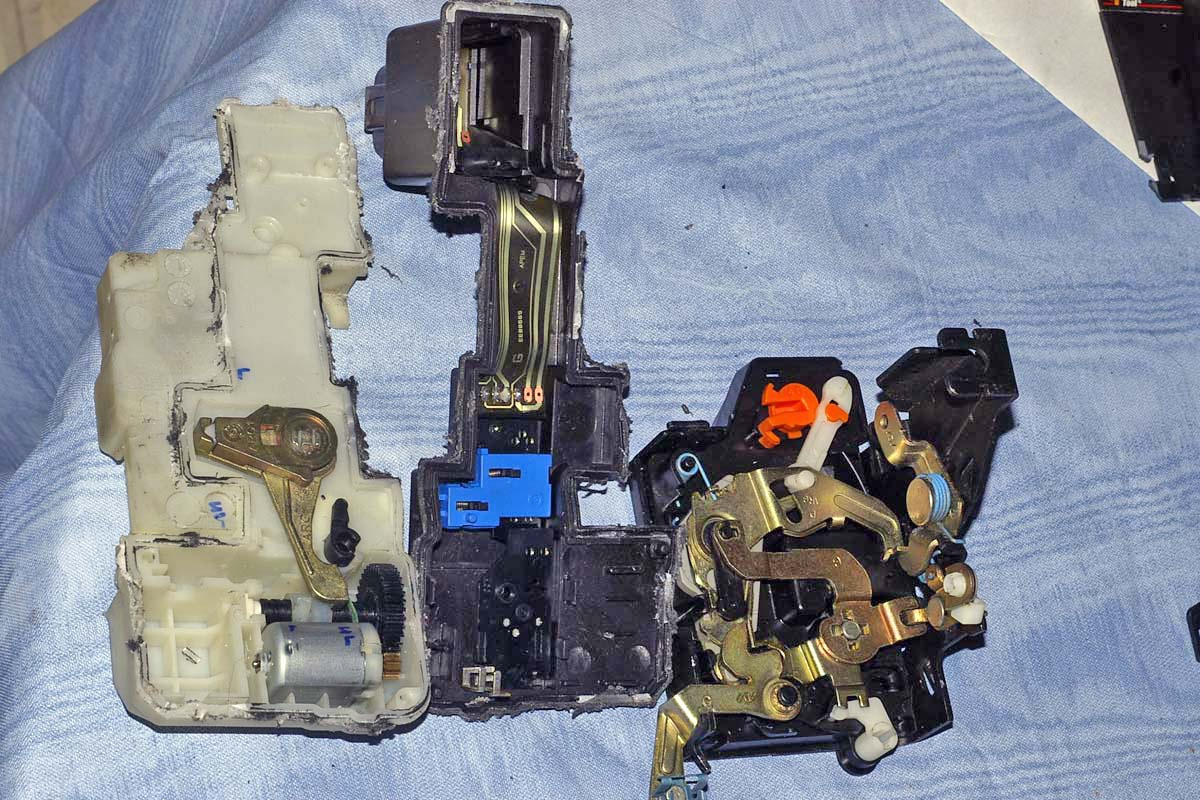

For the front lock it sounds to me like it's the lock assembly itself, the door lock/unlock switch. There are two sliding switches in the door locks (see photo) and I'm assuming one switch is to tell the CEM the latch is locked or unlocked and the other switch is for the door being closed or open. The door "signal low" error is likely the one switch being low when it's expected to be high. This could be a problem with the lock assembly or possibly a wiring problem (intermittent short to ground) but I'd suspect the lock assy first. Unfortunately you can't easily open up the lock assembly for repair. I've had to replace a front door lock assembly for a similar switch problem and a rear door lock for a broken linkage piece.
I'd start with the front door lock and replace the lock assembly with a new or salvage part.
This a photo of a rear lock but your front lock will also have these sliding switches
[attachment=1]V70 Rear Door Lock Assembly001.jpg[/attachment

I looked at the old lock I have and confirmed one switch is lock/unlock and the other switch is the door open/closed switch.ashleyg82v702001 wrote: ↑16 Jan 2021, 11:20 Thankyou I'll explore when the weather improves a little
For the lock switch it's 0 ohms when the lock is locked and and for the door switch and when closed it's 0 ohms. From the symptoms you're describing it sounds like the door closed switch may have an intermittent open when it should be closed or 0 ohms at all times when the door is closed.

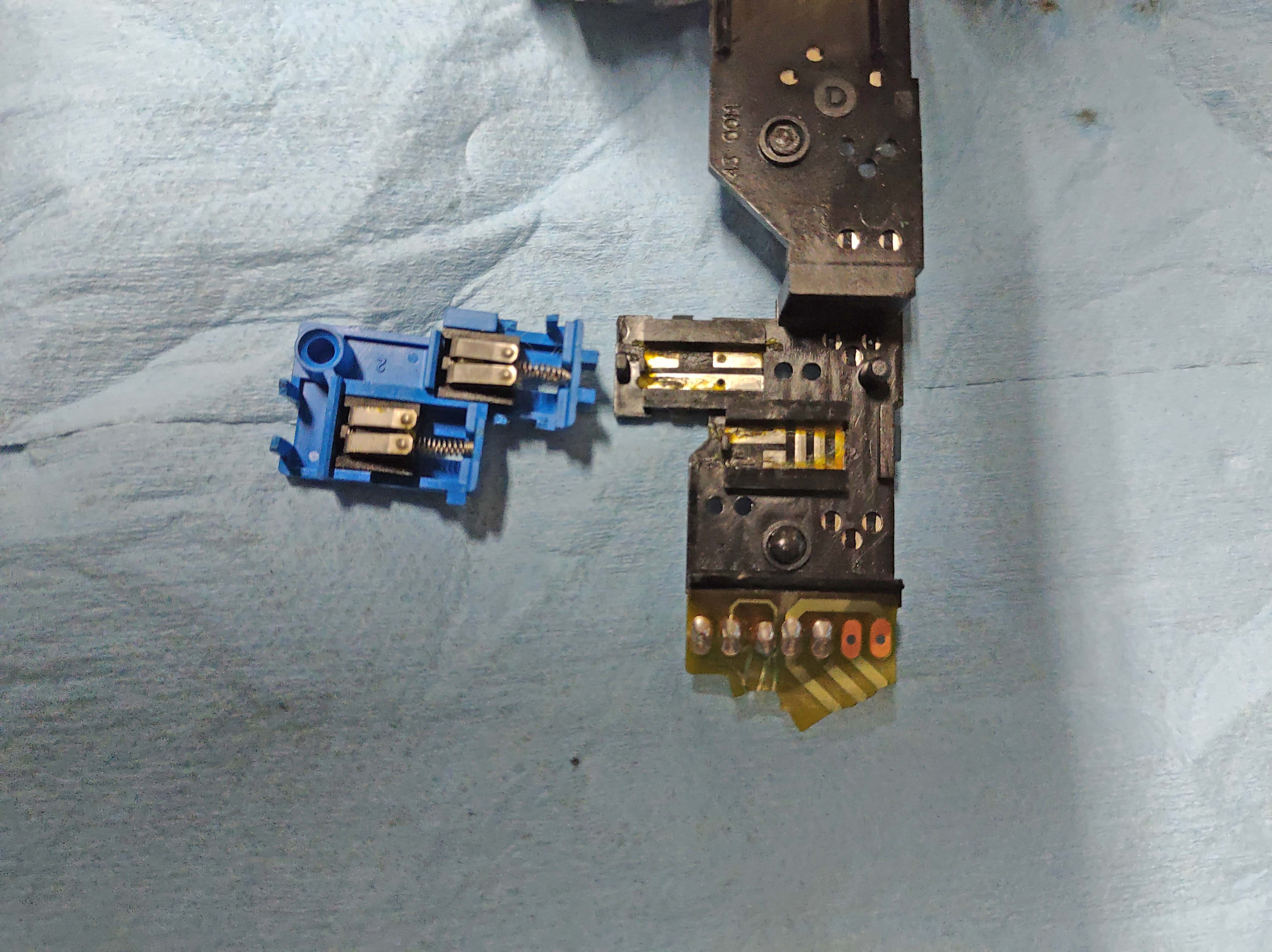

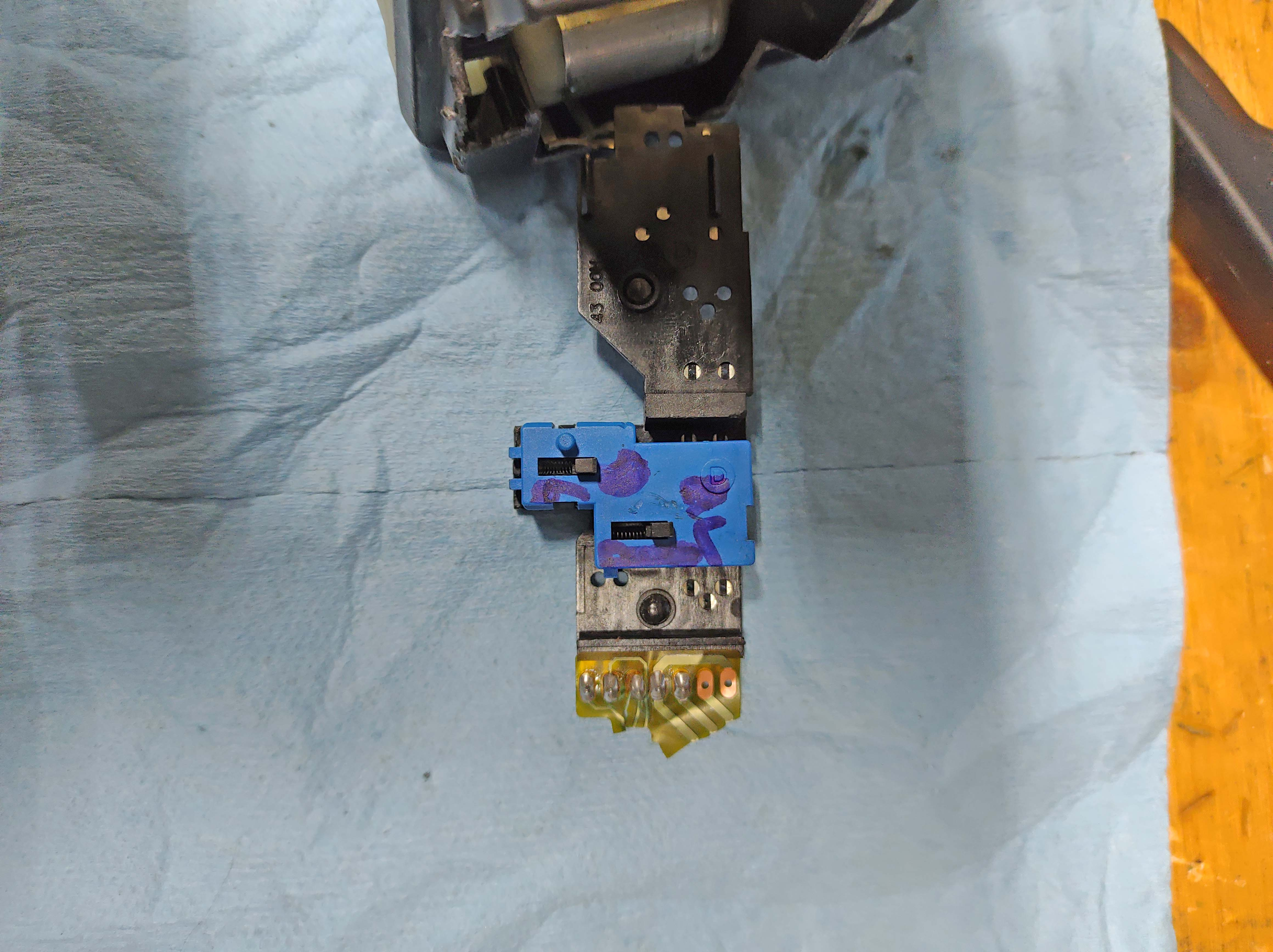

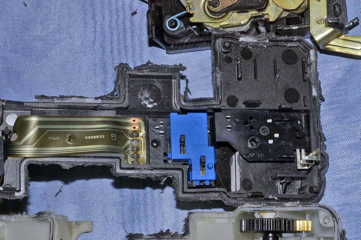

You're not going to be able to get to these switches with contact cleaner, they're inside the sealed housing. The pictures I've attached is after I've cut open the housing and removed the switches from the circuit board. I removed the switches from the circuit board and you can see how the contact fingers slide on strip traces to open or close the switch. It might be possible to drill holes through the housing in the exact location and depth to spray cleaning fluid into this area.ashleyg82v702001 wrote: ↑16 Jan 2021, 14:44 So perhaps some electrical contract cleaner may be the solutionI'll test and see
