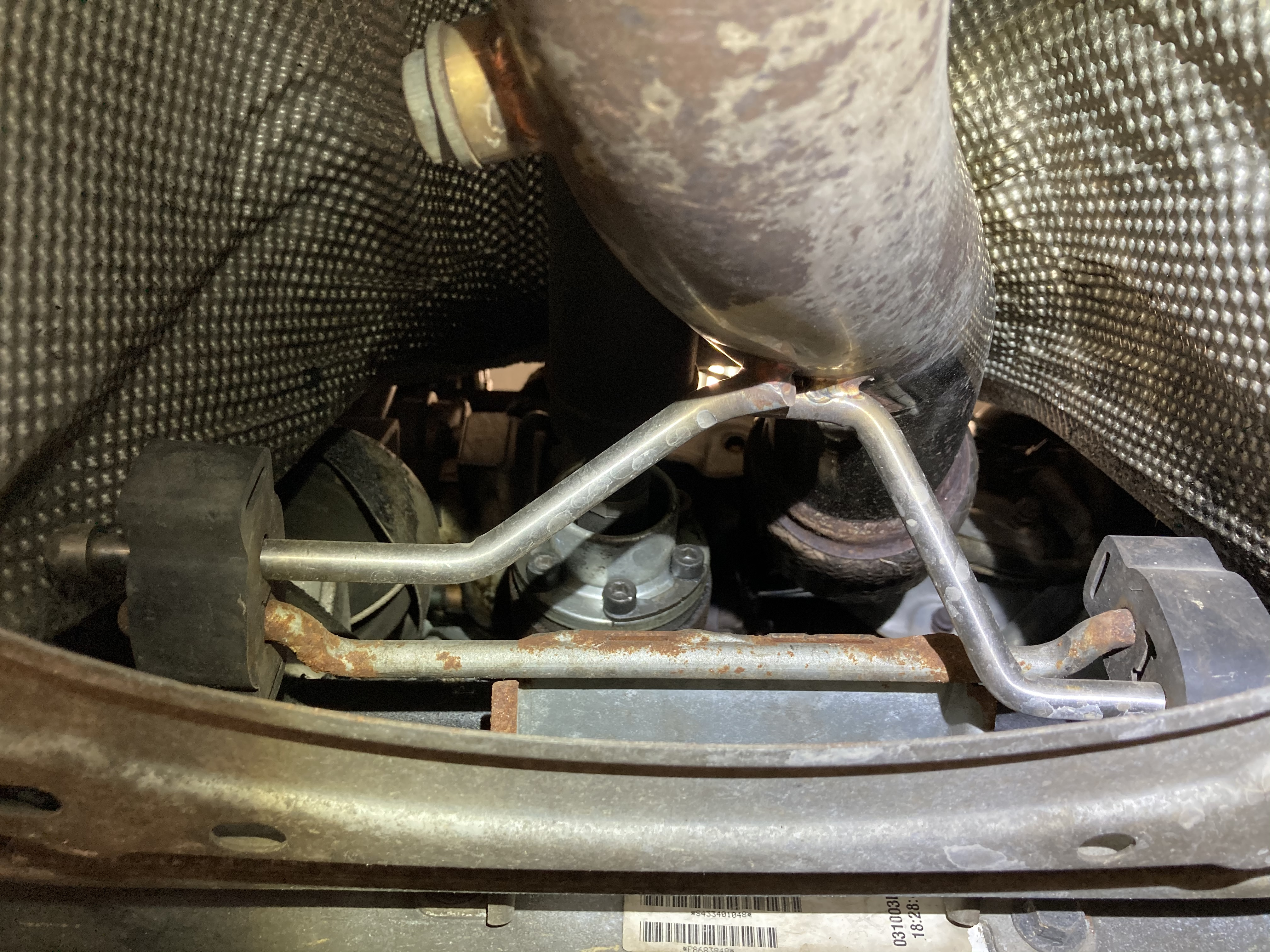

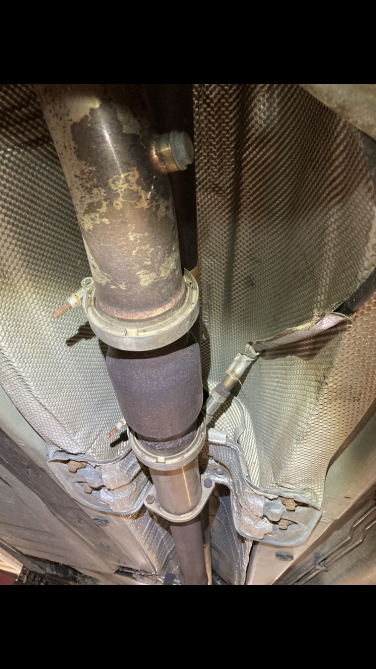

Here’s a recent photo of the Sunday grandpa with a hat on car (Dan, as my 5-year old calls it). This is the 3-piece, 3” Mototec DP. Notice the catted section is removable via V-ban connections. Also this DP has 2 O2 bungs for added monitoring. Notice you will need to use a defouler to spoof the downstream O2 sensor as well.
