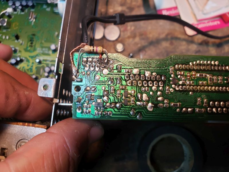

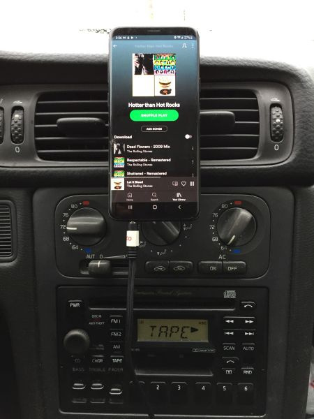

Partial success! It sounds awesome when playing music from my laptop, but when I connect my Android phone via it's headphone jack, the phone doesn't detect that anything is plugged in and keeps playing from it's internal speaker.
And my phone's headphone jack works fine with a pair of computer speakers or headphones.
From some quick googling I think I might need to add a resistor between one of the pins and ground. If anyone happens to have any clues, please let me know.
But progress!

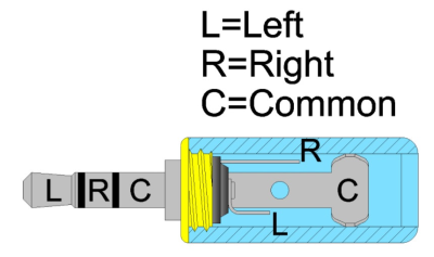

(Edited to add: I think I need to add a 16 to 32 ohm resistor between ground and right, which I'll do where my cable is soldered to the tape deck)
But progress!

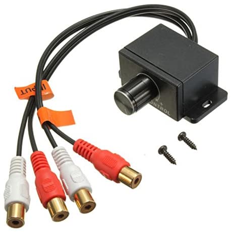

More progress: if I connect an inline volume controller my phone recognizes that something is plugged in and starts playing audio. Sounds great too. Whoo hoo!
I'm using this guy:
Interestingly it only works with the volume knob on full volume. If I turn it down at all it goes almost silent. And sometimes when I first plug it in I need to turn the volume down then up to get it to be recognized.
But getting there. And when it's working it sounds phenomenal. This is much more fun than listening to NPR or the same thriftshop CDs again.

Today was an excellent day in Volvoland for me. I tested the impedance between R and common of a few pairs of headphones, and all were 30 ohms, except one pair of "high impedance headphones", which were 50 ohms. The headphone jack that I added to my stereo only had 5 ohms though... I had a pack of 47 ohm resistors lying around so I soldered it between R and common on the PCB:
Now my Samsung phone detects the input! On the bench at least... Once I reinstalled the stereo and powered it on it wouldn't detect it again. I'm guessing it's interference from the tape deck, sure would be nice to completely remove the signal from that. Measuring the impedance I see it shoots to either an extremely high or low impedance, I'm not quite sure which. Either way it's outside the range that makes my phone happy.
The impedance goes back to 47 ohms when I turn the tape deck off (by powering off the head unit or simply changing to FM), and then if I connect my phone it detects the input. Which is a workaround I can live with, for awhile at least: connecting my phone before powering on the head unit. It seems to then continue to work well until I unplug it, meaning stopping playback or switching apps still works fine. That'll probably get old, but for now it's a small victory.
And I tested with an iPhone 7 and apparently this issue doesn't affect it, it works fine at all times, even if I connect it with the tape deck on, so maybe this issue only affects Android phones, or maybe just the Samsung S9+. I'll do some more testing as more phones come my way.
