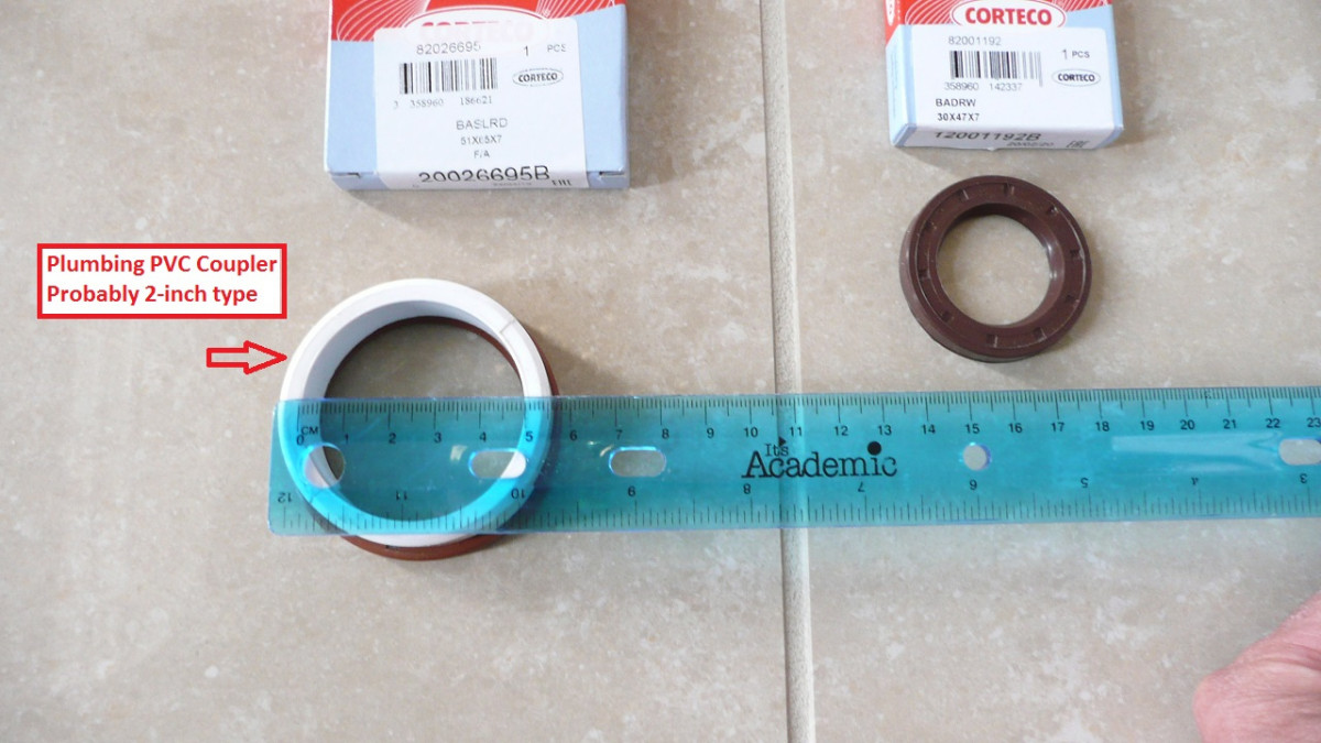

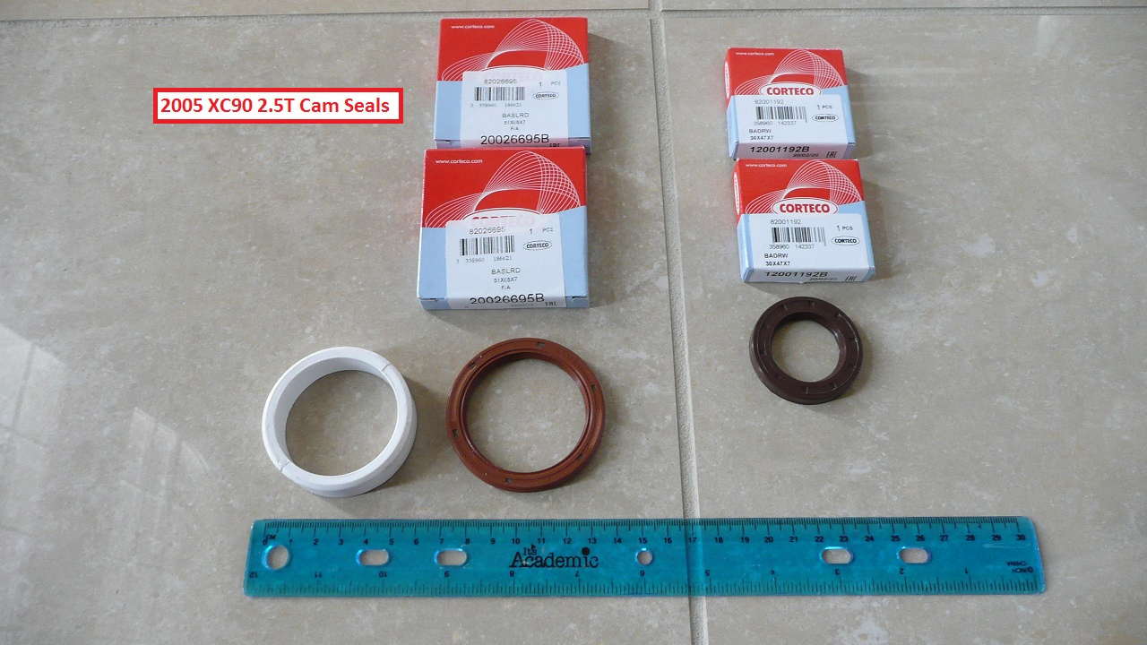

While I have done a few P80 cam seals (1998 S70 GLT, 1998 V70), I have NOT done the same seals on my 2005 XC90 2.5T with 122K miles yet.
Here are what I have gathered in terms of parts and tools, waiting for a good day to do it.
Well, the oil leak happened in cold weather Dec-Jan.
Somehow, it has slowed down now the weather is warming up, so I am NOT in a hurry to do it...
Attached are photos of the Cam Seals (Front and Rear).
Also shown is the "special tool" I made from Plumbing PVC Coupler.
BEST is to bring your front cam seal to hardware store and find the best fit, then cut the PVC Coupler down so it is only 1/2 inches in thickness (the space is tight in there). No room for a hammer so you have to be creative...In the P80: I used the sprocket to slowly drive the seal in (see the DIY above). In the P2, I have not figured out how to drive it in (yet)...
Please report back your tips/tricks, I want to learn...
