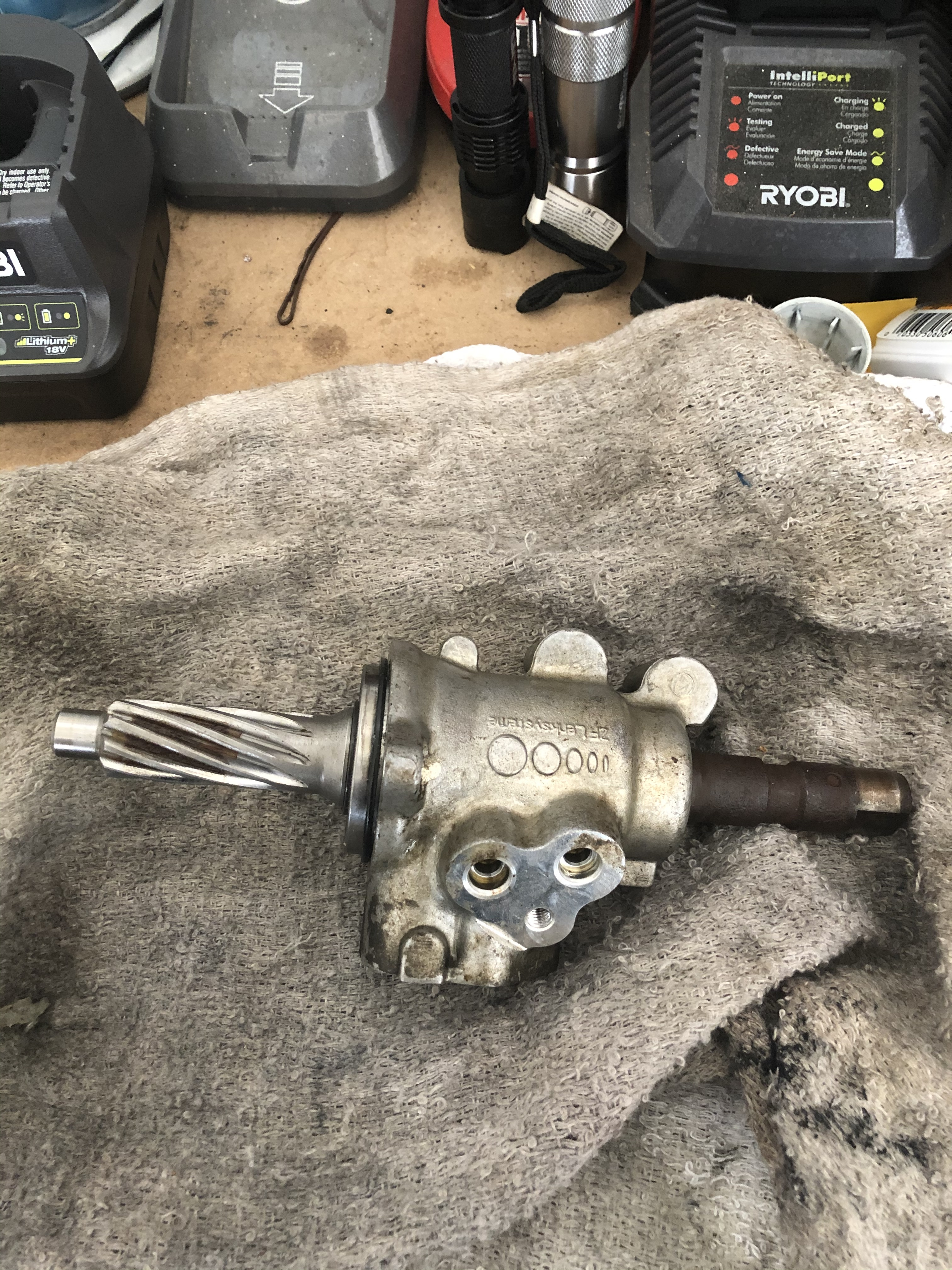

My rack leaks, only at the input shaft. Bellows are dry. I picked up a pinion cap and gear at the junk yard today off a ZF rack like mine just to see if it came apart and what’s it all about. I disconnected the fluid lines, the steering gear, two bolts and it slid right out. I’m thinking I can just swap that out after I get the seal replaced. I called the rack doctor and he said he can replace the seal and send it back. I know I can do the arm yoga, I’ve replaced the oil line seals and such. What am I not thinking of? Will the lower steering arm raise up enough through the firewall after disconnecting it from the rack and upper steering shaft to clear the top of the rack shaft? I know to lock my steering wheel and I’ll already have my wheels straight. I’ll be able to do it with the left side off the ground only, right tire will be straight and touching the floor. It can’t be this easy can it??? 😂

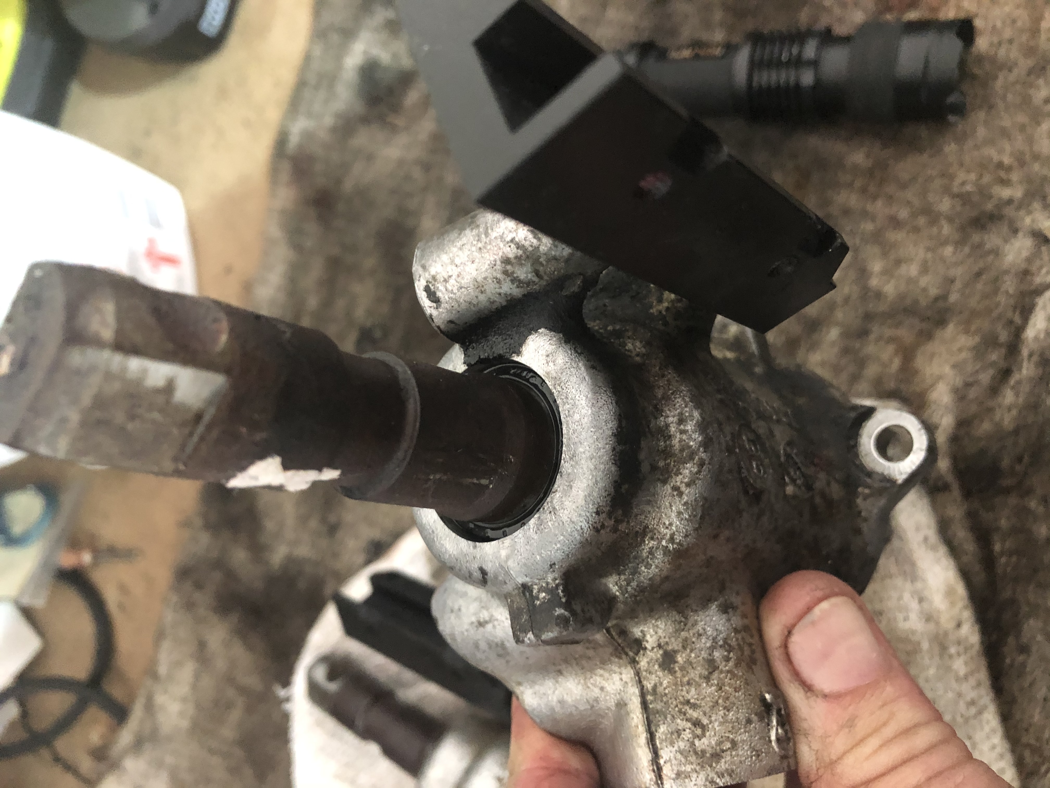

Thanks, I saw that video last night and I’m going to use that information. I did consider grease from the joint heating up and sliding down. What dispelled that was when I flushed and switched to Pentosin the leakage was green. The seals from the crossover lines and fluid lines are good and sealed. The fluid is coming from the top of the cap at the input shaft and runs down. I originally thought it was the crossover tube seals, but my wishful thinking was exactly that.
Playing with this junkyard cap assembly while cleaning it up the shaft moves up and down about 1/4”. Bearing at the bottom, bearing at the top under the top seal. When you slide it up the bottom bearing rests against the bottom seal and the top rests against the top seal respectively. When I say it moves, it’s more like it pops down and up. Anyway, I’m going to mark all the steering attachments and take it apart if it allows.

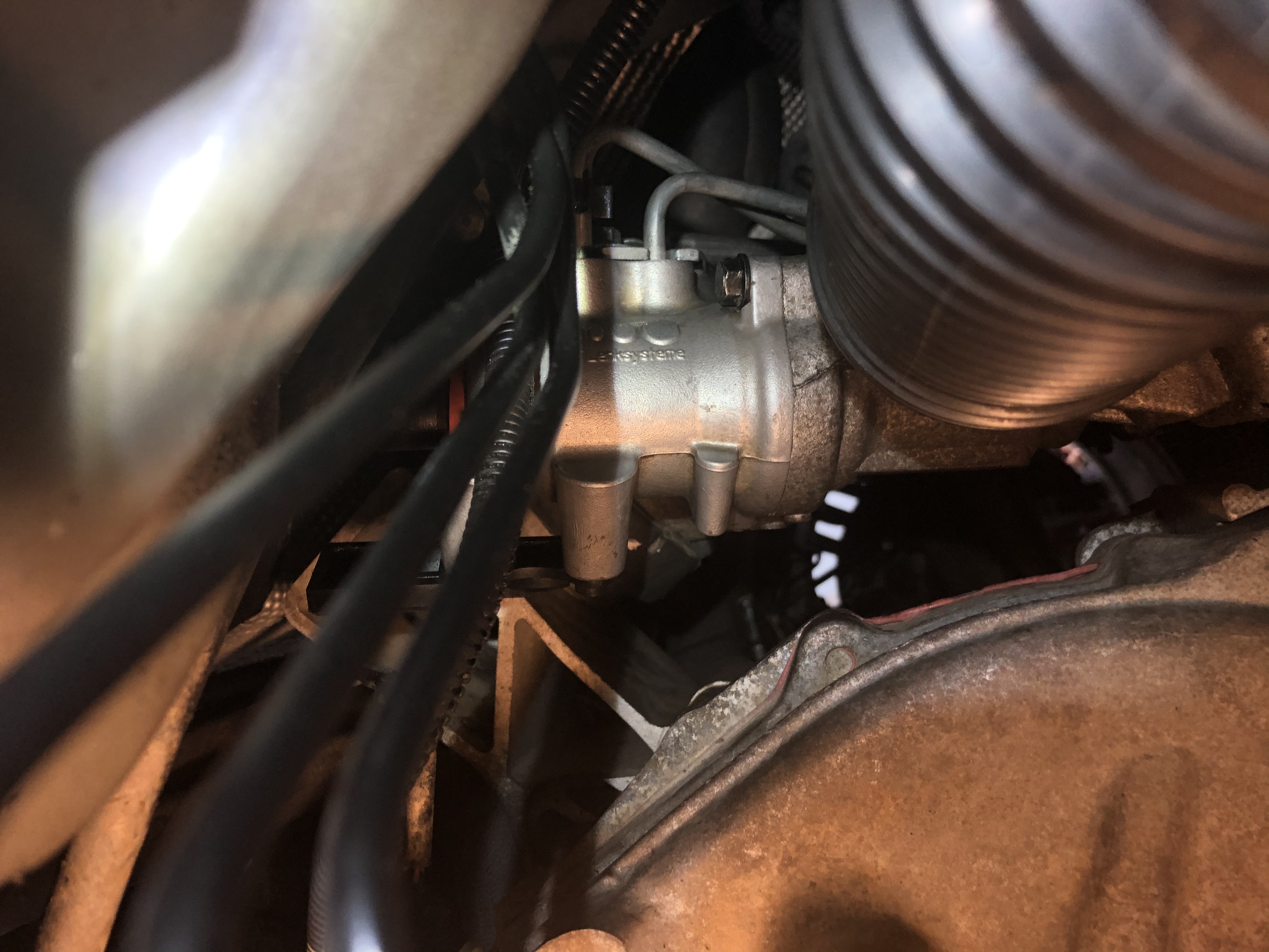

Well, I spent all day on it. Removal took about 2 hours of arm yoga. Not bad. I decided to install the pinion assembly I bought at the junk yard for $13 and change. It showed no signs of ever leaking and I figured it would be good to at least see if everything will go back together the way I imagined. Everything went back together fine. I took extra time making sure every movement I did did not change my wheel position. I buttoned everything up and filled the system with 202 b/c I had a ton of Lucas PS stop leak in it. I’m saving my 11s as I will flush again later. So at this point of running it, turning the wheels L-R to prime the rack I would have had fluid running down the side of the pinion cap. Right now, no leaks!! I’m still going to send my cap off and get the seal replaced just because. Anyway, I’m pretty stoked my crazy idea worked... at least for now. 😂

So about this task. If you happen to have a leak at your input shaft and everything else is good, this can be done in an afternoon without dropping your subframe. A couple things I did anticipating the install or having to go in again was to change out all the T30 screws to 10mm bolts. It makes it so much easier to deal with when your using swivels and your less likely to strip them. When I’m at a junk yard even if I don’t come away with any parts I always pick up any bolts, screws and clips laying around from someone else. The two pinion cap mounts and the rack crossover oil pipe securing plate are torx. When I got everything loose and detached from the pinion cap I pulled it out through the firewall by the lower steering coupling which was still attached. I put it back in that way as well. It’s easier to deal with the coupling connection with it all out of the car. After I disconnected that, I cleaned it up real good making sure it slid on without coaxing all the way to the bolt passage. You do not want to fight that on the car. I made marks on my right tire, the floor and all the connection places. When I slid the other pinion cap in I did so referencing my marks from before. It will slide into the rack gear but so far. At that point I moved my left rotor back and forth a little to see if it moved with it. The pinion cap assembly will not slide into position by pushing it because the bearing needs to be coaxed into the seat in the base. I put the two securing bolts in and tightened them 3-4 treads each at a time. That guides the bearing into the seat, once seated tighten them fully and its done. Reinstall everything else and fill your system. There is ALOT of what I call arm yoga. You’re going to be putting your arms through the left wheel well, below behind the sub frame and in front by the transmission and a combination of them.

Got your other PM, let me know if you decide to try one from a pick a part. But basically, I made white marks on anything and everything to make sure nothing moved out of place when I finished installing the pinion as there was no procedure to be found on what I was attempting. I figured that they had to take those things apart to rebuild them, so it has to come apart somehow, go back together and still work. That’s why I went to the junk yard first. I found one with the subframe already dropped so I disconnected the linkage, unscrewed the two pinion cap screws and the cap/gear assembly just slid right out of the rack.
