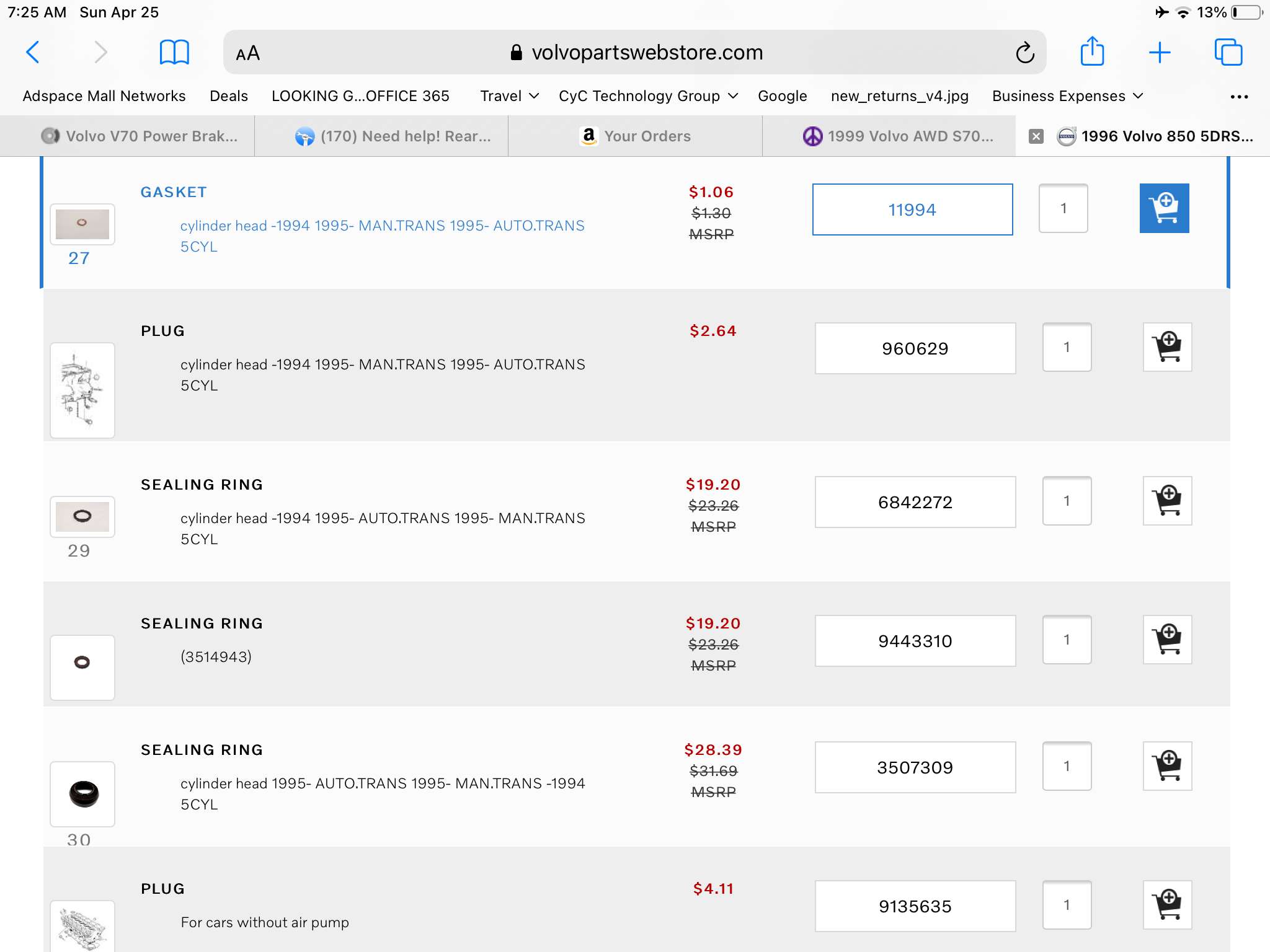

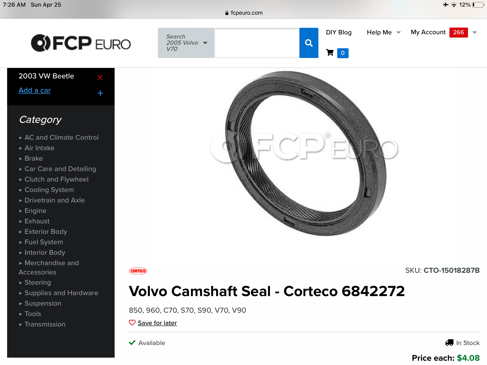

Dan, you want to use either OEM or Corteco seals on these cars.
I use the Volvo web store website to specify OEM part numbers, then buy them from FCP , Tasha, or volvo parts lisle in that order.
If we source the right part number I probably have a spare I can pop in US Mail
Here’s how I found it...volvo is $20, Corteco $4

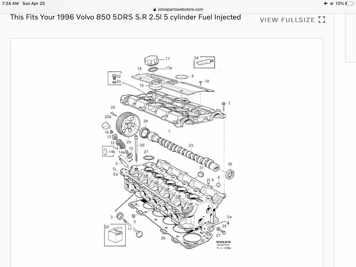

Absolutely, intake and exhaust cams both have rear seals, that's a key point not just a technical one.
For the rear seal on the intake cam you do need to remove the distributor cap, the rotor and the mounting plate for the rotor.
For the rear seal on the exhaust cam you remove the CPS and a similar metal plate mounted to the end of the camshaft.
Be sure to put the plates back on in the correct orientation, it is possible to put them on wrong.
