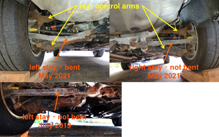

Well, "you can see a lot by looking". The left rear suspension control arm stay (not the control arm itself) is significantly bent as in the photo. FCP sells a simple-looking and inexpensive oem replacement kit for this including two ProPartsSweden stays, new eccentric screws, eccentric washers, lock nuts, suspension strut bolts and parking brake cable clips. Genuine Volvo stays are 2x more expensive.
Perhaps caused by using these stays as tie downs for towing (as suggested in the fcp reviews of the genuine volvo kit)?
The plan would be alignment after replacing both stays. I will examine everything with the rear of the car on jack stands and rear wheels off before embarking on the replacement. Should I be looking for some more serious issue that caused or resulted from this bent stay? Ball joints?
Both rear tires show uneven wear much worse on the inner treads.
