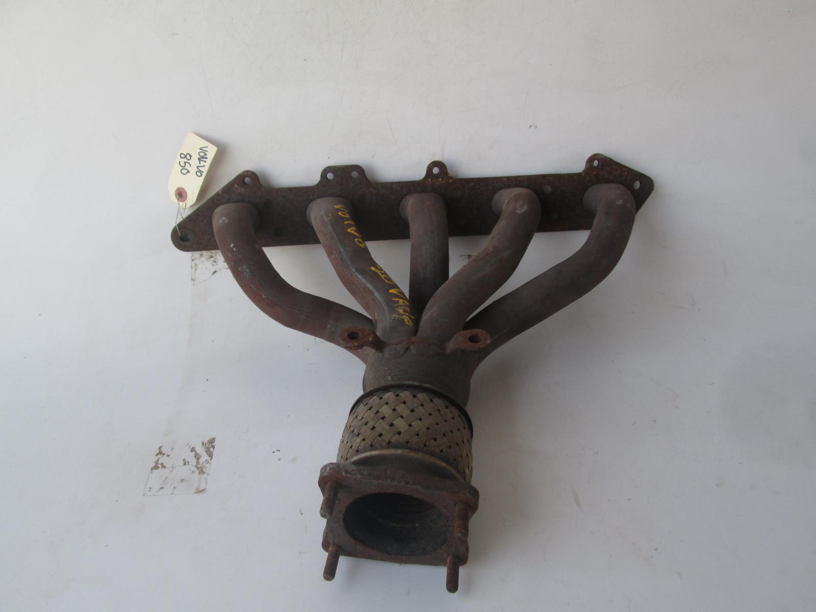

Wondering if this may come from the flex hose section in the manifold, which I believe is designed for some flexibility, but surely not for the engine moving up and down by up to two inches. Ran into this possibility here:

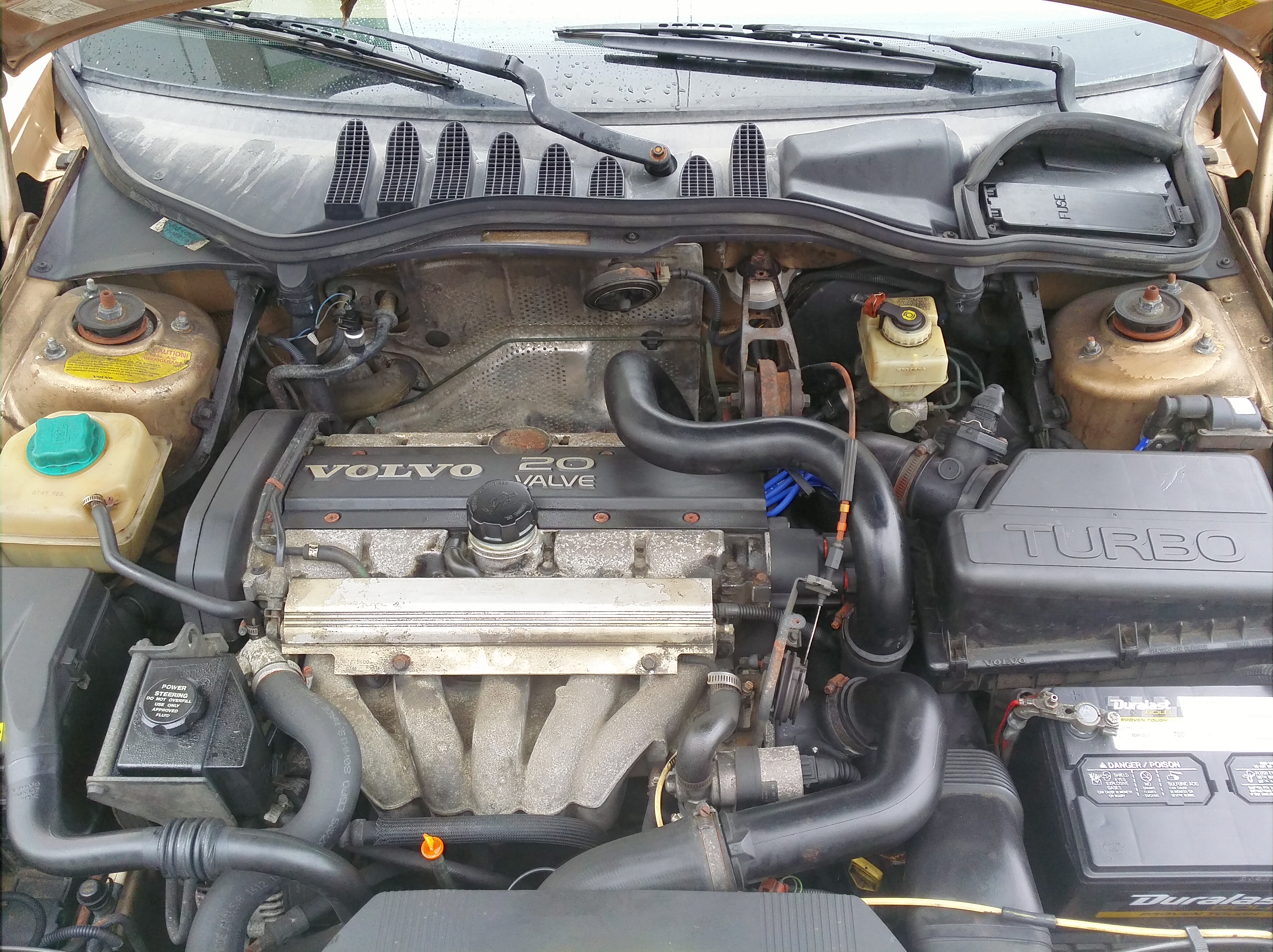

Copy on the turbo not having a flex pipe on the manifold, yet, my car does not appear to have an airpump per the linked picture at viewtopic.php?t=69273 - no intake pipe, no SAS valve. See attached pic I just took of my car/engine.

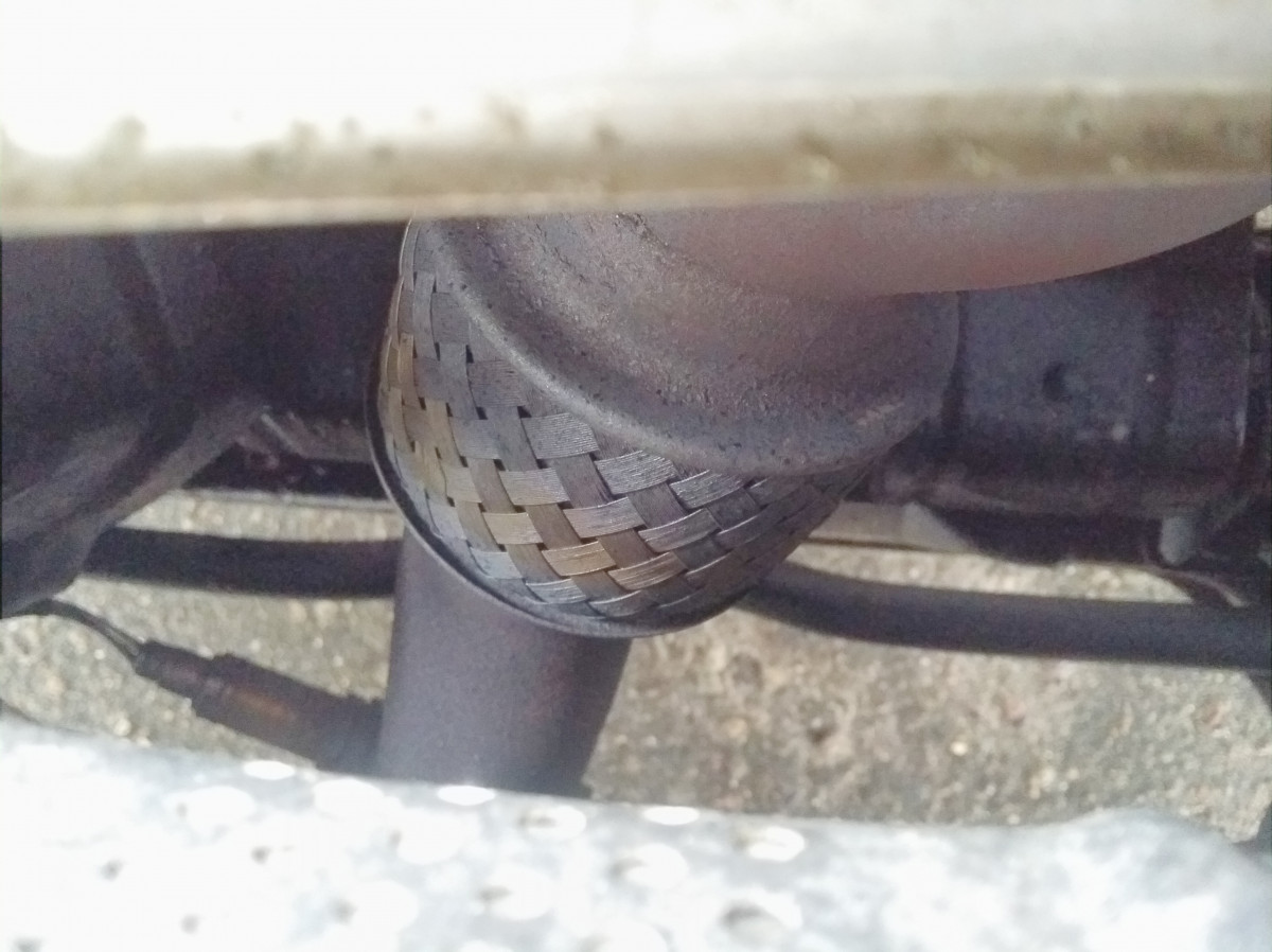

The 'aspirating' sound appears to come from a low point. The flex section I was thinking of is this one: https://kyozoufs.blob.core.windows.net/ ... 454942.jpg, see also pic I just took of it in my car.

Hmm, that's strange. This seems to correlate exactly with when the SAS would run... and I think EGR was only for NAs, so you probably don't have that either.
That exhaust manifold picture is from an NA, not a turbo. The flex section you have is on the downpipe. It looks similar to that, just on the pipe rather than the manifold. You can remove the heat shield over the turbo and give it a look.

NA = naturally aspirated (non-turbo). The picture you posted is the downpipe, not the exhaust manifold. The one on the bottom is the stock downpipe, and you can see the flexible section towards the front.
