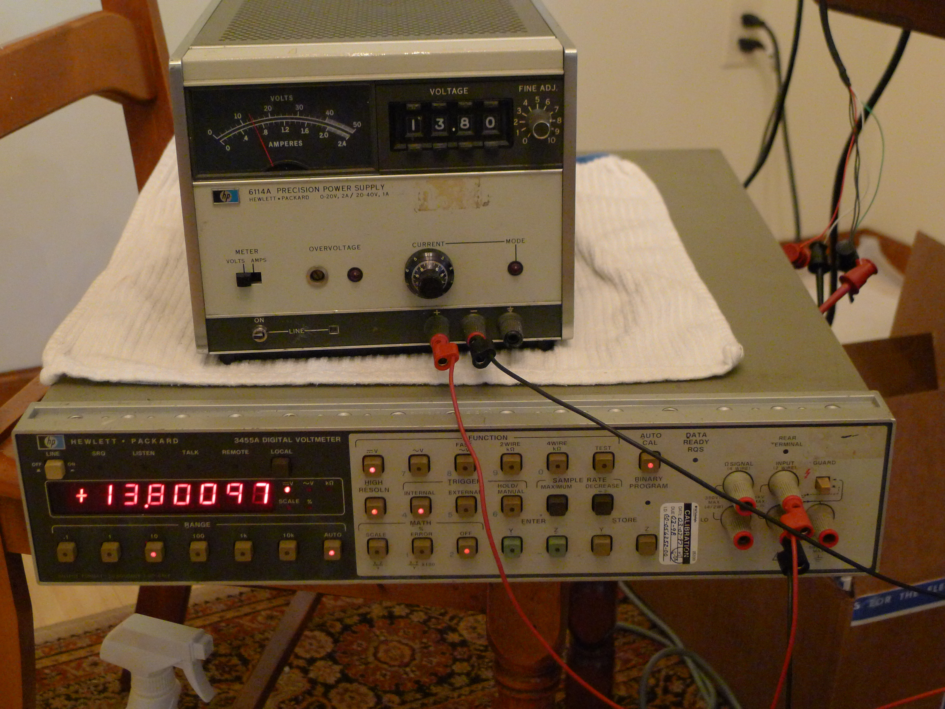

I'm currently charging a spare security system battery using my HP 6114a precision power supply and checking the voltage with my HP 3455a digital voltmeter. The power supply is set at 13.806 volts and the 3455a is reading 13.80079 volts from the battery. Yes my inexpensive Craftsman vom would read 13.8 volts, but I like seeing all those digits.
